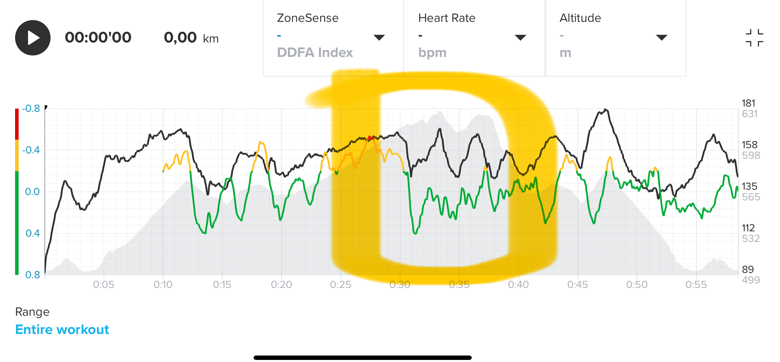

                          I still get some hard to justify measurements
                          Eg today on a trail run , going uphill , HR exceeded 180bpm for over 2minutes and zonesense was still on the green part
                          ? 1 Reply Last reply Reply Quote 3
                            A Former User @thanasis
                            @thanasis this happened to me just now. My HR was 176, Zonesense shows a huge drop. Not sure how to read that.
                              Brad_Olwin Moderator @Guest
                              @timecode ZS needs minutes to adjust. What you saw is normal. Your HR dropped a lot before it rapidly elevated at the end of your graph. ZS appropriately dropped then started rising. You were not long enough at a high HR! This has been stated many, many times here.
                                A Former User
                                This keeps happening when using Zonesense a lot. I am able to see data on my watch during an activity, but in the app the graph looks like this. HR strap is connected, HR data is there. Any idea why this is happening?
                                Brad_OlwinB SamuelPS 2 Replies Last reply Reply Quote 1
                                  @timecode Is this true for all exercises? Do you have old ones with a strap prior to ZS release? Those will show ZS as well.
                                    A Former User @Brad_Olwin
                                    @Brad_Olwin it’s not every exercise, sometimes it’s like this - there’s a chunk missing at the end of the excercise or some drops:
                                    Today I was checking Zonesense quite often on my watch during the excercise and I saw data. It’s just missing in the app.
                                    brechtvbB Brad_OlwinB 2 Replies Last reply Reply Quote 0

                                      @timecode sometimes I have the impression by opening the big graph or swapping the data in the display for other measurements, more data (complete) pops up, odd, and a bug in the end.
                                      • SamuelPS Offline
                                        SamuelP Bronze Member @Guest
                                        @timecode it happened me the first time a few weeks ago. I didnt wet the belt before my run. I guess the connection was good enough for HR but not the r-r data. After a while probably my sweat made the connection better or something?

                                          isazi Moderator @SamuelP
                                          @SamuelP indeed, if the data is too noisy it is not used for ZoneSense, data needs to be quite clean to be used.
