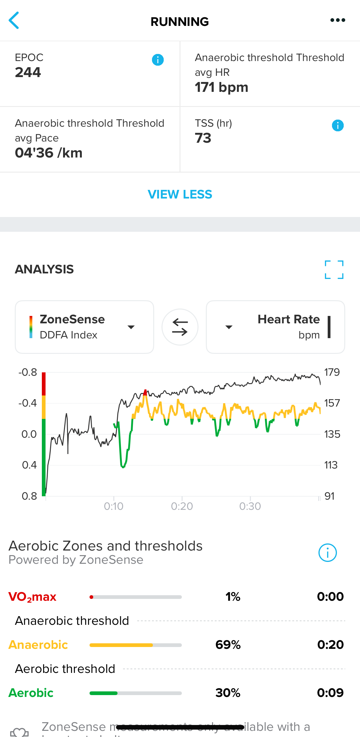

          2b2bff @Inge Nallsson
          @Brad_Olwin if the number is predicted for THAT workout - and it keeps consitent throughout the workout, so why have I been below LT1 most of the time according to ZoneSense and at the same time I have been in Zone 3 - above LT1 - according to the HR measurement. Even though the ZoneSense LT1 is below what I configured as the starting HR of my Zone 3?
          That was the whole point of my question…
          @Inge-Nallsson I honestly don’t know. Possibly Suunto should take out that screen that you get when touching (i) alltogether. The two graphs make sense to me. That other screen left me clueless…

              2b2bff @Brad_Olwin
              @Brad_Olwin please forget your enthusiasm about ZoneSense for a second and don’t try to convince me that is the best invention since sliced bread. I already know that 😉
              Please take a look again on the data I provided. Just look at the numbers:
              • ZoneSense gave me this in the workout: LT1 at 148 bpm and 56 minutes green - aka below LT1 - and 7 minutes yellow.
              • Looking just at the HR for the very same workout: LT1 was set to 152 bpm and I have been 33 minutes below that and 40 minutes above it.
              How can I be 40 minutes above 152bpm and at same time be only 7 minutes above 148bpm? That is what I’m trying to understand.

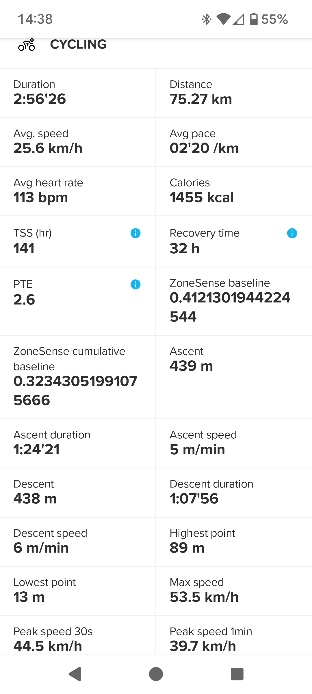

                              Strange readings on last bike ride! Zonesense baseline. It is this something new? I certainly can’t remember seeing it before.

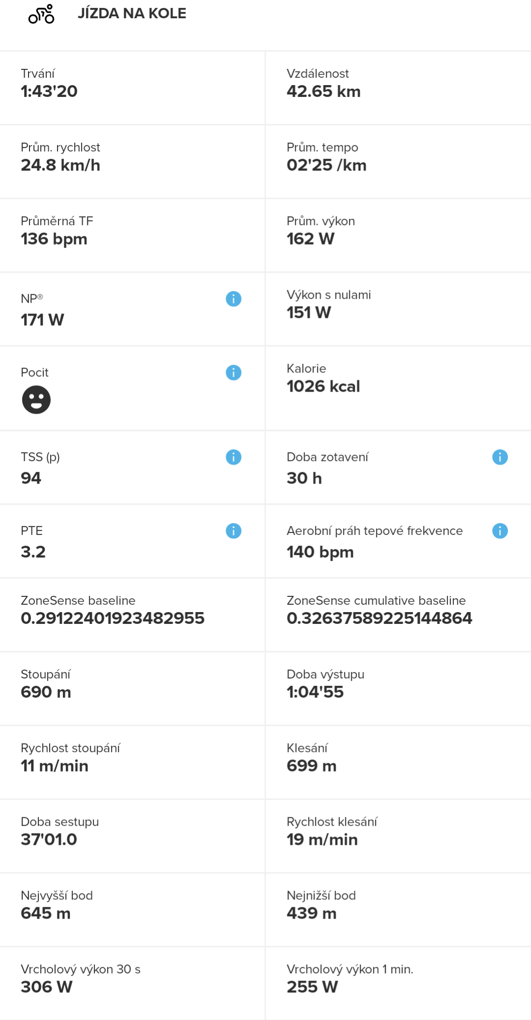

                                Jan Suchánek @Audaxjoe
                                @Audaxjoe also got that yesterday on bike:
                                  Squirrel Bronze Member @Audaxjoe
                                  @Audaxjoe said in ZoneSense:
                                  Already mentioned in https://forum.suunto.com/post/169982
                                  It’s unintended and will be fixed in next app release.
