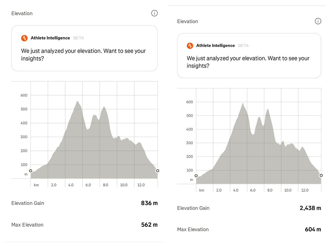

                maszop Bronze Member @Inge Nallsson
                @Inge-Nallsson Let me put it this way, I would rather have these 100m extra in Garmin than the current +1000m in Suunto.
                Suunto measurements R and Strava data L:
                alt text
                G C I 3 Replies Last reply 28 Jan 2025, 11:34 Reply Quote 2

                    maszop Bronze Member @GiPFELKiND
                    @GiPFELKiND Usually there are a few hundred meters extra, sometimes over 1000, but there is also such madness as in that example. I am talking about approaches in very strong winds, of course.
                    In stable weather everything works perfectly.

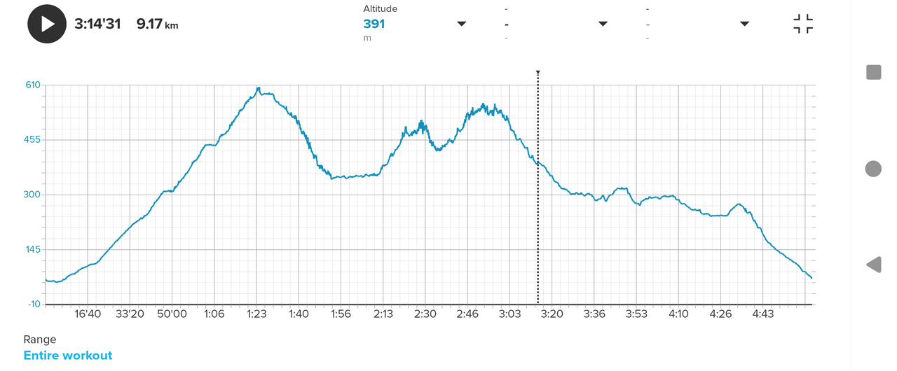

                        maszop Bronze Member @cosme.costa
                        @cosme-costa The Suunto graph:
                        alt text
                        https://i.postimg.cc/qMhcJDDr/Screenshot-20250128-114024.png
                        B 1 Reply Last reply 28 Jan 2025, 15:37 Reply Quote 0

                            Inge Nallsson @maszop
                            @maszop said in Watch unusable in wind:
                            The +100 metres were on top of the normal Asc/Desc of ca 160 metres, so not an insignificant error.

                                  Brad_Olwin Moderator @maszop
                                  alt text
                                  The spikes are clearly the issue. I do believe you and it is apparent but…. I rarely, rarely see this with any of my watches. Can you contact me by PM? I am going to going to ask the test group. I think this issue is not common, at least for me. I may ask to collect some files.
