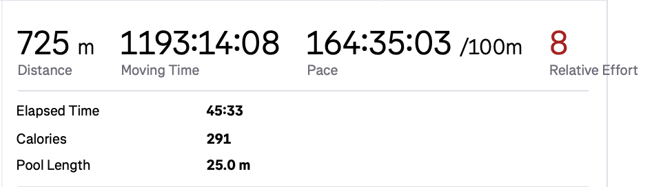

      I got a really strange bug this morning: one of the swim interval was reported with a duration of 1193 hours :
      5b38b7ac-226c-4a6b-8492-42d19a66c74f-telegram-cloud-photo-size-4-5888922749123020126-y.jpg

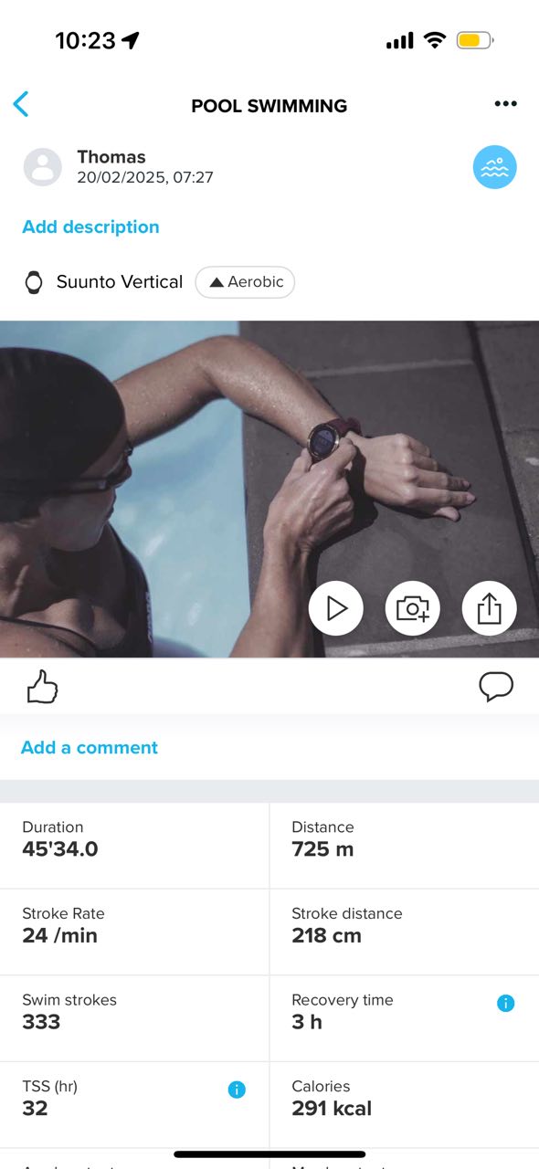

      The total duration of the activity is ok:
      6d3046e5-340e-4368-b8c3-c41ebd14190a-telegram-cloud-photo-size-4-5888922749123020127-y.jpg
      Strava uses the sum of intervals for the moving time, which gives a pool sessions of 50 days… fc6ffb76-ad48-40d2-86cb-4b80fa524cc3-image.png

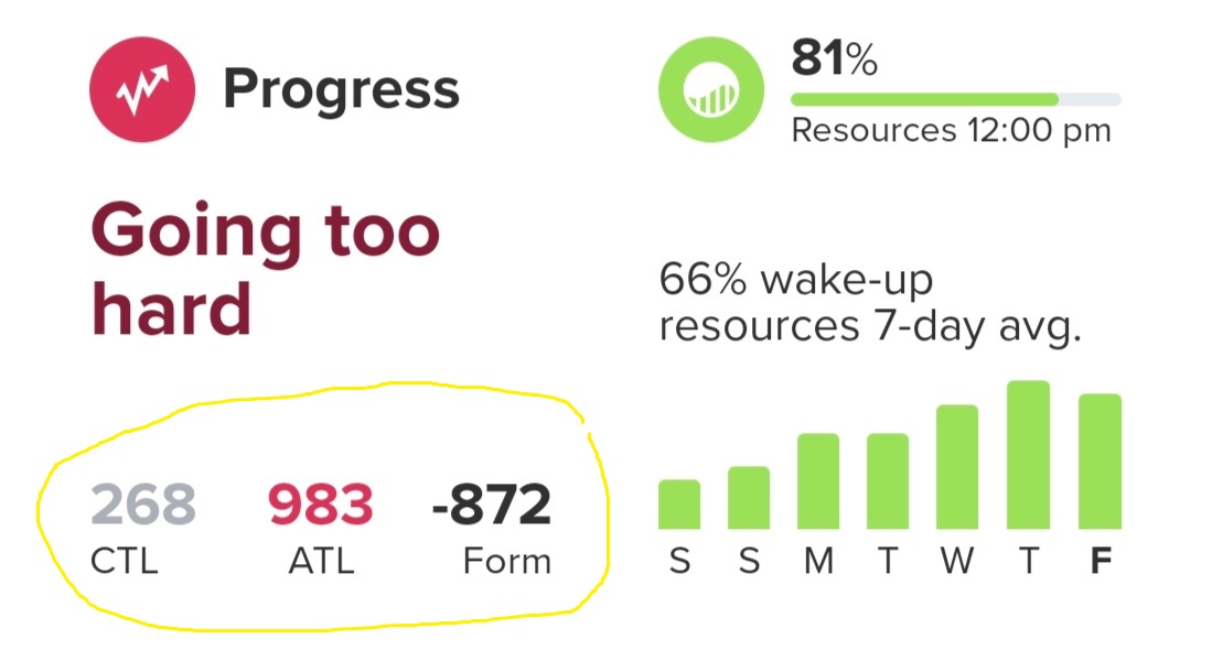

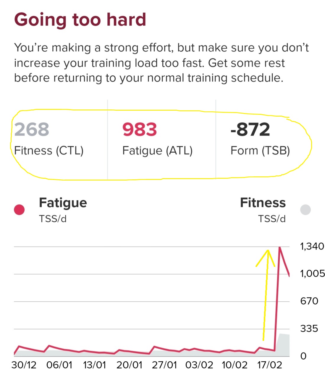

        2 days ago swim then my CTL ATL Form become extremely high. Just about 1 hour swim with Zone 1 heart rate. Before i swim my CTL is only about 70.
        Besides that, few breaststroke swim recorded as 0 meter distance after i swim multiple 50 meters distance.

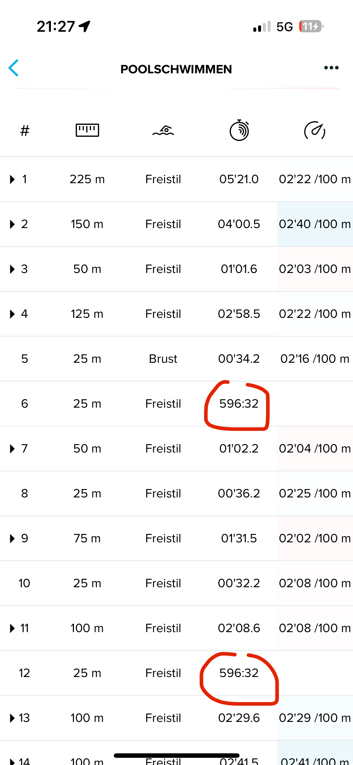

              Strangely, already in the Suunto app in my activity details there seems to be always one or more random 25m lengths completely off, always at 596hrs for one 25m distance. I guess that is also the case with you, @tuxella, right?
              Btw, I don’t have a Vertical but a Race S. Seems to be a clear Suunto Firmware software issue then. And not a Strava issue… Suunto Team, please fix this!

                      Hi - I am a Race S user and sadly have to join this thread. Had no issues with swimming data since I bought the watch in August ‘24. But now my last two swims have some crazy data errors (569 hrs for a
                      25m breaststroke lap). Anyone knows if this is fixed by the latest update?
