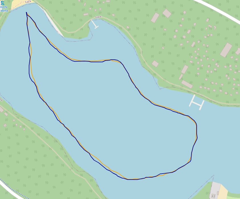

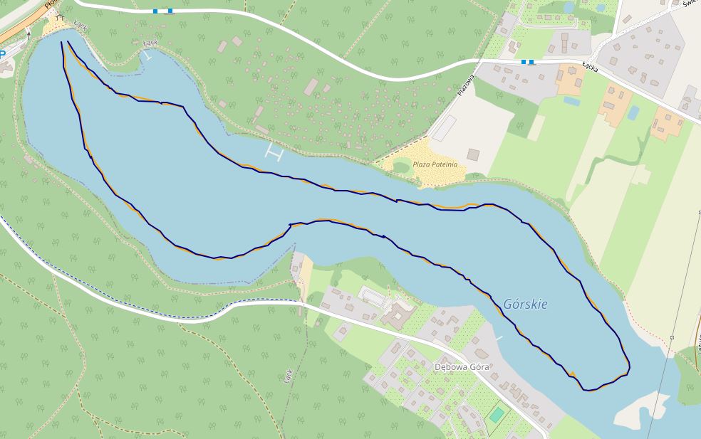

                  Hi,
                  Can you share GPS tracks from your last swim?
                  There shouldn’t be such differences!
                  I have Suunto Vertival and recently I swam with friends:
                  1. First swim OWS 1.3 km - SV1 watch + SV2 watch, difference in measurement about 30 meters.
                  2. Second swim OWS 3.1 km - SV1 watch + SV2 watch + Garmin 955 F watch, difference in measurement about 40 meters.
                  Software: 2.40.44
