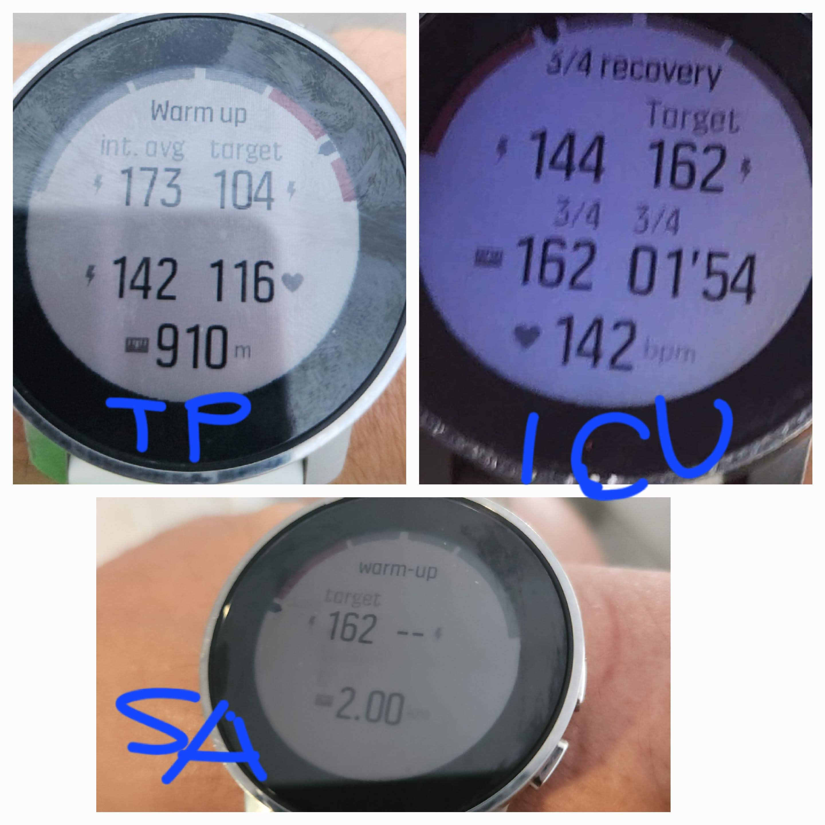

      New Race S user coming from Garmin FR965 and using a TrainingPeaks plan. I have managed to create a custom run mode and modified the layout of the screen. This all works OK for me. I especially like the clean user interface.
      But a structured workout adds an additional “interval” (?) screen which it seems I cannot modify. The manual seems to say that I should be able to add a screen from the interval group to my custom sports mode and that should be used. But if I do that, I still get the interval screen with 7 fields regardless of what I select.
      Any suggestions?

        @matram the planned training from TP is attached as a Guide I guess? The screen within the guide can only be customized by TP…

          You are correct the training is attached as a guide. A pity it cannot be configured. But thank you for your response.

            The custom screen provided by the guide is, internally, very flexible with loads of configuration options. However, control of what the screen looks like comes from the config data TP pushes to your watch so it would be TP you’d want to talk to if you had ideas for improvements or requests for configurability 🙂

              It’d be great to be able to customize structured workout screens, having said that, in my opinion TP has the best layout of out them all.
              Highlight, it shows Int. Avg vs target at the top and my favorite remaining distancie or time in current step at the bottom, where you can easily spot while surviving the workout 😉
