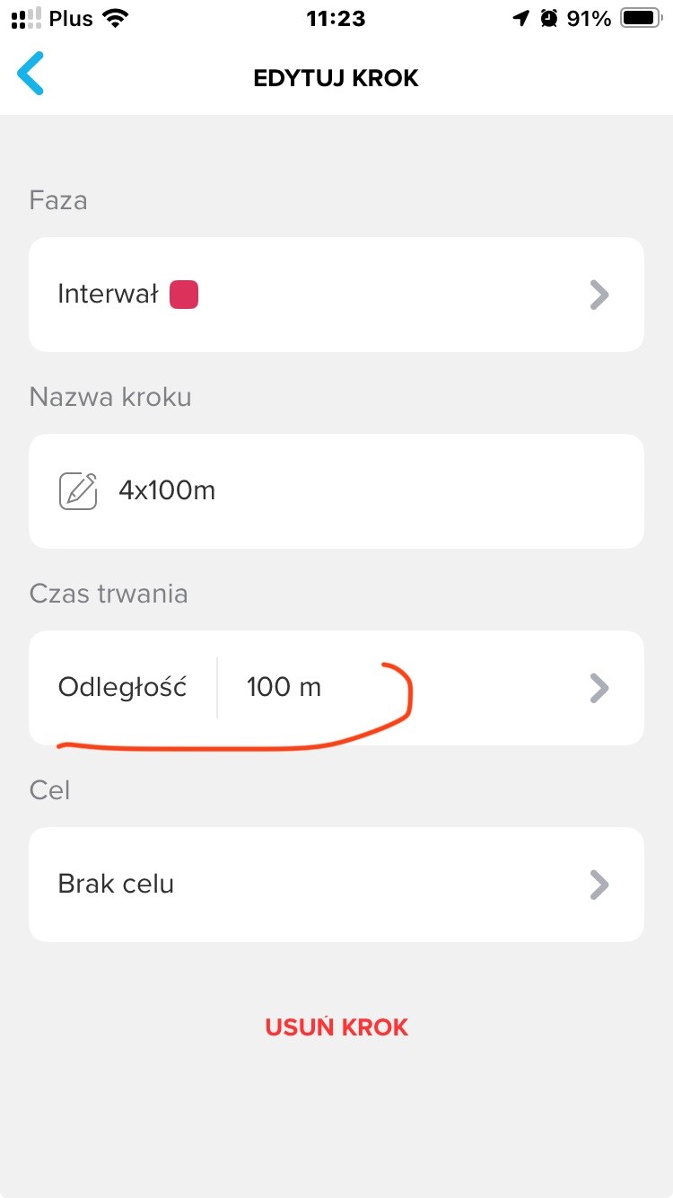

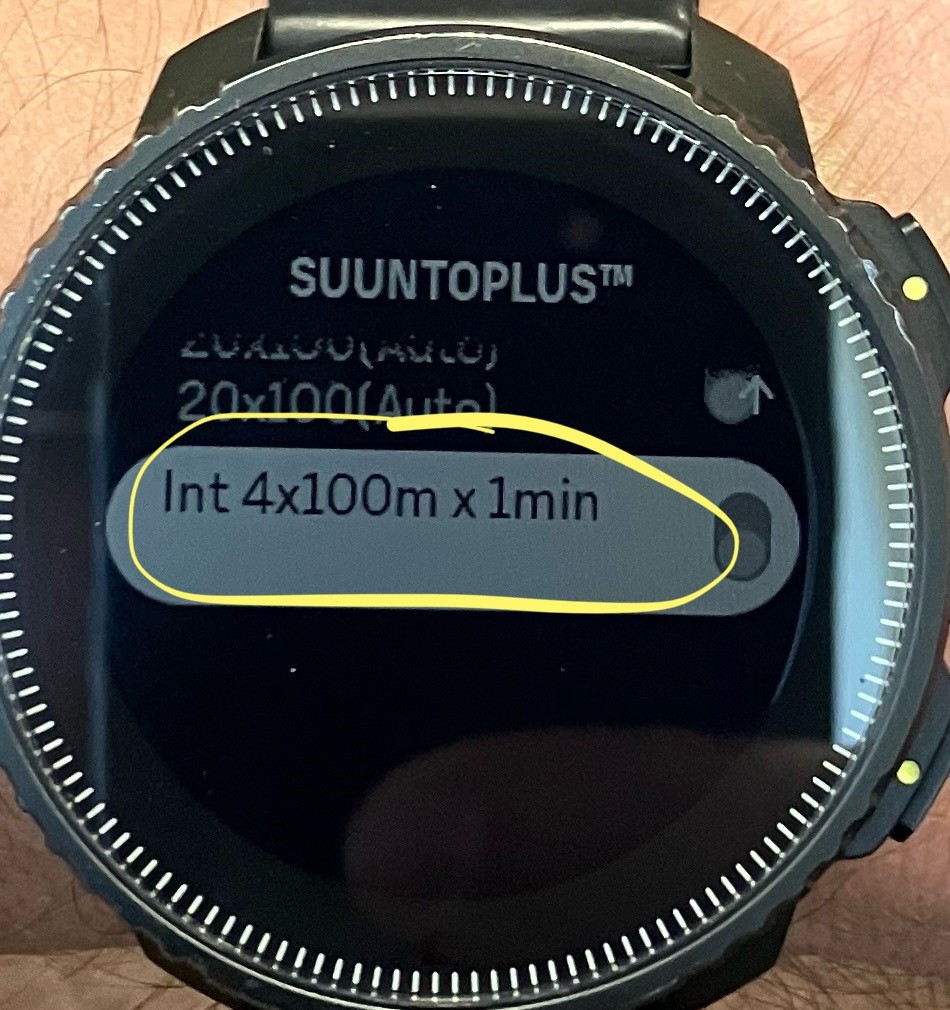

            Yes, use “non specific sport activity” and everything will be ok.
            You can set automatic distance of 100m or initiate end of 100m with button.
            Pause time can also be selected automatically or set interesting time (for example: 1 min)
            Example attached.

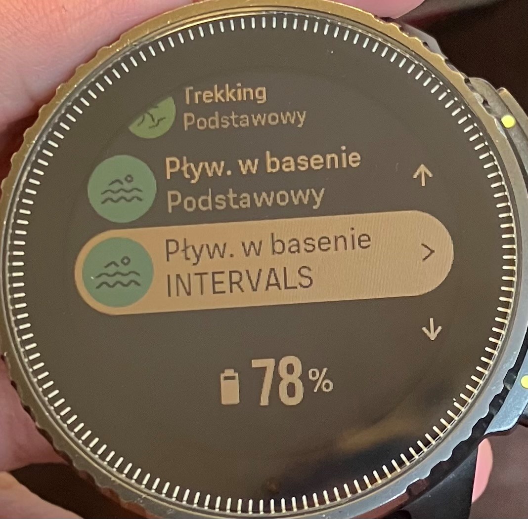

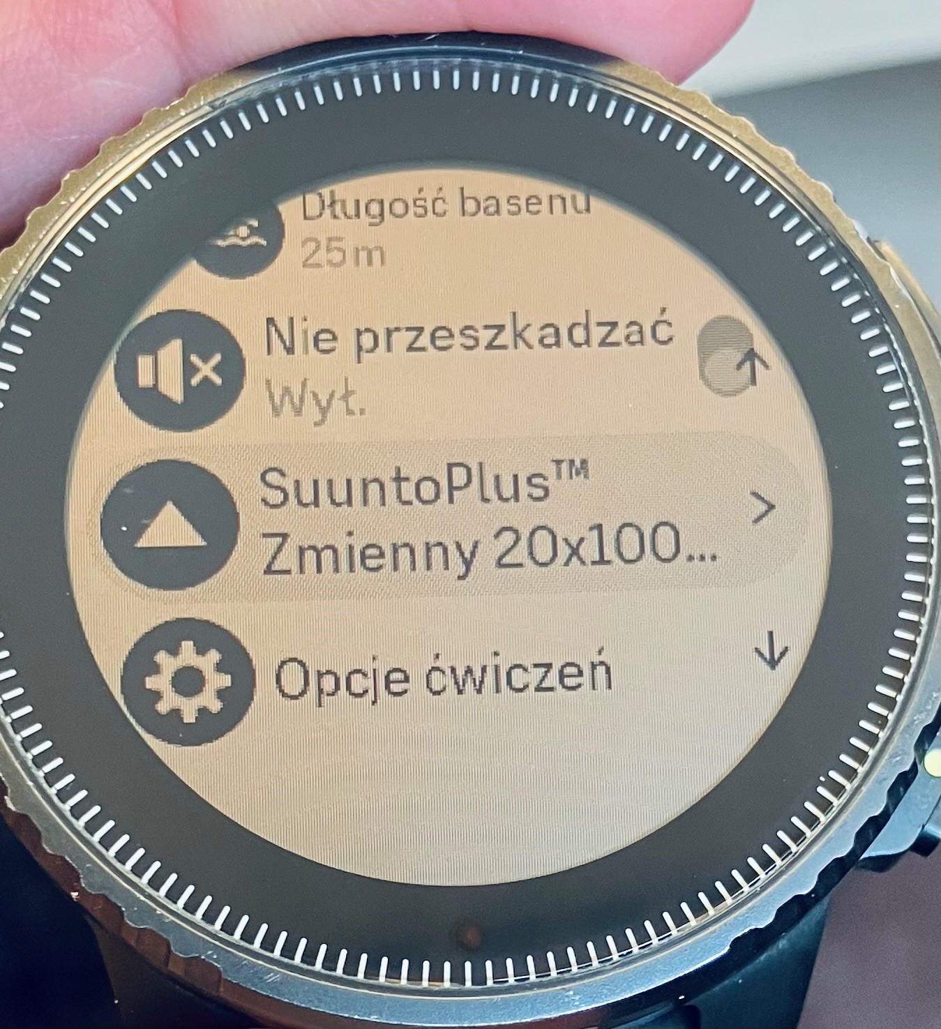

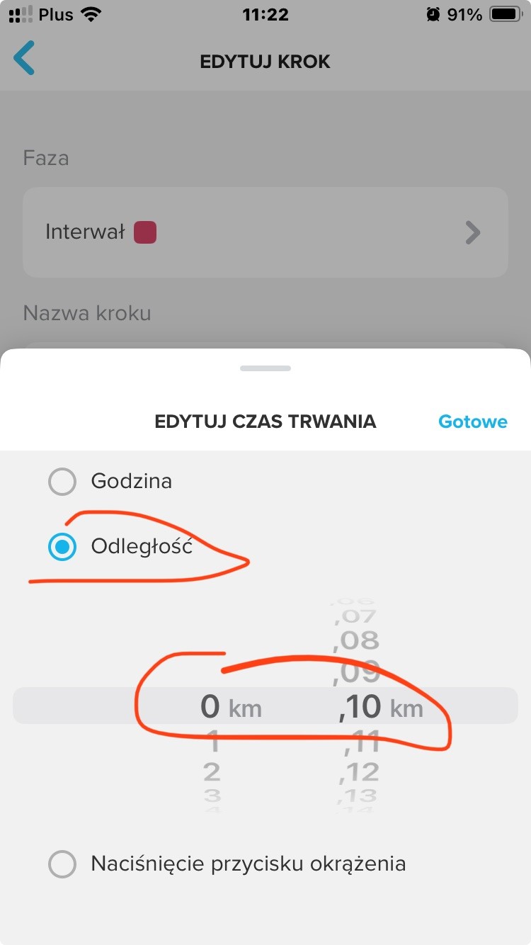

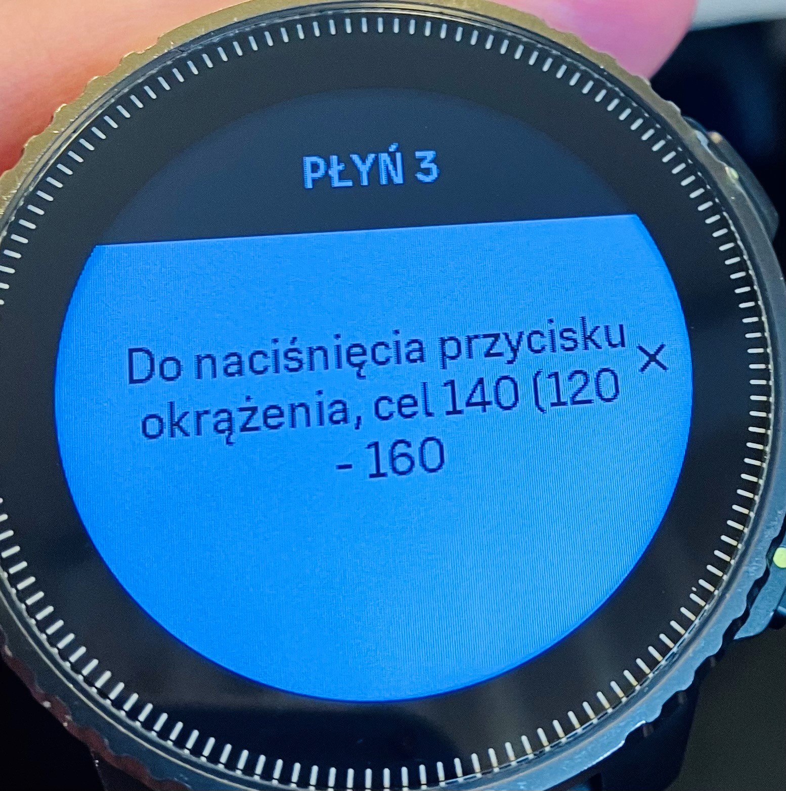

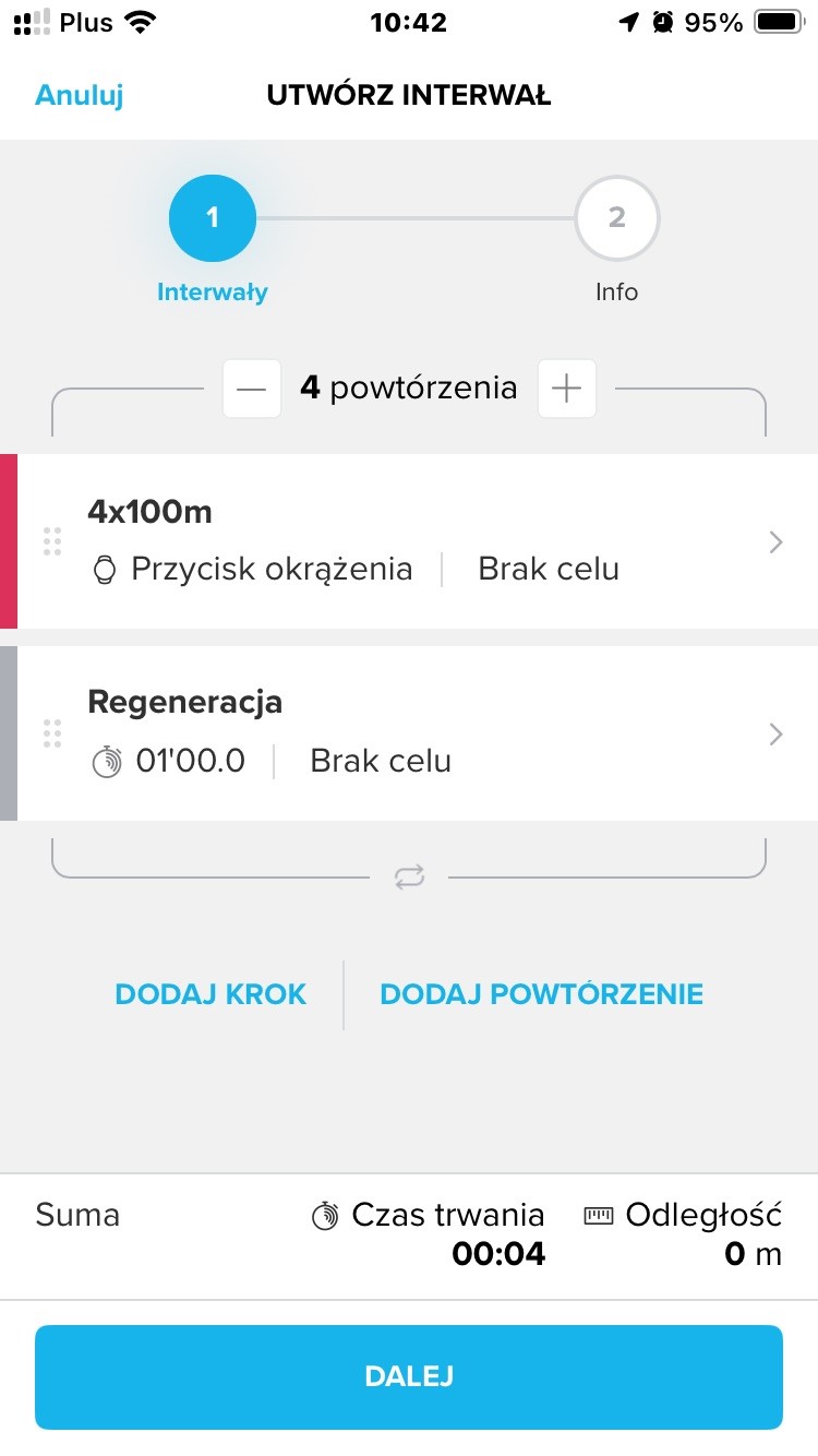

                I’ve been using intervals in swimming for years and it works great.
                You set the pool length in the “pool swimming” activity.
                Intervals is in SuuntoPlus and it’s an add-on to the main activity.
                1. Create an interval workout.
                2. Sync the watch with the app.
                3. Select the “Pool swimming” activity.
                4. Add the interval workout to the “Pool swimming” activity.
                5. Start swimming. Scroll through the screens if necessary.
                The watch doesn’t use GPS, only accelerometers to detect pool length and swimming styles.
                You can use intervals manually or automatically.

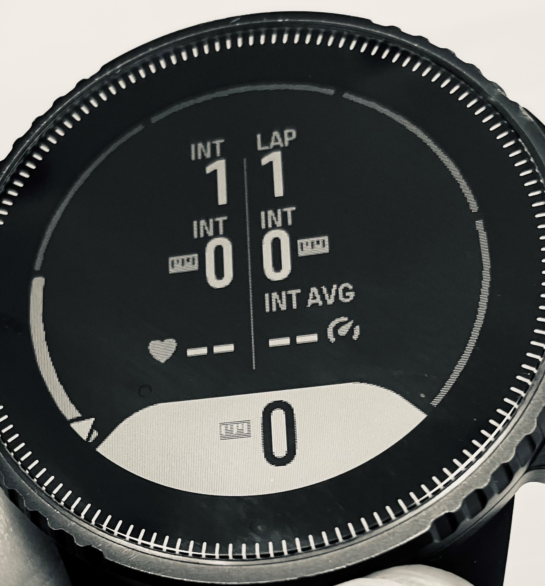

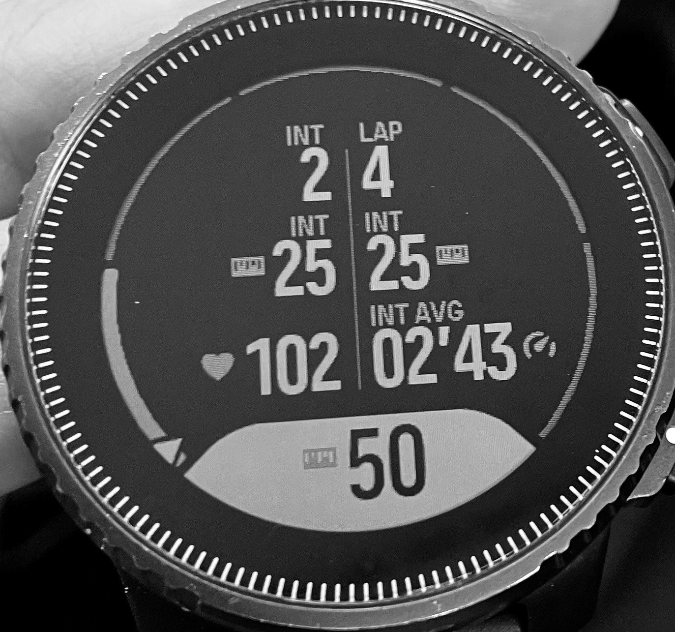

                Sample Interval Screen:
                You can create your own interval screens according to your needs.
                Additional screens:

                    Hi @João-Monsanto did you figure this out in the end ?
                    I bought a Suunto Run after my Garmin died out (was happy to make the jump to Suunto), as I both run and swim. I just did my first pool swim and cannot figure out how to see metrics for a current interval ?
                    For example, I want to initiate a new interval, push a button (or have automatically detected, not important) and seeing the counters back to zero (0m and 0min0sec), and then going on with my interval swim see the distance + time increase just for the current interval, say 300m, then, once finished push again a button, see a “rest screen” showing me “rest duration” and maybe other things, and after a few seconds push again a button to start yet another interval. I’m not interested in always seeing Total Time and Total Distance, and have to calculate in my head how long the current interval is taking me … any ideas ?
