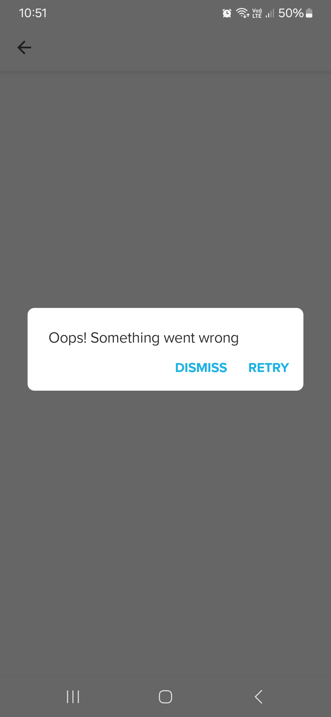

      Just purchased a race S, in the app I select the watch then guides by Suunto and find a long list of guides such as 7 minutes workout, skyrun 38k and 12 strength exercises.
      I can’t see these pre installed on the watch when I select an activity and then go to guides, so on the app I select one of these guides expecting to be shown more info and the option to send to watch but all I get is the error “oops! Something went wrong” and the option to dismiss or retry. Retry does nothing, so I dismiss and can’t get the guide.
      What am I doing wrong, do the guides no longer exist?

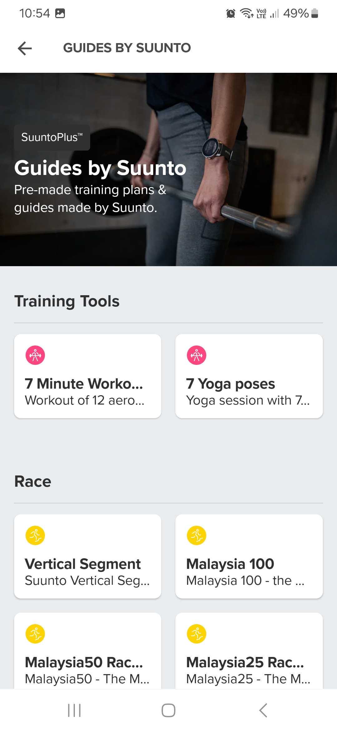

        @markcameron666 I have the exact same issue. Brand new Race All Black1000011140.jpg 1000011139.jpg
        Randomly, I managed to access and upload the yoga workouts last night, then back to ‘Oops, something went wrong’.
        Keen to know what’s up.

            @markcameron666 The watch must be connected by BT to the phone. Select the watch so you can see the sync window and icon of the watch. Scroll down to Guides. Is the Guide you want synced to the watch? If not select the Suunto Plus Store from the watch menu and select the guide you want. You should get a popup for install on watch. The watch then needs to sync and the guide should load. I just tried this for 12 Strength Exercises and it worked.
            Once you confirm the guide is on the watch, start a weight training exercise and from SuuntoPlus on the watch prior to starting the exercise scroll down and select the 12 Strength Exercises on the watch. You can only have 2 S+ apps running at one time.

              @Brad_Olwin that doesn’t work, the error comes up as you select the guide as per the screenshots above

                exact step it fails is when you select the guide you want: “select the guide you want. You should get a popup for install on watch.” pop up comes immediately saying “oops something went wrong” as someone already posted.
                I can create custom guides myself and sync them an this works, but not the ones from the store.
                I believe you’d have to test it on the new or freshly setup watch, it seems only affect new users from what I read on reddit. I hope that helps.
                thanks for looking into it
