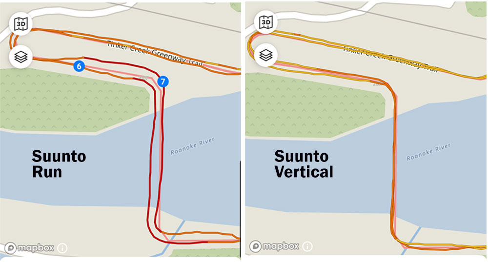

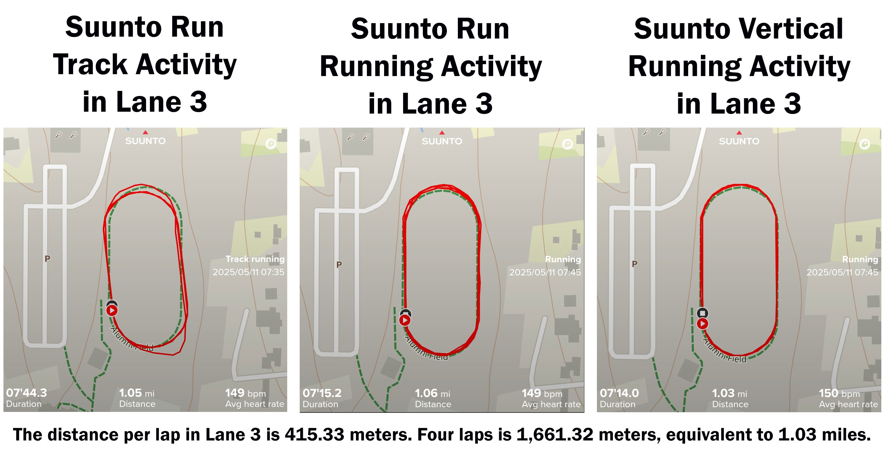

          Here’s my writeup, with only a week’s worth of testing: https://www.actionhub.com/news/2025/05/13/suunto-run-review-budget-conscious-with-a-bang/
          My biggest issue was the GPS accuracy. On every run, it was counting long – sometimes nearly 3% long, which to me is outside of an acceptable deviation. It doesn’t seem that Ray had the same experience though.

            @TrailEyes I have a similar experience to what you have, Vertical is more precise, but Run is good enough.
            Example, I did run a marathon last Sunday: Vertical measured 42.3 km, Run 42.55 🙂
            Few years ago I would have been excited for such a small error as the Run provides, but I am Vertical spoiled now 😄

                                  so Vertical and Race are still King of the GPS accuracy

                                      @babychai I have been running with Race S and Run in parallel. Is was fun to fell the 1km autolap vibrate simultaneously on both arms 🙂
                                      Since Run has the same dual band GPS chip, accuracy is not really inferior.

                                        @Egika Presumably, antenna placement or some other factor could limit a device’s GPS accuracy, beyond just the chip set.

                                          @Egika I have done the same thing with the Vertical and the Race S. I think at about mile 3 or 4 there was a slight 0.01 variation, but still rock solid. Suunto has had the best GPS of any watch I have ever owned.
