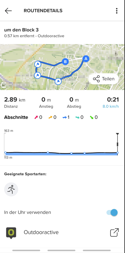

      If I import a route from Outdooractive I can’t see arrow symbols in the map, but therefore small flags. But still no TBT

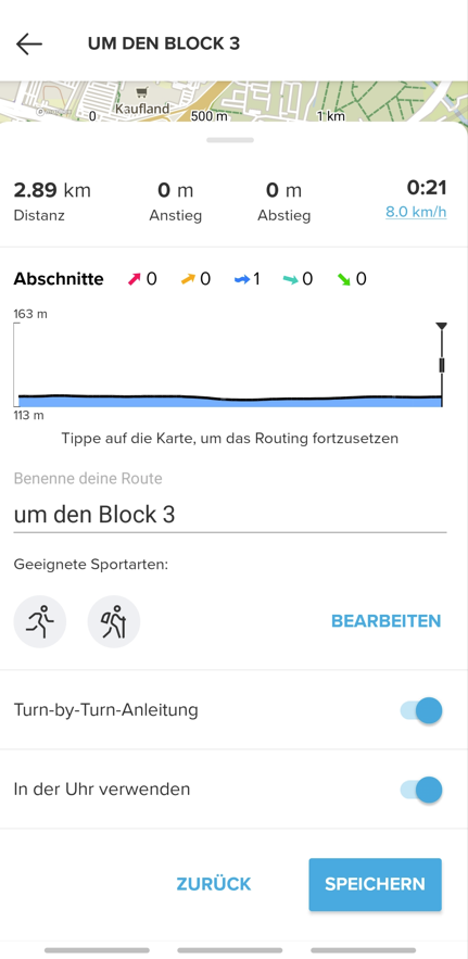

      When I export a .gpx file (tested via Outdooractive, but I expect Komoot to behave the same) and import this route into suunto, then it looks like this:
      (map is not visible in the screenshot, but no Icons were visible)
      So in the case where I expected it not at all I get the checkbox. But when I am using it during an activity no notifications are shown at all. Even not at 90deg corners. I just get a notification when I am off track.
