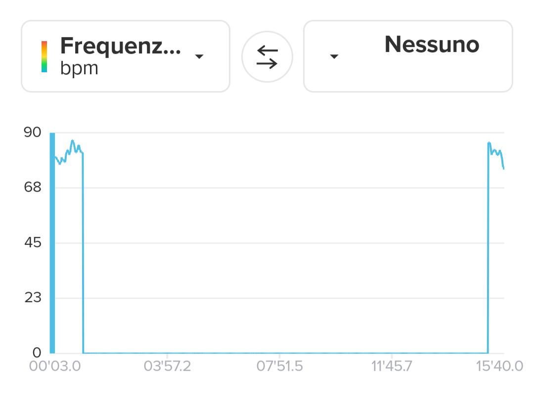

        A friend of mine kindly gave me the opportunity to test it, and unfortunately it does not seem to work. The test was quite simple: I started an activity, left the watch in the car, went to the office, and returned to the car after 15 minutes, stopped the activity, synced the watch and removed the chest strap. As you can see, at that time the heart rate was not stored on/transferred from the sensor!
        Am I missing anything?
        Thanks!
        Side note: I noticed that when using the chest strap, the wrist HR sensor keeps working. Something intended?
          isazi Moderator @Guest
          @6iovanni probably not supported, not sure if it will

              @6iovanni
              out of curiosity
              are you sure the HR strap was correctly paired and working ? did you get the heart icon with strap ?
              SVTS - 2.40.38
              Suunto App Android 6.0.2 beta
              Suunto App IOs 3.0.0 (20152) beta on MBP M1
                A Former User @sartoric
                Hi @sartoric,
                yep!
                yes, I paid attention to see the wings around icon heart. Moreover, I checked that after removing the watch the HR was displayed correctly.
                I have ordered the strap (very comfortable) and as soon as it arrives I will recheck and update the post (update: I confirm the behaviour)
