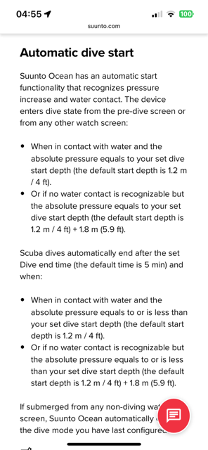

        Egika Platinum Member @dalbertlebrun
        @dalbertlebrun not strange at all.
        It is all described in the manual: https://www.suunto.com/Support/Product-support/suunto_ocean/suunto_ocean/scuba-diving/dive-setup/

            @dalbertlebrun This works as intended, but I agree it is a bit silly for most users. On this forum it has been suggested previously that the user could choose what happens in water:
            1. nothing
            2. autostart in pre-selected water activity mode (scube, freedive, snorkeling, open-water swimming etc.)
            3. autostart in last used water activity
