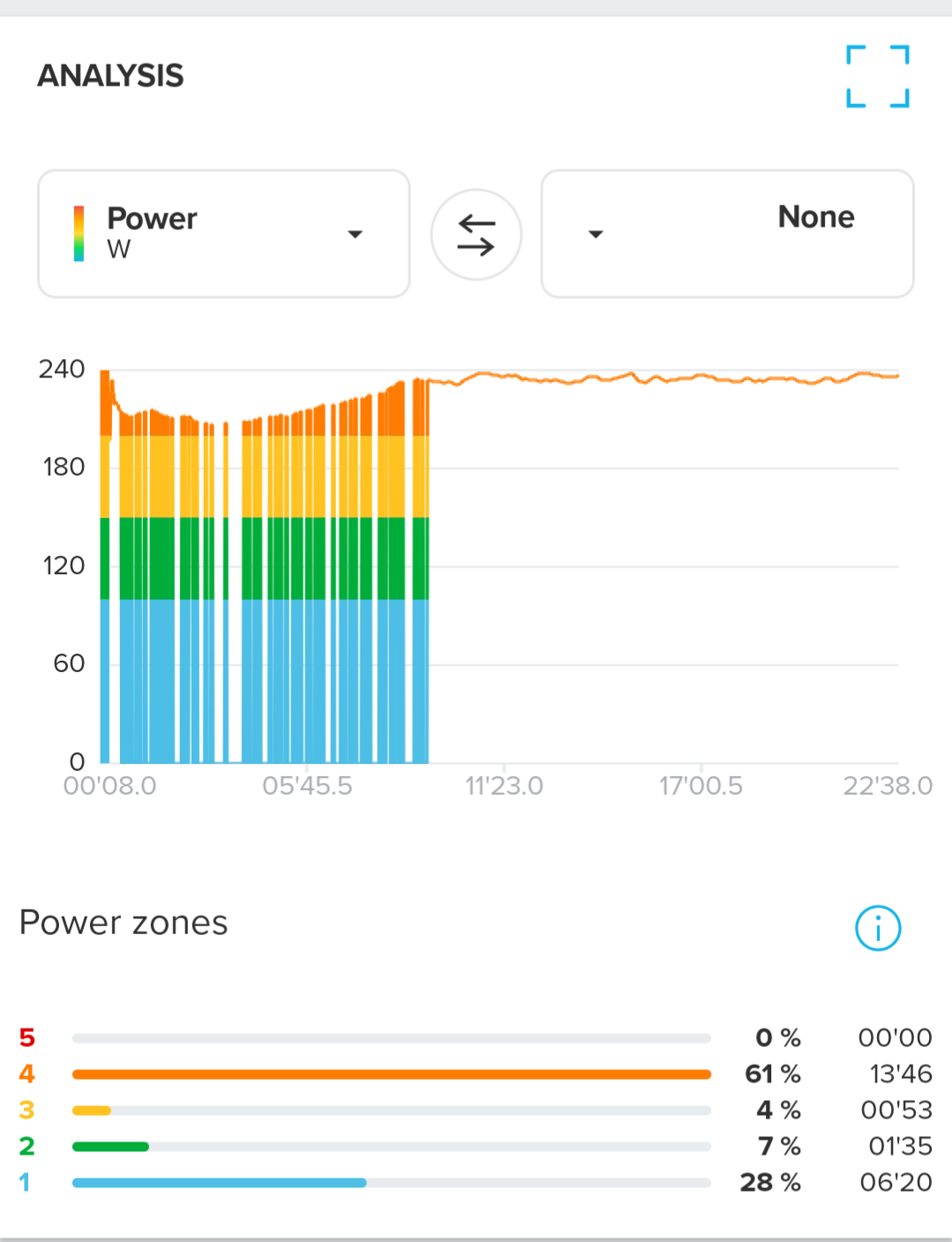

                                      • SamuelPS Online
                                        SamuelP Bronze Member
                                        I dont really ever train by power but i noticed this today when using the “track running” sport mode for the first time. Never seen this before.
                                        Suunto vertical. Latest version on watch and Suunto App.
                                        Vertical All Black
                                        atoponceA 1 Reply Last reply Reply Quote 0
