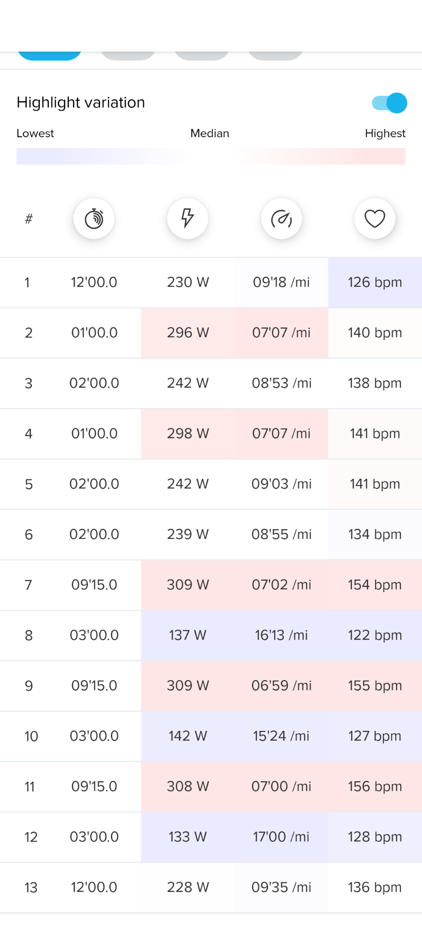

                                        @herlas Oh, interesting. I haven’t looked at the lap table in the Suunto mobile app for yesterdays run. It indeed shoes 309, 309, 308 W matching what I saw in the run itself. Looking at the other services that I have synced with Suunto, such as Intervals.icu, Runalyze, and Final Surge (where the structured workout was build) all show roughly 315-316, 315-317, 315-316 W for the interval average power data.

                                        • herlasH Offline
                                          herlas Silver Members @atoponce
                                          @atoponce so issue is not only a display issue on watch, also SA is impacted. Can you put that screenshot from SA if you don’t mind?

                                          • atoponceA Offline
                                            atoponce @herlas
