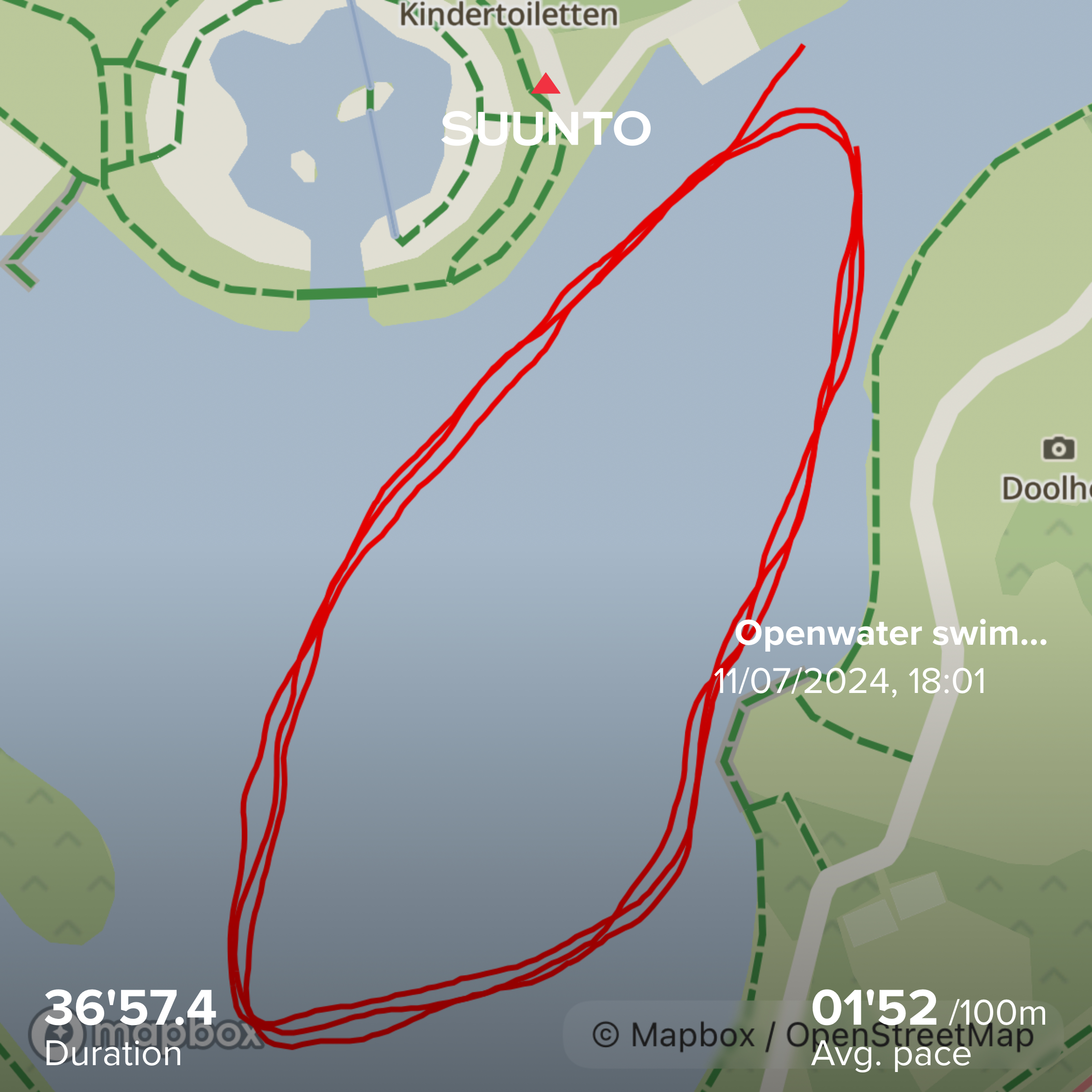

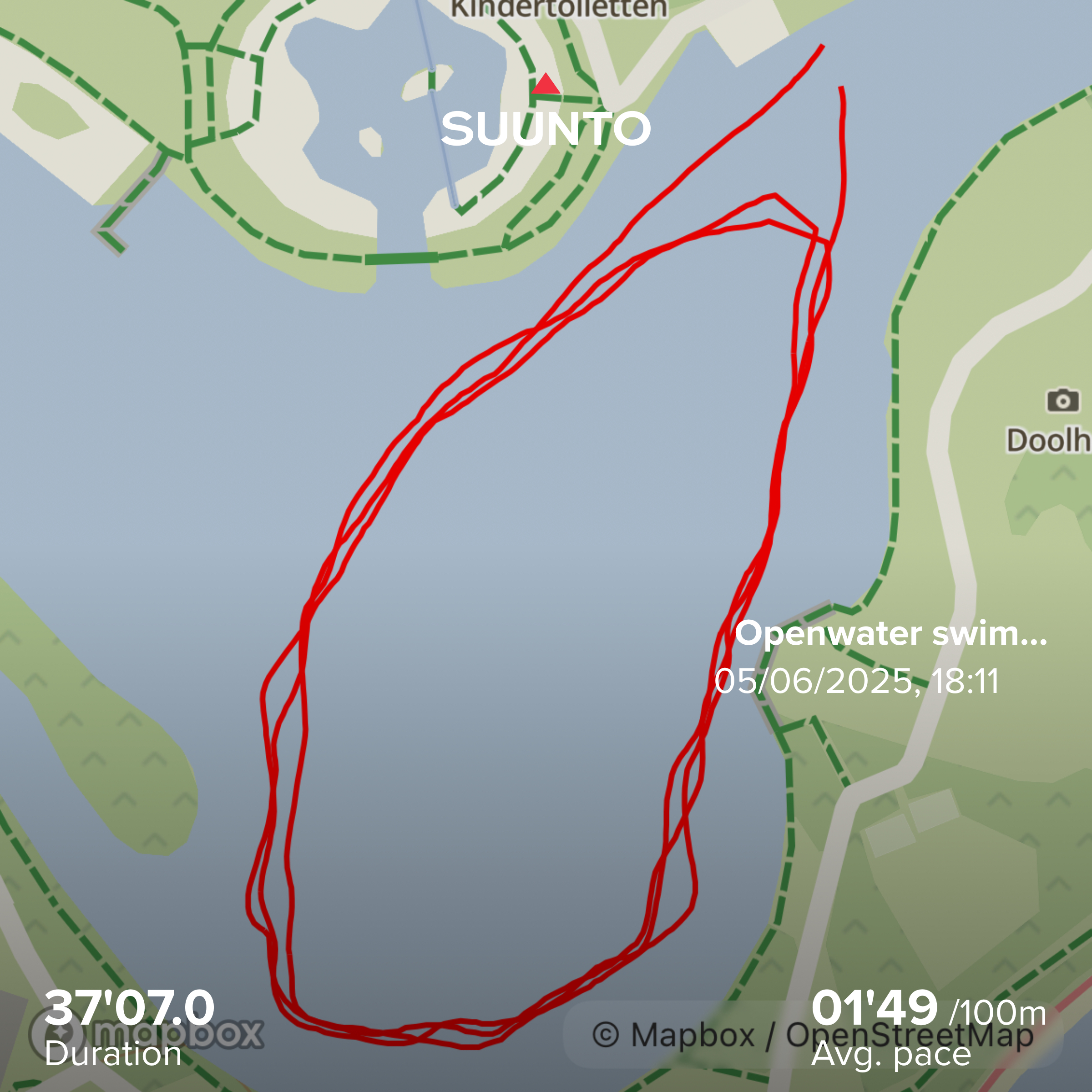

          @racesuser my measurements are pretty successful too… See below 2 swims, one year apart, first with the vertical, second withy Race S. Difference is marginal…
