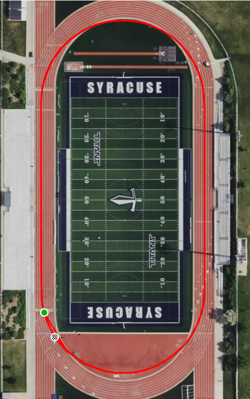

      With the recent update enabling lane calibration features with the track mode activity, I thought I would give it a try. I selected the basic track mode from the activity list, selected lane 1 to run in, then ran 4 laps around the track.
      Unfortunately as you can see, the GPS track isn’t aligned very well over lane 1 with my local high school track when looking at the satellite map on Strava. I’m guessing this is because Suunto is using different 400 m track dimensions than a typical United States high school track around an American football field? If so, can the dimensions be changed in the watch?
      Also, as has been common on my Ambit3 Peak, 9 Baro, and now the Race S, the first several seconds after pressing “Start” records 0 to the watch, including GPS coordinates. So in this activity, the first 8 seconds have a glitch GPS track from where I pressed start to when latitude/longitude coordinates are recorded.

          It’s probably the track isn’t an official athletics track. Trackmode doesn’t make gps more accurate. It just snaps you gpx to what it thinks is the track.

            Yeah, understood. I don’t know the precise dimensions of the track. I know that the IAAF permits three non-standard dimensions, including double-bend 400 meter tracks.
            I believe (but don’t know for certain) that this track is a double-bend with a 97.256 meter straightaway and inner curves of 102.744 meters. This is the common alternative for tracks that enclose an American football field.

              If the athlete is using GPS for pace and distance, then the advantage of track mode is getting precise measurements without the GPS wiggle.
              From all the couches I had, I always got a target time, not a pace. For instance, 400m intervals I have to run in 1:35. So half way I peek at my watch to check if it is 47 or 48 seconds. You cannot be more accurate. Biggest problem is that it is so much harder with amoled watches to peek at your watch than with mips watches.
              Regardless, having the right dimension helps the coach know if you started your kick on the bend (as in the case of 400 meter tracks with 84.39 meter straights) or if you started on the straight. This might be valuable information to have if the track is outdoors and it’s windy.
              Gps isn’t that inaccurate that you really cannot make out if you start before the bend or the straight.
              In the end, this is the track you can use for your training. Using it is much more beneficial than how it looks on strava.
