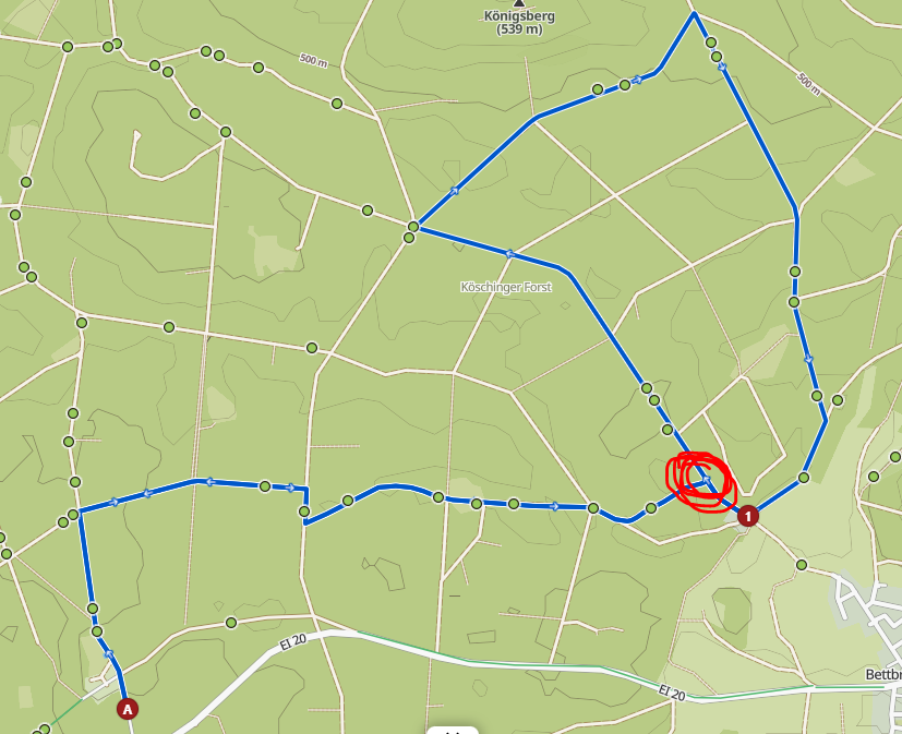

        sky-runner Platinum Member @Luis Andés Olmedo
        @Luis-Andés-Olmedo, I am pretty sure I have experienced this issue once when using my Suunto Race in a 100k ultramarathon. At some point there was a slight course change vs. the planned route, which I think had caused the watch to briefly go off-route and then the route reversed.That part of the race course was an out-and-back section, so it incorrectly locked to the return part of the out-and-back section but tracked it in reverse (isn’t that messed up!). Suunto’s route-auto-reverse logic causes more issues than it solves in my opinion.
        From that point the watch display turned on and remained being constantly on for a couple of hours until I passed the out-and-back section. I was really worried about the watch battery running out and not making it to the end of the race. Also, perhaps what triggered this condition is the fact that I had waypoints for aid-stations on the route. I think the watch logic expected distance to waypoint to reduce and turn the display off when I passed the waypoint, but instead distance to waypoint increased because the route was reversed, so the waypoint notification never cleared and remained visible at the bottom of the display.

          This was my route and the watch started to have that erroneous behaviour when at the point that I’ve highlighted in red, I followed the route in reverse. From there the screen was always ON and the elevation profile was not reversed as the route.
