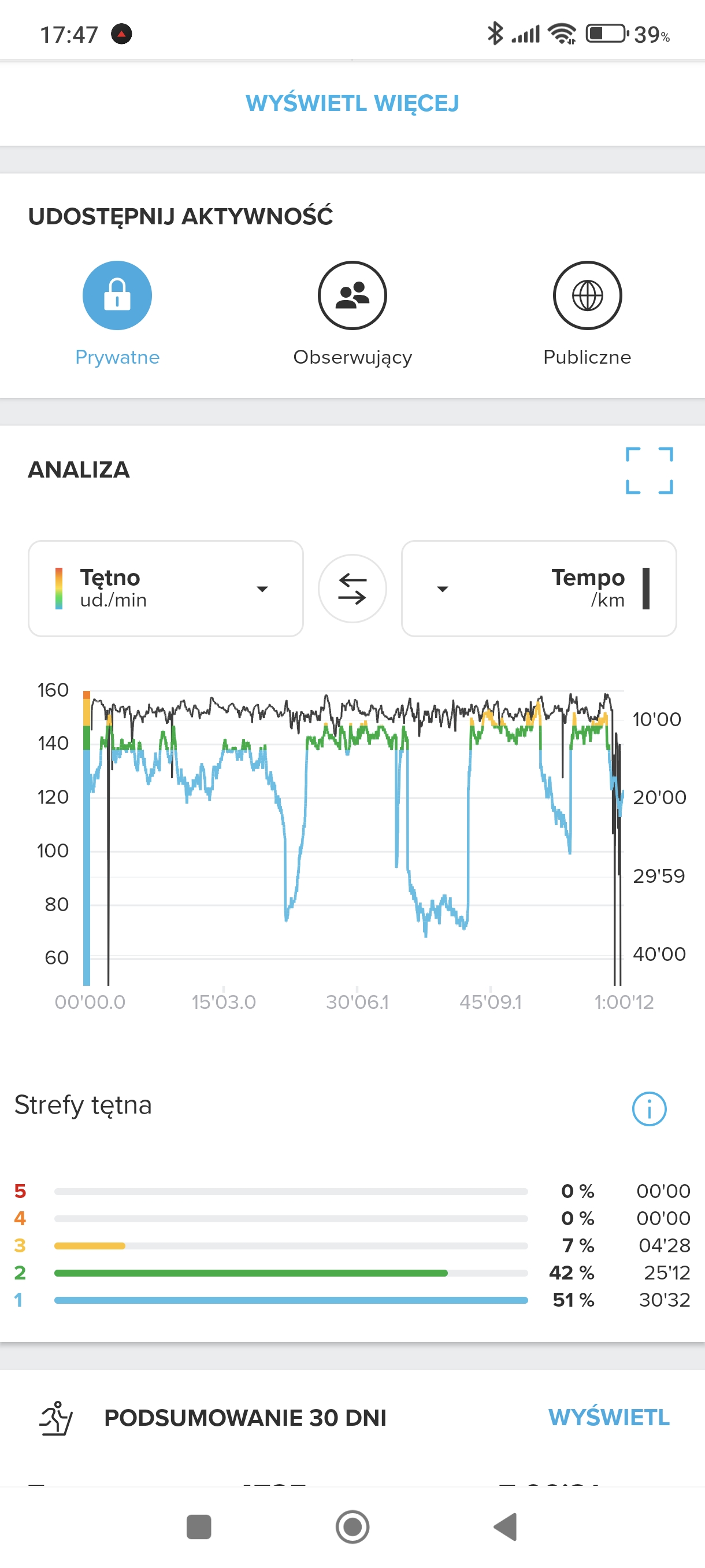

          @Martin-Deehan For hiking no . For running must have. Both Vertical and Race got terrible HR sensor. My HR is 180 drop to 40 in 5 seconds. No matter how I wear watch or how tight. I got 60 HR at rest by the way. It forced me to buy chest strap and it’s ok now. For hiking or just daily walking/working it’s ok to use watch hr only.

              That’s photo I found from march from very light jogging on theeadmill when I started adventure with running and prepare it for more intense. Anyway I think also software put his 5 cents because I think at the beginning 2 years ago my Vertical that I used worked very good during activities like cycling and noticed these drops after some time (could be after update). I also remember I could take off watch without pause activity, see it’s losing contact with my skin, put it on hand again see 40 HR back than after 5 mins of running - Boom! back to 140+ without doing anything . I always got watch on the same spot above wrist bone, with same tight. I tested different straps, spot on hand or just loose/tight strap
              Now I running with belt and it keeping 170-180 almost all the time without any drops.
