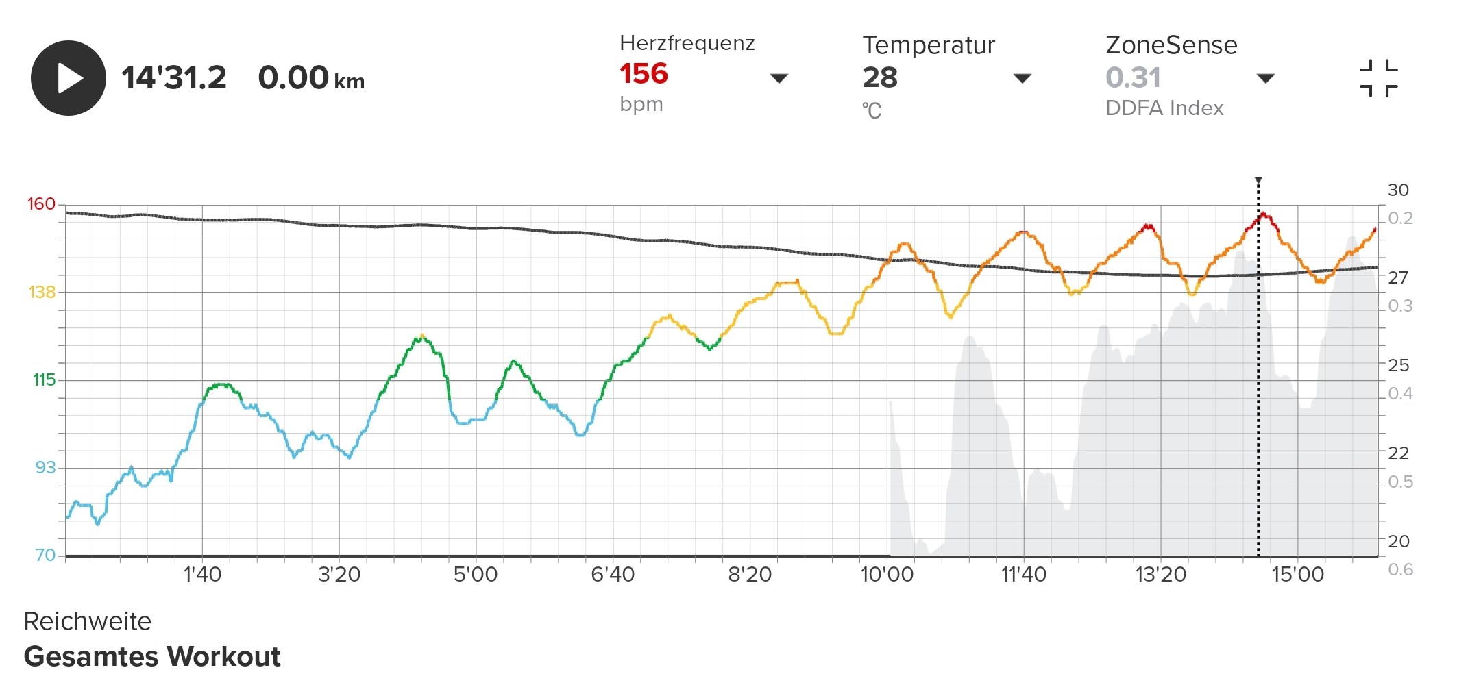

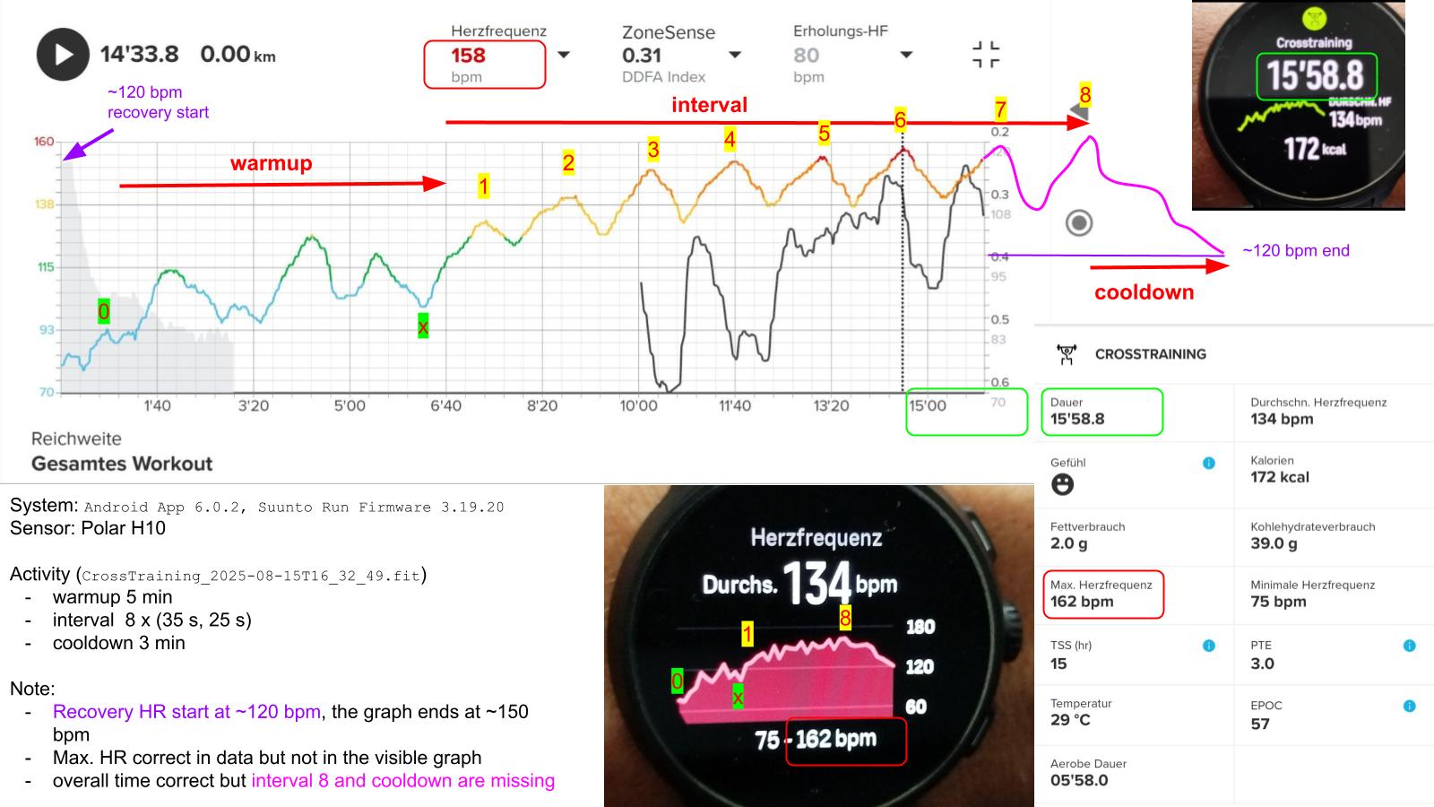

      Today I recorded a short interval workout with the Polar H10 on the Suunto Run. The HR graph on the watch seems to be correct, but the app shows something different. The last interval and the 3-minute cooldown are missing. But the time is correct😕
      Note: Android App 6.0.2, Suunto Run Firmware 3.19.20

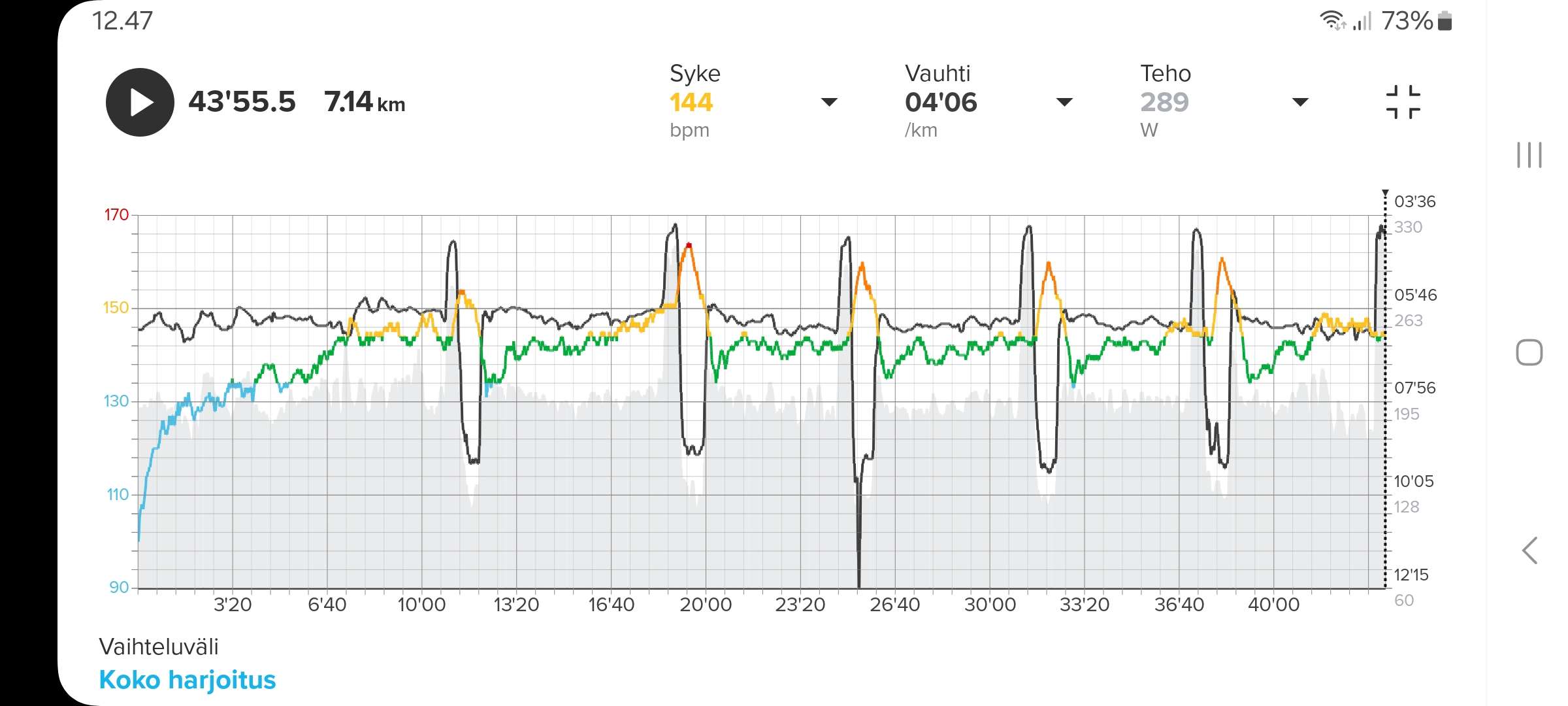

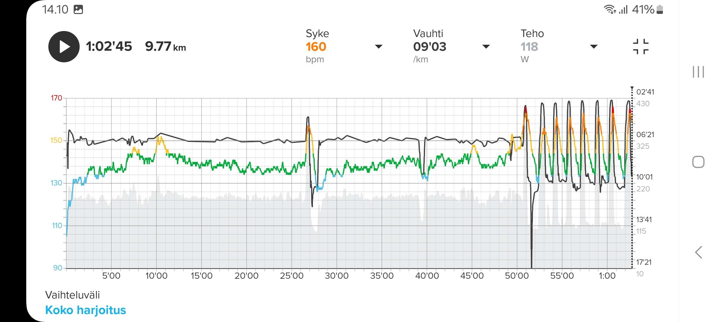

        Also using the H10 strap and having similar problems. What I think is happening here is that the heart rate recordings somehow get delayed / desynced in the app (and everywhere else, sports tracker, runalyze, strava, you name it). Yesterday, I was doing some hill sprints. I did the first hill sprint at roughly 26:12 into the run and the corresponding heart rate spike happens at 29:28. Later I did a sprint at 40:29 and the heart rate spike happens at 45:48. The gap is getting wider the longer the run is. When I stop the recording, the last X minutes of heart rate recordings are cut. When not using the strap, the HR spikes happen when they should, without delay.
        VincenzoV 1 Reply Last reply Reply Quote 1

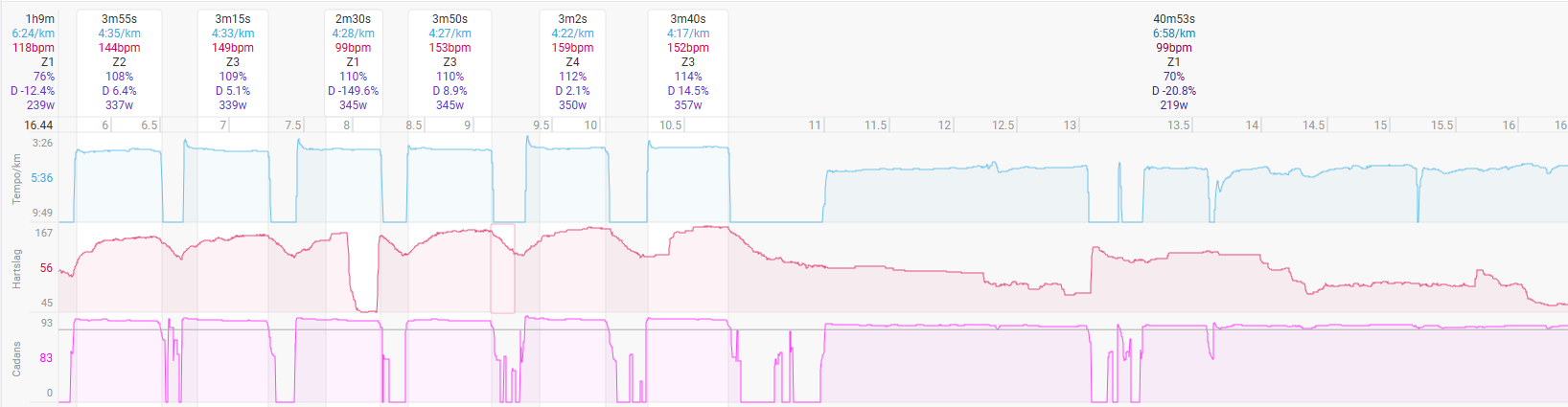

              Patch 3.20.22 massively improved the situation, but there’s still a gap between pace and HR that widens over time.
              A run with strides with H10:
              A run without the strap:
              Yves_Y 1 Reply Last reply Reply Quote 1

                Nevertheless, I’ll post a clear summary of the previous issue here (because I had already compiled it so nicely😁 )
                CrossTraining_2025-08-15T16_32_49.fit
                (I could add more examples, including those with the SmartSensor. But since the problem appears different now, I’ll leave it at that.)

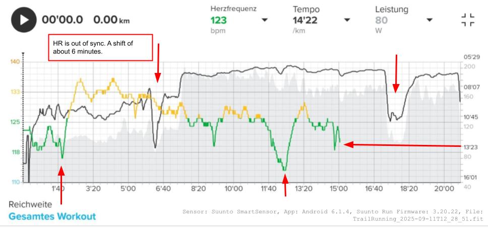

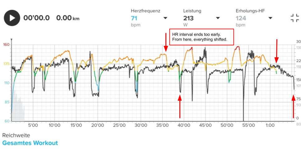

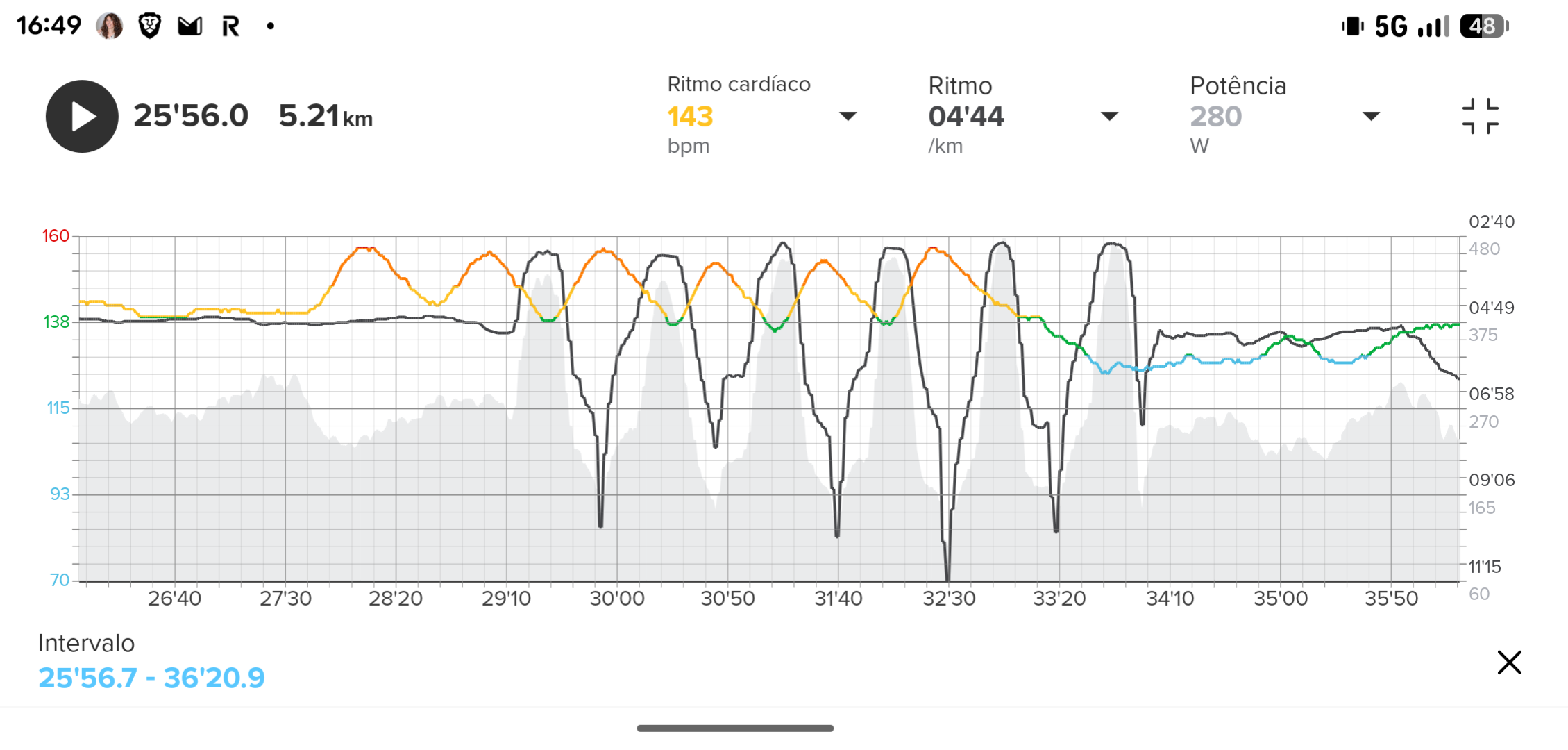

                ☝ There is definitely still a problem. I doubt it’s the H10, as it also happened randomly with my Suunto SmartSensor. Today, however, it happened again with the H10:
                Here’s a somewhat strange interval run😁 . The heart rate curve suddenly shifts around the first marker and then at the end simply stops, while pace and watts continue to be recorded🤔
                (Android App 6.1.4 Suunto Run Firmware 3.20.22)

                    Again today, during two short training sessions. This time with the Suunto SmartSensor:
                    Running_2025-09-11T11_50_09.fit
                    and immediately afterward, another activity
                    TrailRunning_2025-09-11T12_28_51.fit
                    Something is definitely out of sync here. I’ll try the Polar Verity Sense next time, but I think it happens with any sensor. It’s happening more frequently now. Before last update, I had the discrepancies in maybe one out of every four training sessions; now, it’s happening in about two out of three.

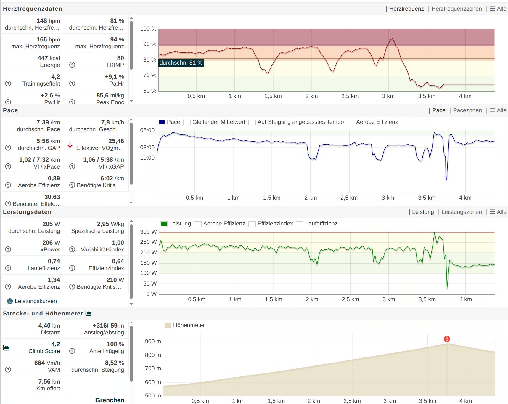

                    I’ve also noticed that newly synced activities displayed incorrect or incomplete data in the app, but the problem was later resolved. Possibly a problem with the sync status.
                    ℹ One more note:
                    The error is also visible in Runalyze, which suggests that the fit file is corrupted.

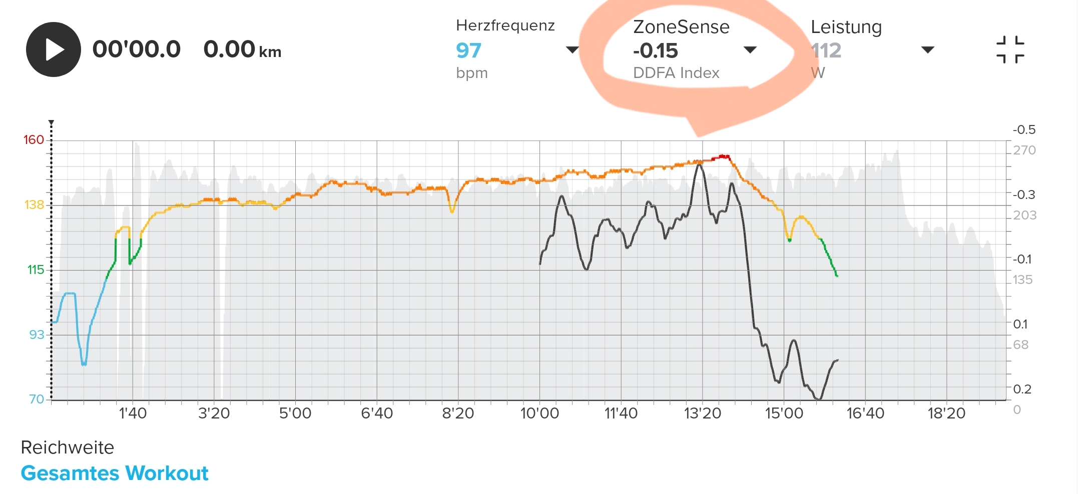

                                  @Jacobus said in Discrepancy in HR statistics between watch and app:
                                  I’ve turned off zonence, but that doesn’t make any difference.
                                  How do I turn off ZoneSense?
                                  That also looks strange. What software are you using to display the data?
                                  JacobusJ 1 Reply Last reply Reply Quote 0
                                  • JacobusJ Offline
                                    Jacobus @Yves_
                                    @Yves_ A bit unclear on my part, I turned off the zonesense app.
                                    This is a screenshot of Intervals.icu, by the way.
                                    Yves_Y 1 Reply Last reply Reply Quote 0
                                    • Yves_Y Offline
                                      Yves_ @Jacobus
                                      @Jacobus ah, okay😊
                                      I meant this because of the ZoneSense calculation. This is the only obvious difference between the results from the Suunto SmartSensor or the Polar H10 to the Polar Verity Sense. The optical Sensor doesn’t have that.
                                      Although I still don’t understand what is depicted with it🤔
