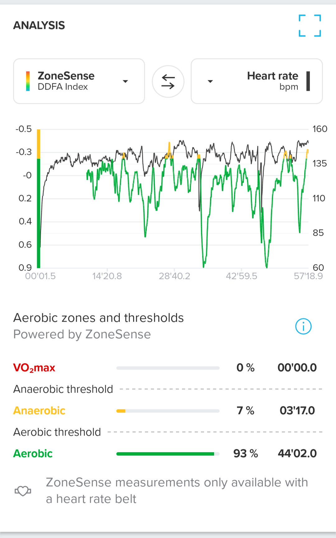

I just had a 10km trail run. Zonesense was acting super weird. I had set intensity rings to zonesense, didn’t set target. I also had zonsense S+ app active and I had custom field for HR. I was running easy pace, something I would consider aerobic based on the feeling. During almost entire run, zonesense was showing me that I was at end of an-aerobic or end of VO2Max zones, but my HR was 130-140bpm. Zonsense rings and Zonesens S+ app were showing me the same. S+ app showing me something like 10% aerobic and rest was yellow or red.
BUT, when I ended activity and checked analysis I’ve got completely different zonesense data.
Unfortunately, I don’t have any picture of watch during running, but it was showing me completely wrong data. The data in the app is more in line how I felt, but during exercise, realtime data was not correct
