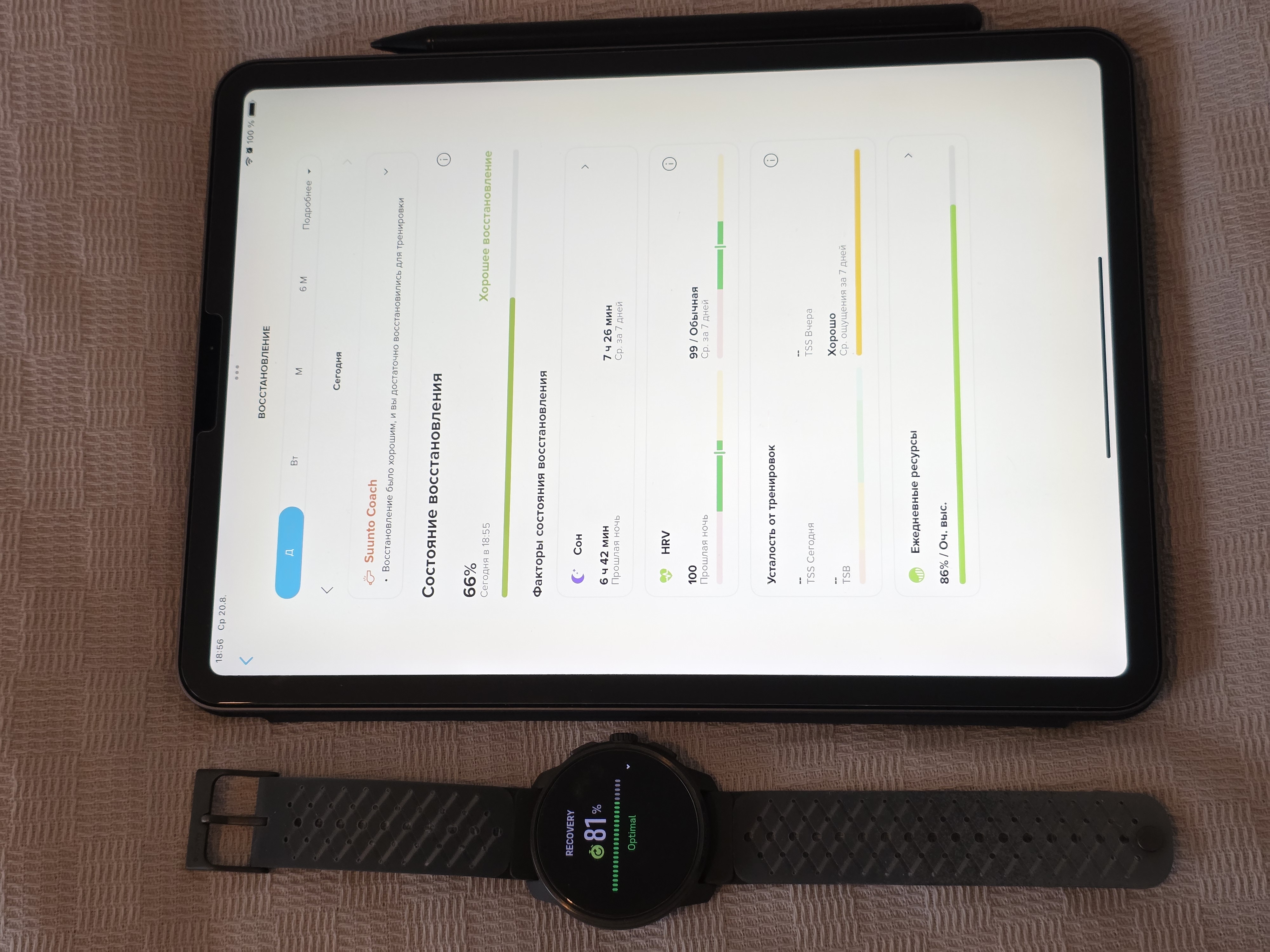

            Александр Даниленко
            Why recovery % is different on the watch and in the app?
              Александр Даниленко @Dimitrios Kanellopoulos
              @Dimitrios-Kanellopoulos ahhh
              I see. The problem is known.

                                          GiPFELKiND Silver Members @Александр Даниленко
                                          @Александр-Даниленко @Dimitrios-Kanellopoulos @Stefano-M64 Okay i cleared the App Cache and deleted all data from Suunto App in The Phone. Then opened the Suunto App and reconnect the watch to the App and now both (watch and App) shows the same Recovery values 🤩🤩🤩🤩 hope this helps you all at the Moment
