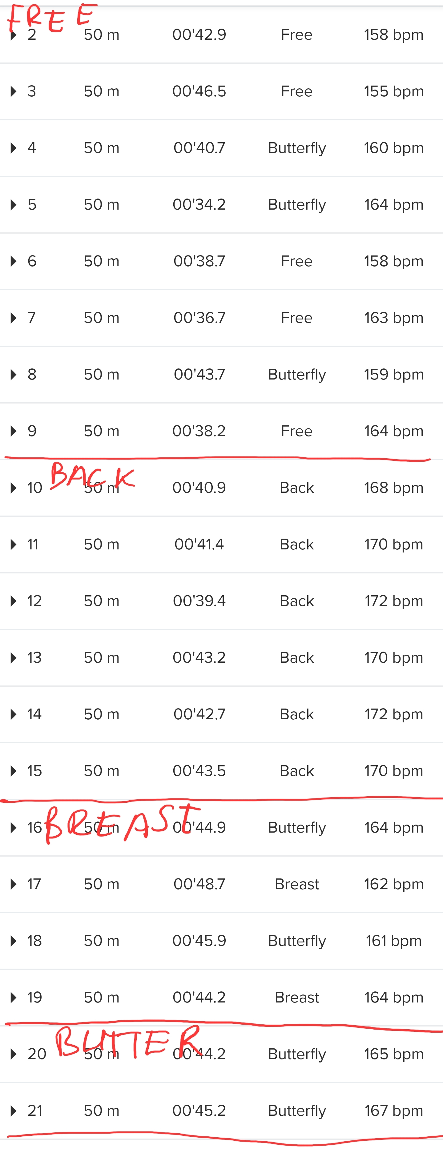

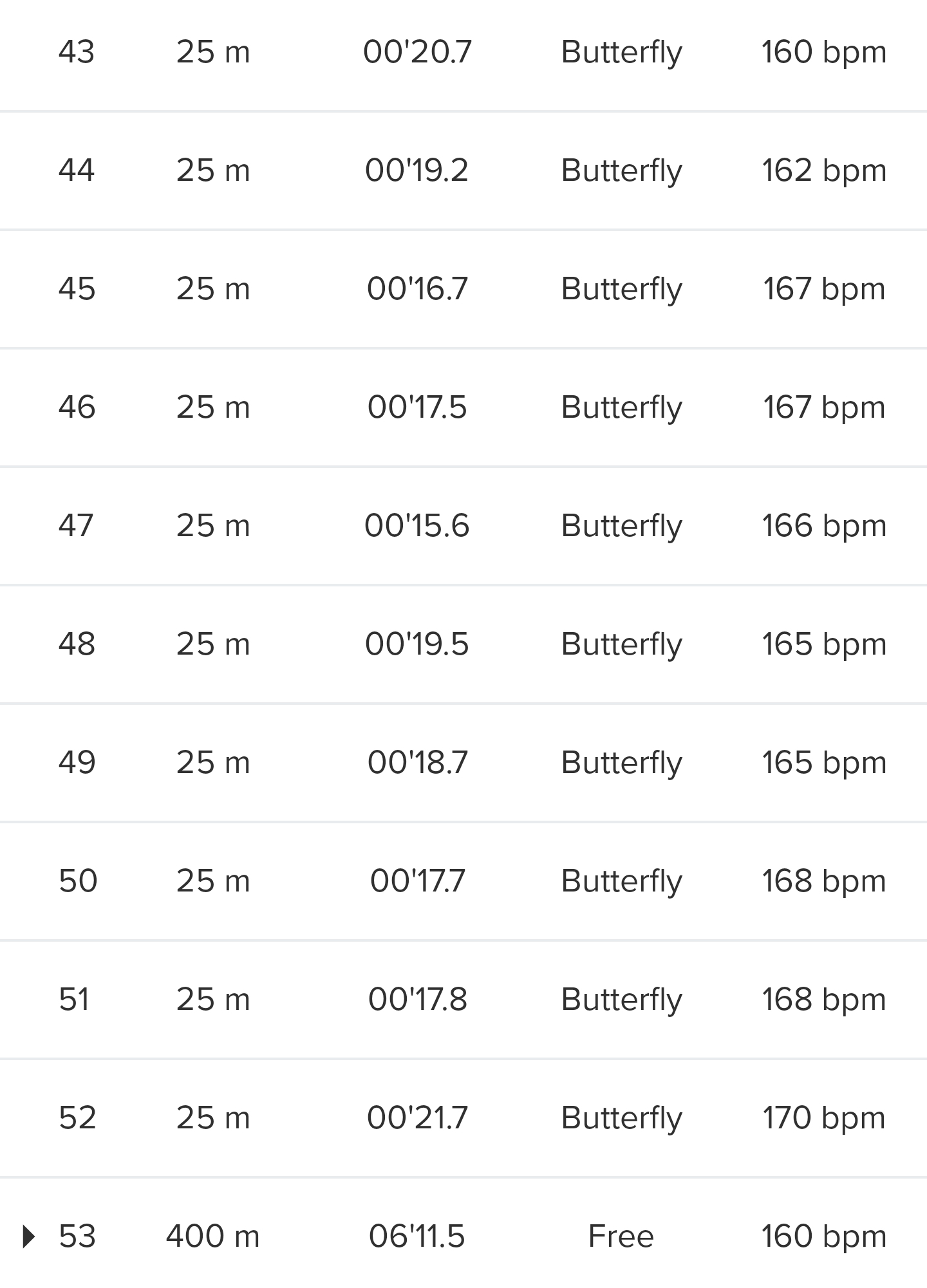

                            Александр Даниленко @kriskus
                            @kriskus they only reported stroke detection improvements.
                            Maybe it was improved, but usually I never look at it. Just as example, here is set:
                            8×50m freestyle
                            6×50m backstroke
                            4×50m breaststroke
                            2×50m butterfly
                            Not perfect but ok. The time estimation as it was - sometimes correct, sometimes not (watch often tend to show bigger time than it is, but that was like that and it is like that not only with Suunto as far as I know.
                            However, I kept around average pace here, not too intense. Things usually change when it becomes intense swimming.
                            Here I did 10×25m sprinting butterfly + 400m easy freestyle swim:
                            Style detection is correct. But on my experience the watch never have issues with butterfly detection - they even tend to call other strokes as “butterfly” when it is intense swim)).
                            In general I didn’t notice much changes. Maybe stroke detection was improved, but need more tests.

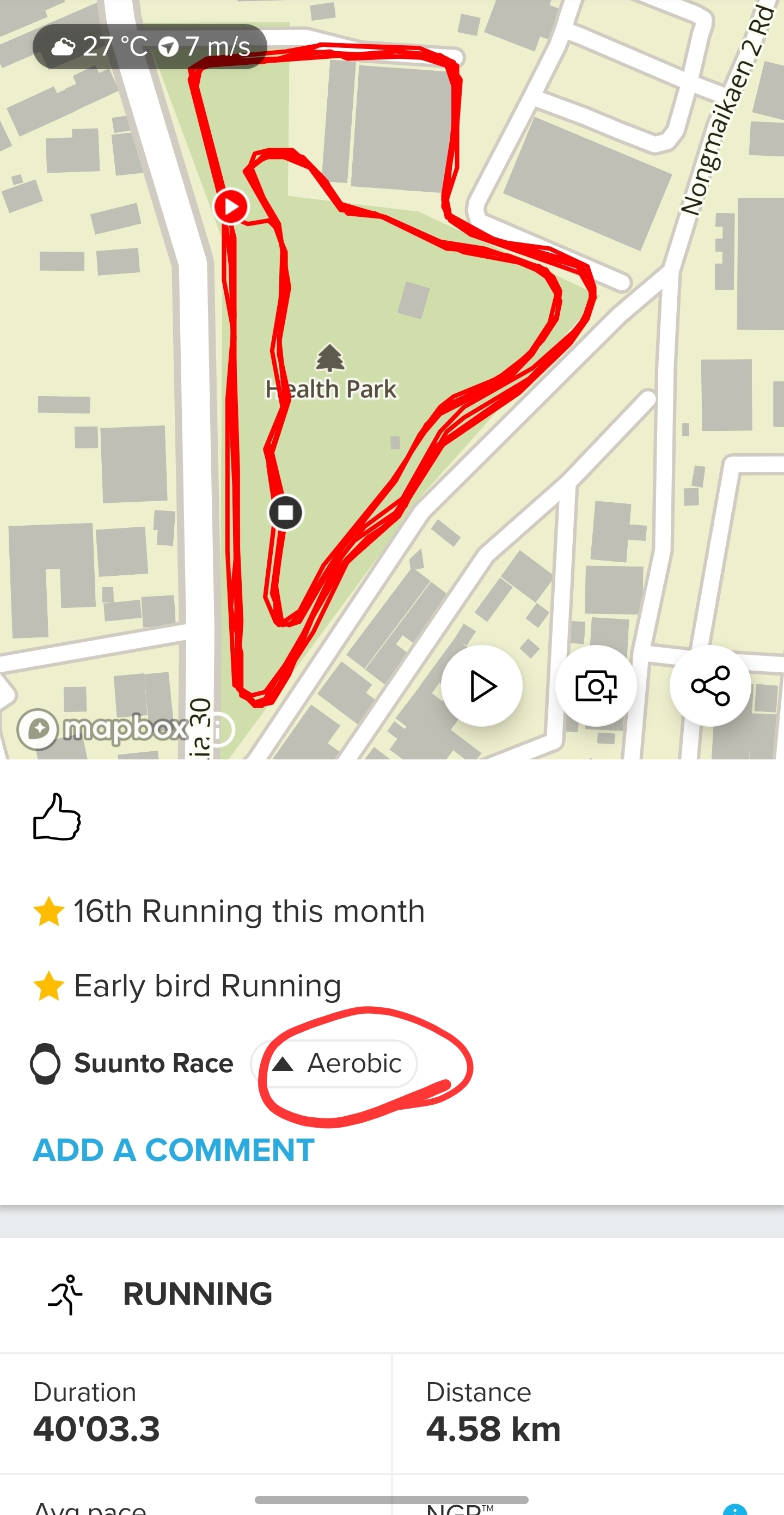

                              aiv4r
                              Strange tagging observed after the update. Ran easy run mostly in Z2 based on HR and ZoneSense seems to not leave Aerobic, but suddenly bam got a tag with “VO2max” (shrug)
                                Squirrel Bronze Member @aiv4r
                                @aiv4r said in Software Update 2.44.46 (2025 Q3):
                                Check your custom zones in watch settings and correct if necessary. Some watches experienced zones reset after the update. Same for HR max and resting HR.

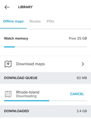

                                  email2massimo @2b2bff

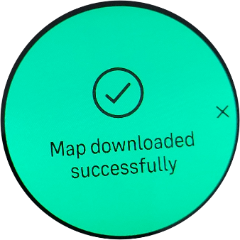

                                  @2b2bff Thanks, that’s crystal clear. However, I tried downloading an offline map and it fails in both scenarios. When I attempt to download directly from the watch, the process gets stuck while connecting to the network. When I try via the charger, I receive an alert saying I need to ensure WLAN is connected and the watch is on the charger — which it already is.
                                  I’m using the same network I’ve successfully used to download maps before, so I would assume the network itself isn’t the issue.
                                  I am wonderig if anyone already tried to download an offline map with the new update on Android.
                                  SquirrelS 2 2 Replies Last reply Reply Quote 1

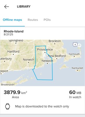

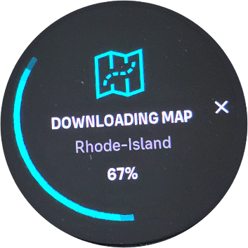

                                    Squirrel Bronze Member @email2massimo
                                    @email2massimo said in Software Update 2.44.46 (2025 Q3):
                                    Worked as expected with the watch on the wrist. I would check the WiFi settings in the app, you could also remove and add the WiFi network again if it doesn’t work. You must confirm a dialog when it comes up on the watch to initiate download. If you miss it, you can access it under Settings>Navigation>Map download, or cancel and queue again in the app. Charger warning comes up in the app, but I just dismissed it, watch never left wrist.
                                    Screenshot_20250821_144915_Suunto(1).jpg 20250821_144928(1).png 20250821_145050(1).png Screenshot_20250821_145124_Suunto(1).jpg
