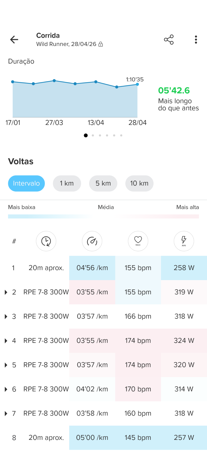

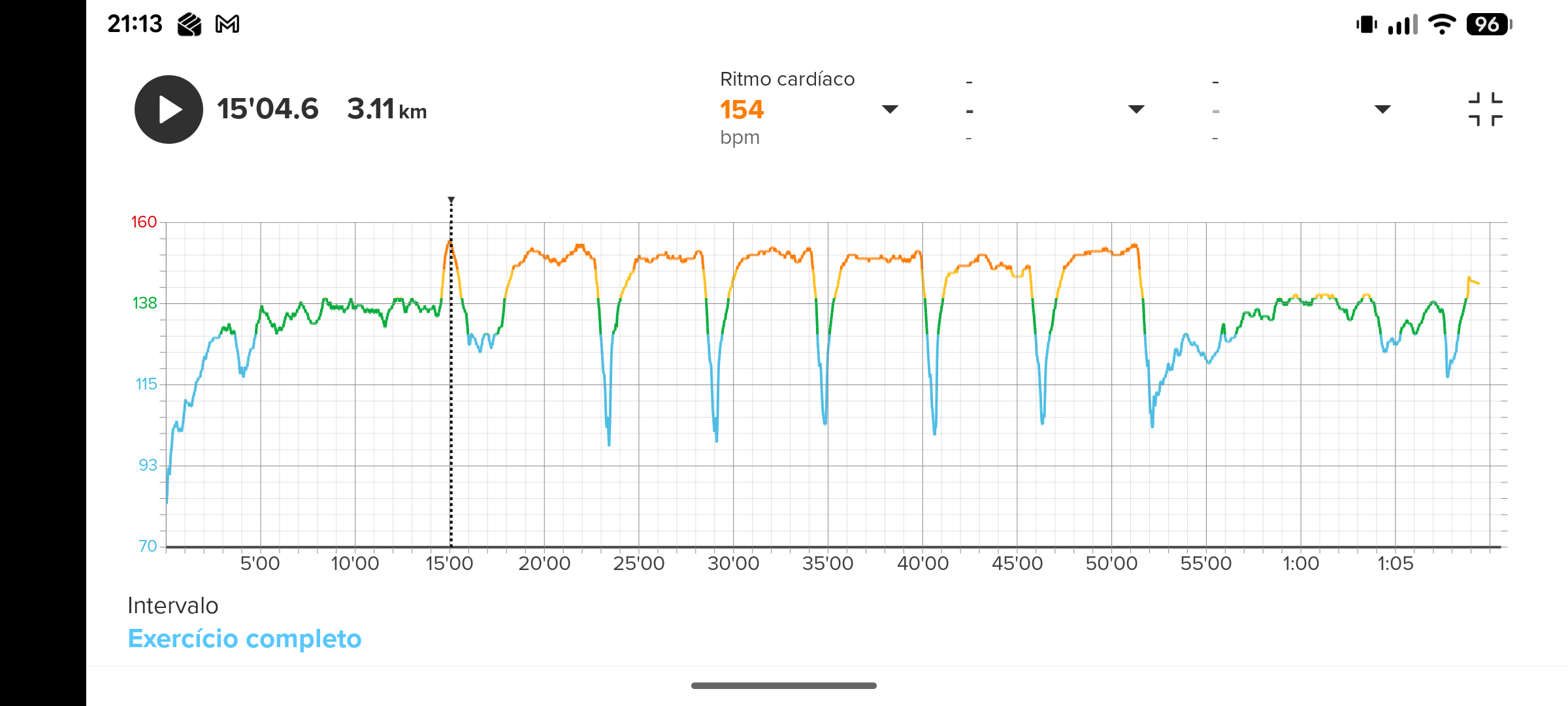

                                2 issues happened. Max heart rate much higher than registered on the HR chart and in the end I did a pause and the connection to the Suunto Chest Straps was lost when I restarted a few seconds later.
                                The maximum HR registered by the chest strap was 154bpm but somehow on the Max HR in the intervals summary many values of 170bpm (these are wrong) appears. Also it can be seen that the HR chart doesn’t end. It was the pause. Unfortunately Suunto seems unable to solve this issue that affects all watches and makes all data contaminated by wrong measures or lack of them.
                                The data sent to other plataforms like Strava or Intervals.icu is correct except for the disconnection in the end.
