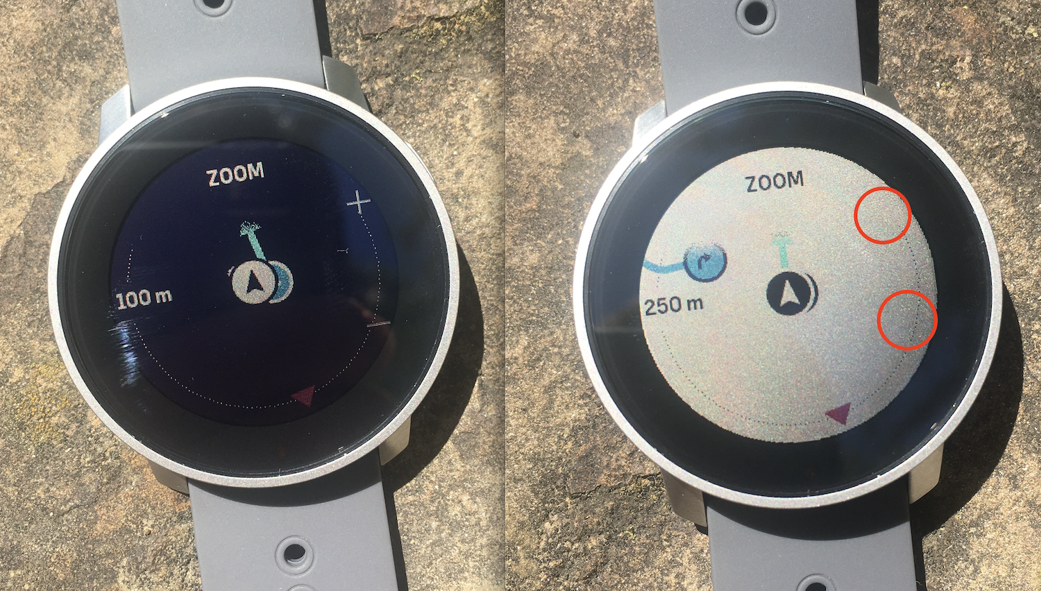

      Have you been able to check if the touchscreen function is fully operational on the navigation screen (breadcrumbs)?
      There was a bug in the last update that caused me to revert to a previous software version. I hope it’s been fixed.
      Suunto Race S (gravel gray)
        duffman19 @enriqueescoms
        @enriqueescoms Nope, same problem. Using touchscreen on the navigation screen just moves the little hamburger menu icon around.

        • enriqueescomsE Offline
          enriqueescoms @duffman19
          @duffman19 said in Suunto 9 Peak Pro 2.44.48 Beta Test:
          Don’t bother me! I can’t believe it… ugh 🤷

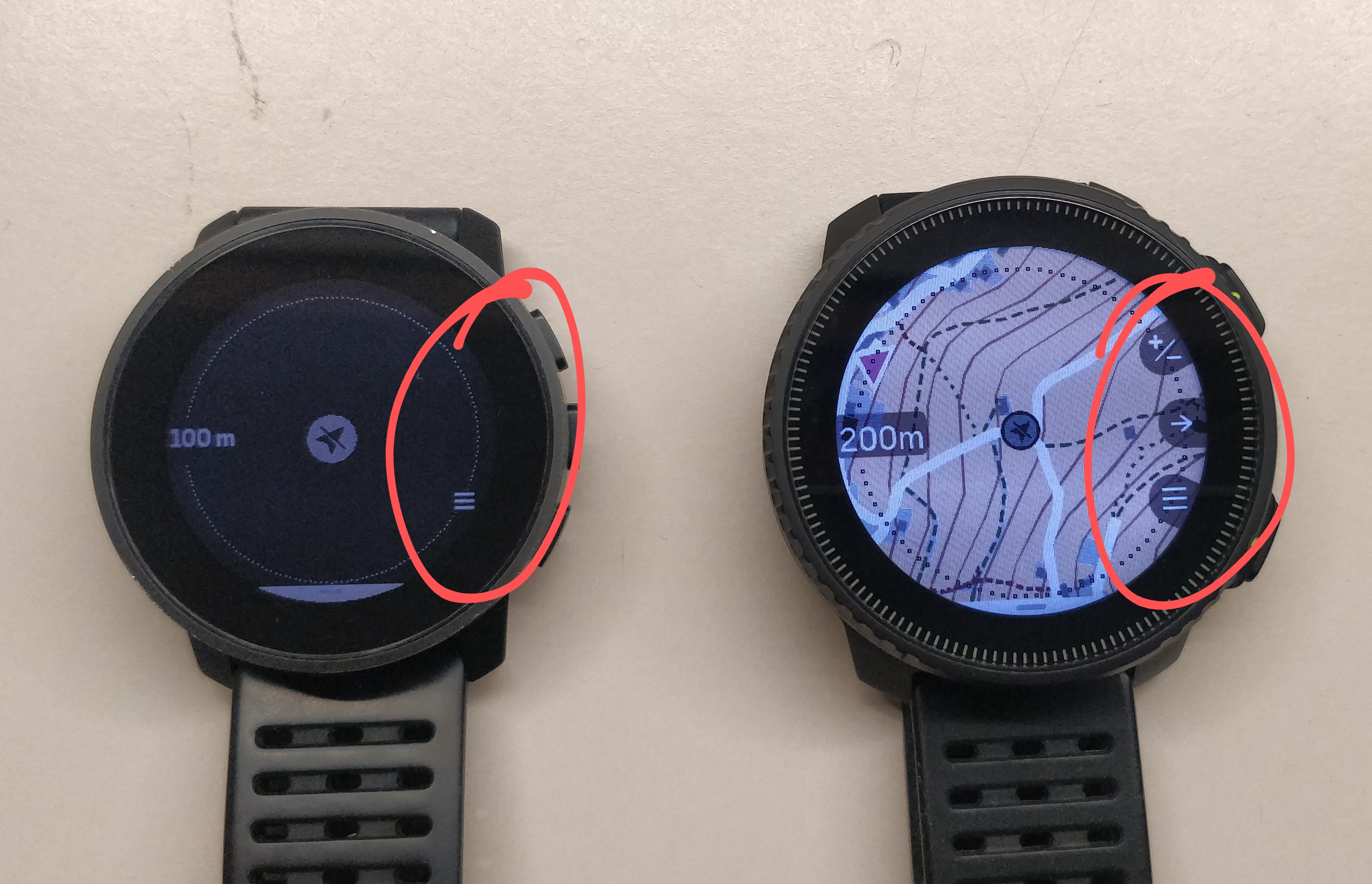

            • fondueaufromageF Offline
              fondueaufromage Bronze Member @duffman19
              @duffman19 Totally agree with you about map page and buttons, I prefer the SV version. I don’t understand if there is a reason that suunto did the functions differently.
                enriqueescoms @fondueaufromage
                @fondueaufromage Yes, you’re right. I’ve never understood why the function assignment on that screen is different between the 9PP and SV
                  enriqueescoms
                  Please, I’m making a plea from here, so someone at Suunto can respond: Fix the touchscreen bug on the navigation screen. Because if it’s not fixed, it’s impossible to go back one screen at a time (with the touchscreen because of the bug, and with buttons because of the function layout).

                    Having been for a run or two this morning, GNSS accuracy is still pretty good, correct side of the street, can see crossing over roads properly, did reasonably well in deep forest with only minor wobbles. So not a great difference to before, in so much as it still works. Didn’t test any other features, I’d agree on the comments changing 9PP nav page to vertical setup, as only way to go back is locking the screen and long pressing still, which is awkward if you want to use the zoom feature at any point.
                    EDIT: I actually just ran a test activity at home, tried to use the touchscreen in nav mode and it crashed the watch. Mildly amusing. It didn’t actually have GPS lock yet so maybe that had something to do with it. Sent logs as of 14:23 CEST.
                    Then I restarted it, got GPS lock and saw that the touchscreen only moves the burger menu off the page, and back on it. So I guess the bug is with the burger menu interaction at the bottom of the nav screen.
