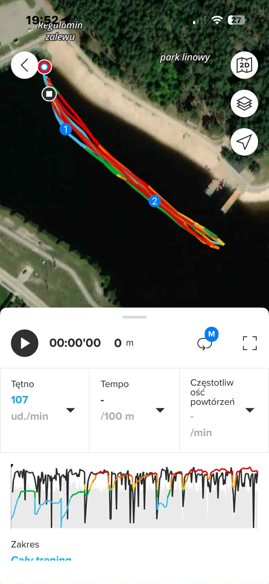

      There is some problem in open water swimming in race 2, it underestimates distance(compared to suunto run, forerunner 745) even when i export GPX file from race 2 its still too short, like it would lose connection to satelites and dont connect it again(i know that under water it loses signal)

          @Artus-Diver https://drive.google.com/file/d/1aaJIPCCQnjwCkjPscg9m4_Zow5TeEXBl/view?usp=sharing
          Lake, short about 270-290m

              Jakub Brzóska @Artus Diver
                Artus Diver @Jakub Brzóska
                @Jakub-Brzóska
                The trace GPS doesn’t look bad, the only problem that might occur is the addition or subtraction of length when turning (changing direction of swim). I’ll test my Race 2 on my body of water this weekend and let you know.
                By the way, what differences in distance are we talking about?

                  Dimitrios Kanellopoulos Community Manager @Jakub Brzóska
                  @Jakub-Brzóska GPX is not a file format to export modern watch data. Race 2 does not written often points as it does not need often GNSS points. Works a bit like fused track.

                    Jakub Brzóska @Dimitrios Kanellopoulos
                    @Dimitrios-Kanellopoulos @Artus-Diver at 180 turns i paused the watch

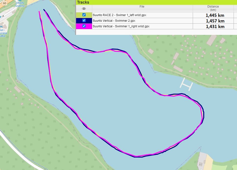

                      Hi,
                      I’m back with my tests.
                      The conditions weren’t great because it was raining, cold, and overcast.
                      Two swimmers participated in the tests.
                      Swimmer 1 - Suunto Race 2, left wrist
                      Swimmer 1 - Suunto Vertical, right wrist
                      Swimmer 2 - Suunto Vertical, left wrist.
                      The swimmers swam side by side, but not in the same swimming line.
                      I think the results are acceptable.

                        @Artus-Diver not only acceptable but this is absolute PERFECT!!
                        check this the older drifts of gps
                        https://forum.suunto.com/topic/13279/open-water-gps-drifting/57?_=1757339542401
