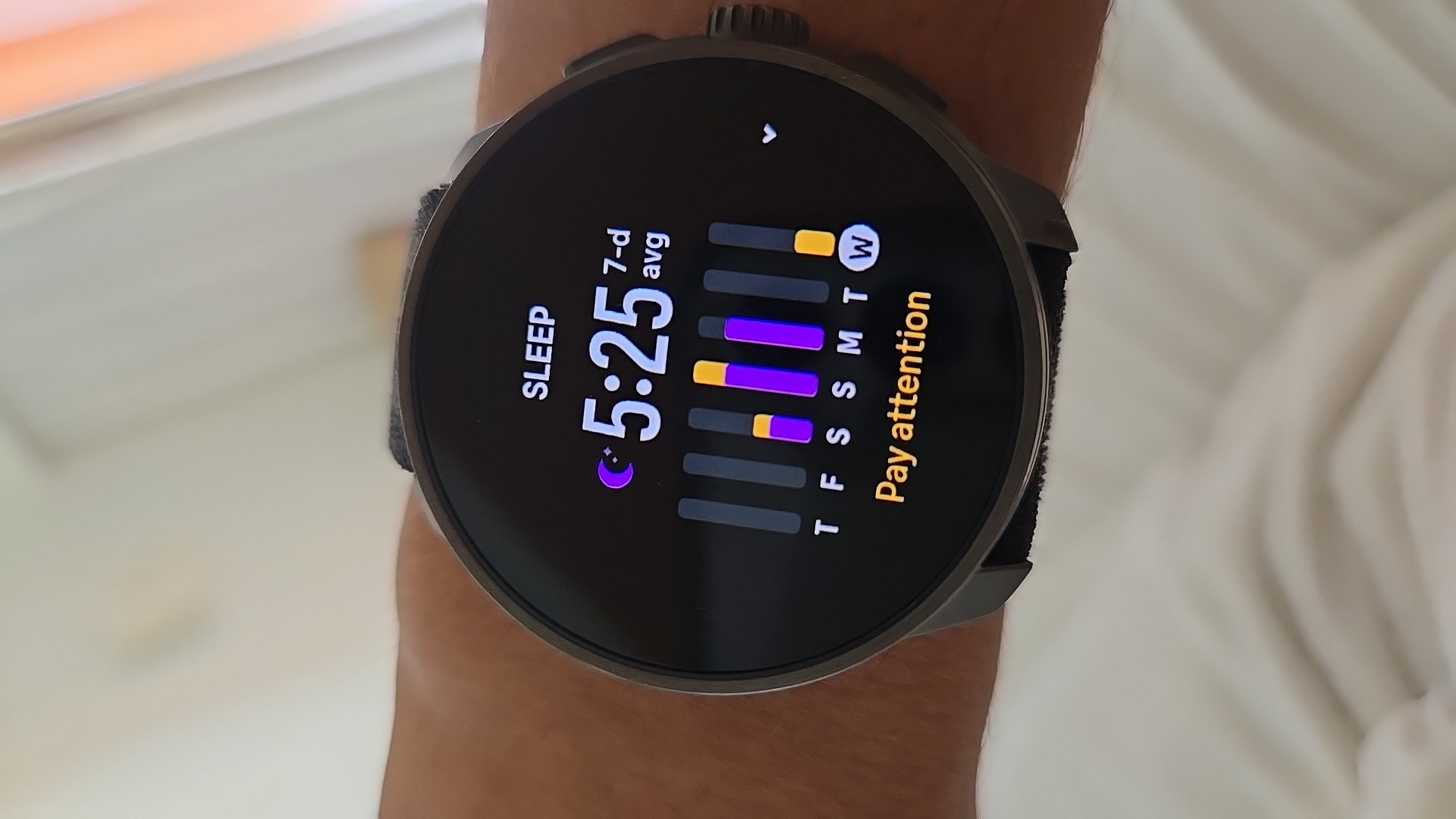

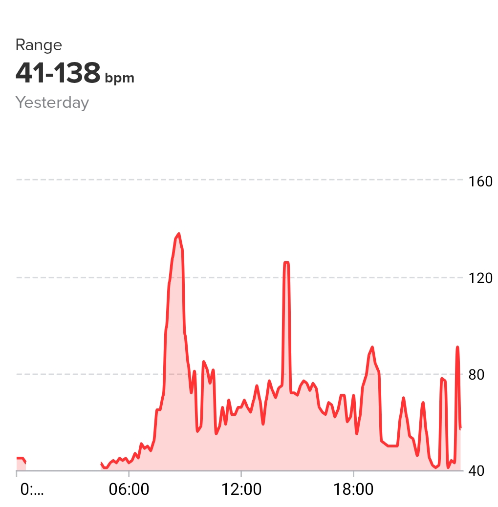

                I’m also seeing sleep detection issues after last firmware update, before never had a single issue.
                To your question @isazi my Race S was full reset when last firmware got installed, turned everything on and first night after it didn’t record any sleep so I did another hard reset and sleep was detected the next night just fine but then it has started to be very unpredictable, have done a few soft resets but not working flawless as before.
                To me it’s clear I’m part of the group seeing regression with sleep detection since last update.
                When no sleep is detected, looks like HR is not recorded during sleep either, but I think led is on though.
                Example and sleep issues screenshot.
                SRS Ti
                Galaxy Z Flip 3 / Galaxy S24+
                S B 2 Replies Last reply Reply Quote 1
