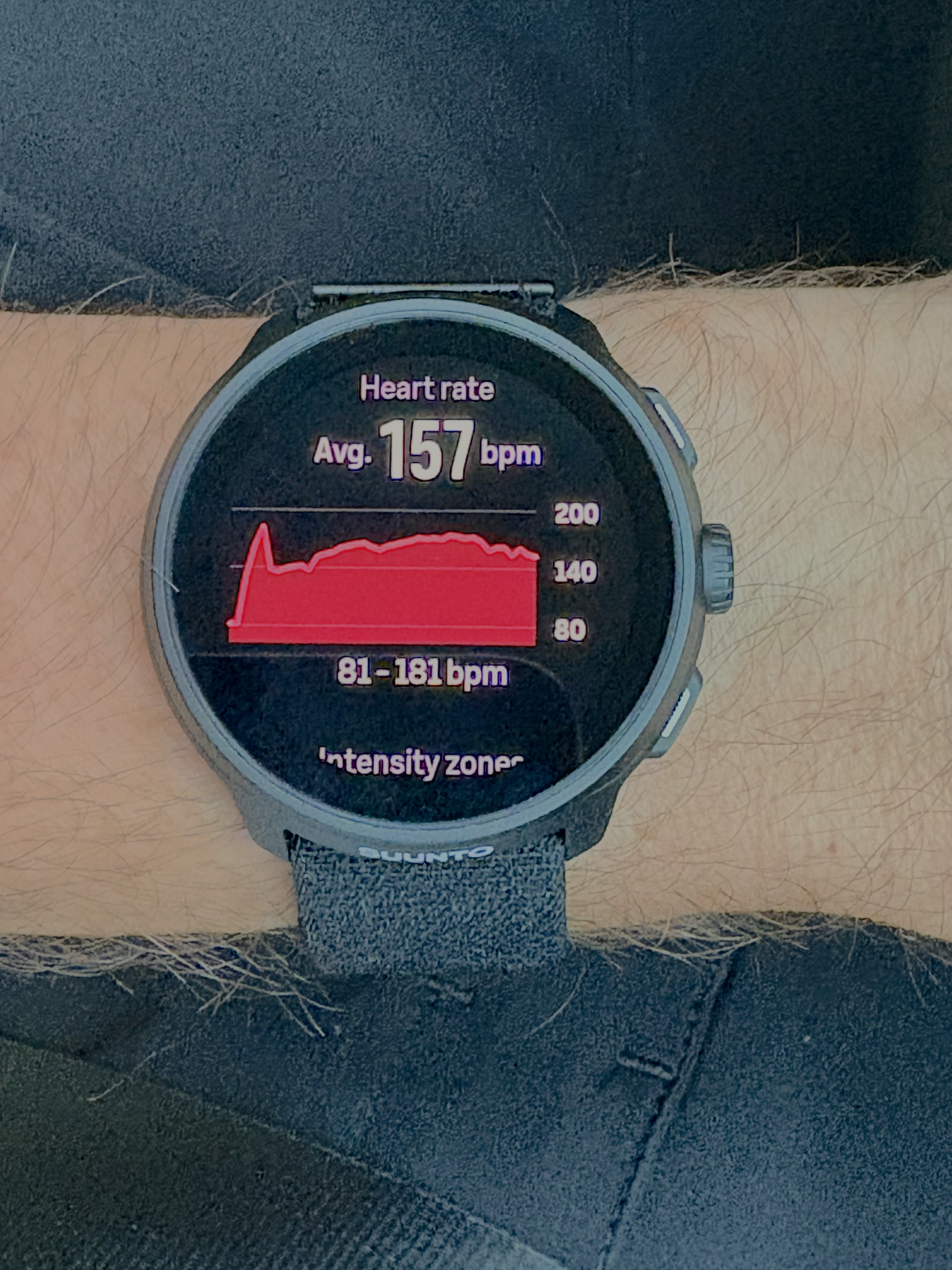

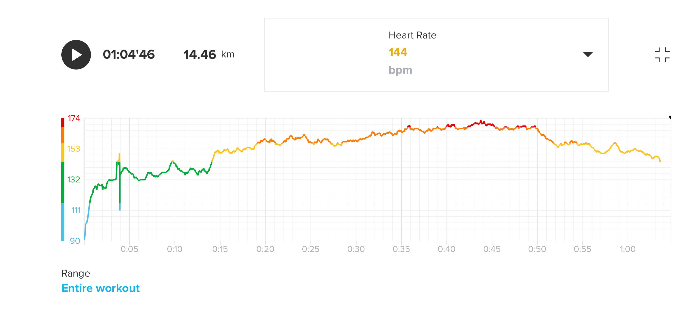

              Related to the OHR notes above, I’ve seen some weird behaviour on this first run where I had a belt (Wahoo TRACKR HR) paired and connected. During the run I think the watch was displaying OHR readings for heart rate, (with the usual spike at the beginning that I often see with OHR sensors, it peaked at like 191 during the warm up when it should have been something more like 120-130), but the synced fit file appears to be the data from the belt, with no huge spike at the beginning 🤷‍♂️

                Having looked at the device_info fields in the fit file, I’m not sure now that it was recording from the belt at all as there is no mention of the Wahoo TRACKR there. Note that I’ve been using the belt for over a year with my Wahoo Rival watch and it’s always worked flawlessly. I checked before and at one point during the run yesterday and it showed as connected in sensor settings.

                            Tested again today, icon was def the one with the belt before and during the run. I also completely removed the watch for a few minutes to make sure it wasn’t showing OHR data on screen, and it continued to give valid numbers so must have been the belt. Also I see that still the fit file has no record of the TRACKR belt in device_info, so I’ll just assume that Suunto doesn’t populate this in the fit file for whatever reason.
                            So maybe yesterday it was actually showing the belt data on screen, and the fact that the spike at the beginning showing on the watch but not post run activity/fit file is some other reason 🤷
                              I’ve been struggling with a similar issue for some time now. When I asked support if it was possible for me to see different values ​​on the watch than those actually recorded, they answered with a clear yes. This is possible in certain scenarios because the internal sensor always works, even when a strap is connected.
