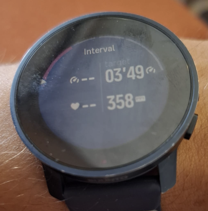

                @gogapo I created a guided workout similar to yours with SA. On the interval I can see the remaining distance to the end (358 m out of 400). My watch is a S9PP not a SR2

                  @Francesco-Pagano Today I tried a different interval workout and that screen appeared. In the meantime, I found a bug which might be related to the missing screen in the previous workout: if you set an interval with a pace target between 3:40–4:00, the app changes it to 3:39–3:59 after creating the interval. At least on iOS, this happens. I don’t know why, and I’m not sure if that’s what caused the screen not to appear. There are also some other strange bugs across the app — for instance, my height is set to 181 on the watch, but the app shows 180.
                  But going back to the intervals screen:
                  At the top, it shows the target pace for the interval.
                  In the middle: current pace, interval target pace, heart rate, and remaining distance.
                  It would be interesting not to repeat the target pace twice – next to the current pace it should instead show the lap average pace.
