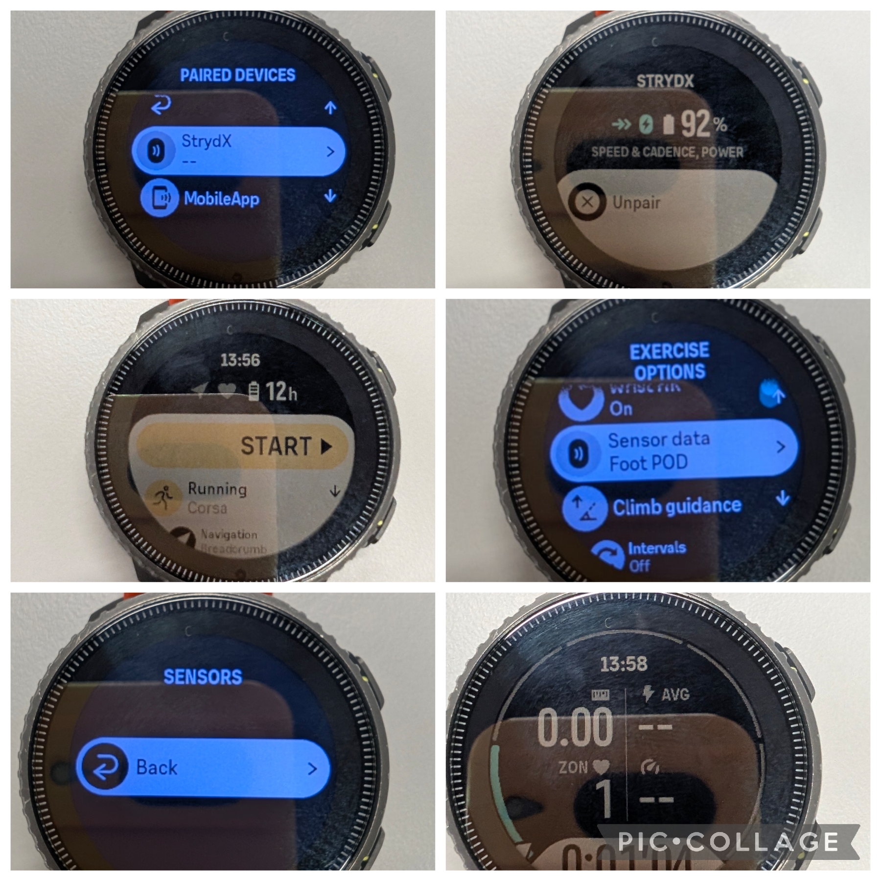

      My Stryd, despite being paired, does not work anymore with Suunto Vertical since last two FW updates (it works if used without the watch).
      ✔ I can pair the StrydX
      ✔ I see it in paired devices
      ✔ I see battery info and it is recognized as “SPEED & CADENCE, POWER”
      ✔ If I open in the pre Running menu > Excercise options > Sensor data, i see “Foot POD”
      ❎ When I enter the Sensor data Foot POD menu, there is nothing, only Back arrow
      ❎ When I start running there is no pod icon in the menu
      ❎ During the run, power information comes from the watch, not the pod (if I move the watch power goes up, if I move the pod nothing happens)
      My setup:
      • Suunto Vertical Ti Solar - FW 2.44.52 (same with previous 2.44.46)
      • Next Gen Stryd - FW 2.1.32.1.1
      I see others had similar issues with footpods in other threads but there was no dedicated thread:
      • Software Update 2.44.52 (2025 Q3 - HOTFIX) - (No footpod icon when about to start an activity) https://forum.suunto.com/topic/13770/software-update-2.44.52-2025-q3-hotfix/105
      • Connection to Stryd and Suunto Smart - https://forum.suunto.com/topic/13706/connection-to-stryd-and-suunto-smart
      • Frequent beeping after recent firmware update, even when not in a workout [Perhaps due to Stryd?] - https://forum.suunto.com/topic/13691/frequent-beeping-after-recent-firmware-update-even-when-not-in-a-workout-perhaps-due-to-stryd
      I contacted support and tried everything they suggested (restart, forget and pair, power off…) but nothing worked.
      Last resort would be hard reset but I have little hope it would work and would like to see if others have a SV which works with a footpod since last FW update.
      Any suggestions?

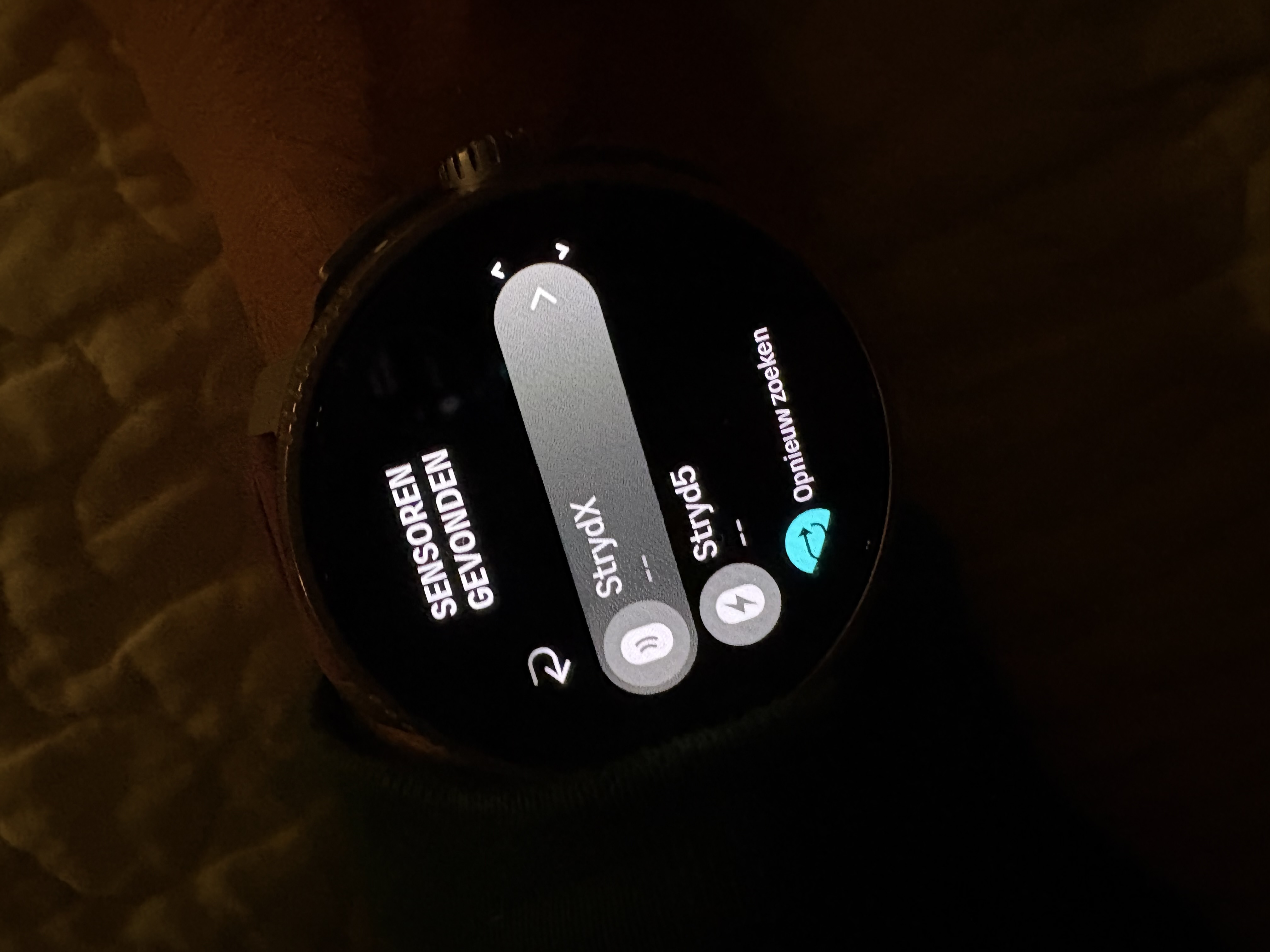

            marcrie Bronze Member @kurtpenter
            @kurtpenter I use a s9pp and had the same issue when using the stryd app. In that case I don’t connect the stryd pod in the settings menu. Instead the watch connect to the stryd pod by itself when I activate the stryd-app within the training options (the menu you see before you start your sport mode/exercise). Maybe that can help you.
