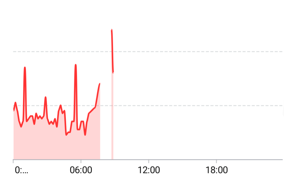

                  • Hari SeldonH Offline
                    Hari Seldon @Hari Seldon
                    This morning, as soon as I woke up, I synced the watch and activated PS. After a couple of hours, I disabled it and synced again:
                    So, unless I’ve missed something, there was no HR activity during those two hours, and that’s the behavior I expect from PS. I’m not saying you’re wrong, of course, so it’s best to ask @herlas why there are two different results.
