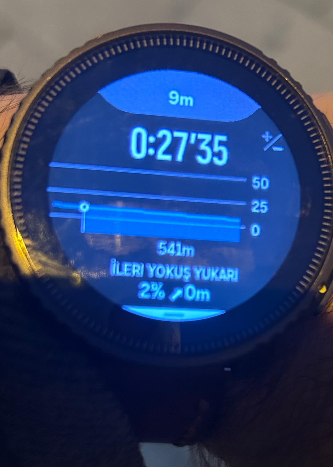

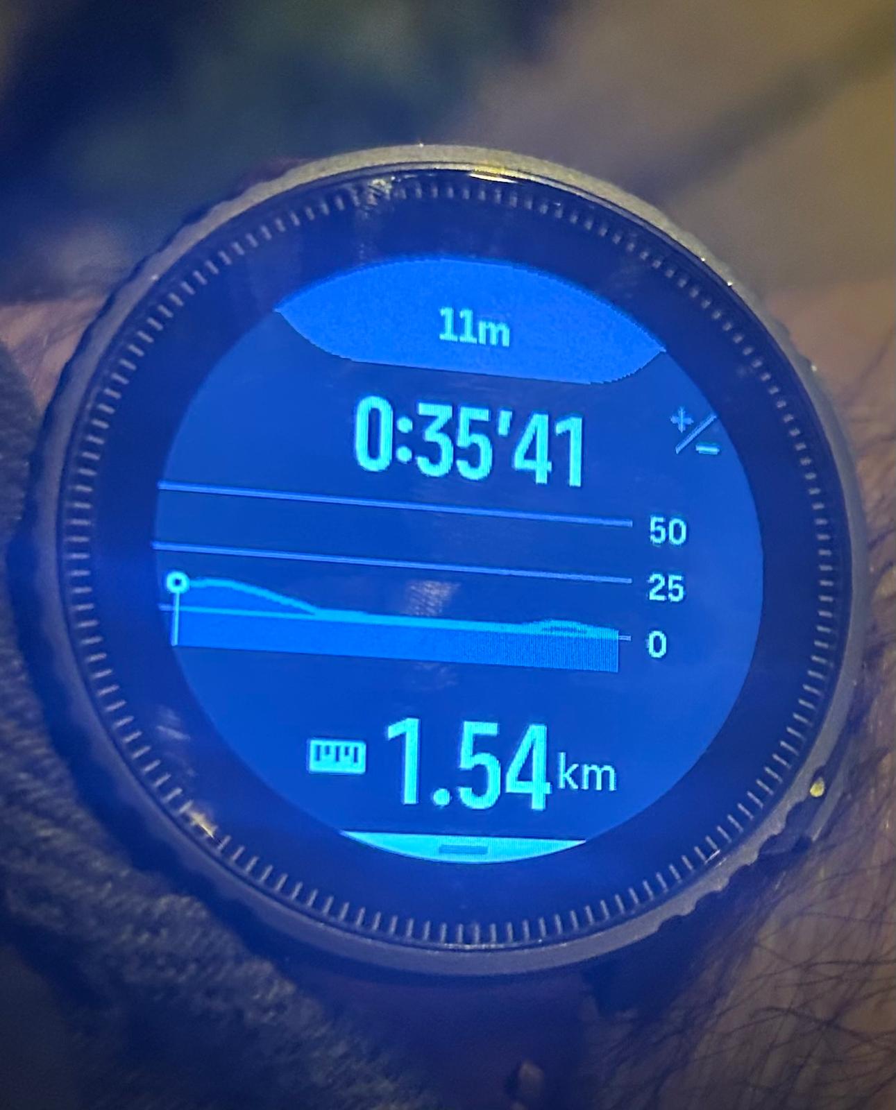

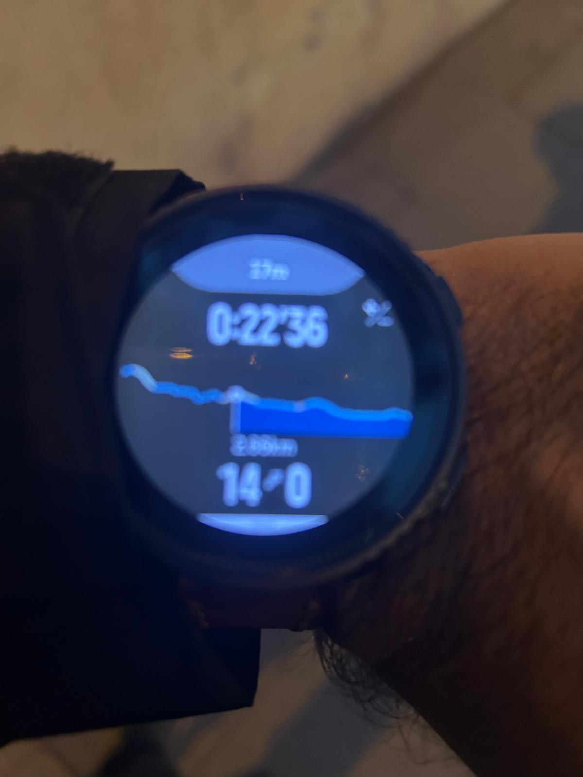

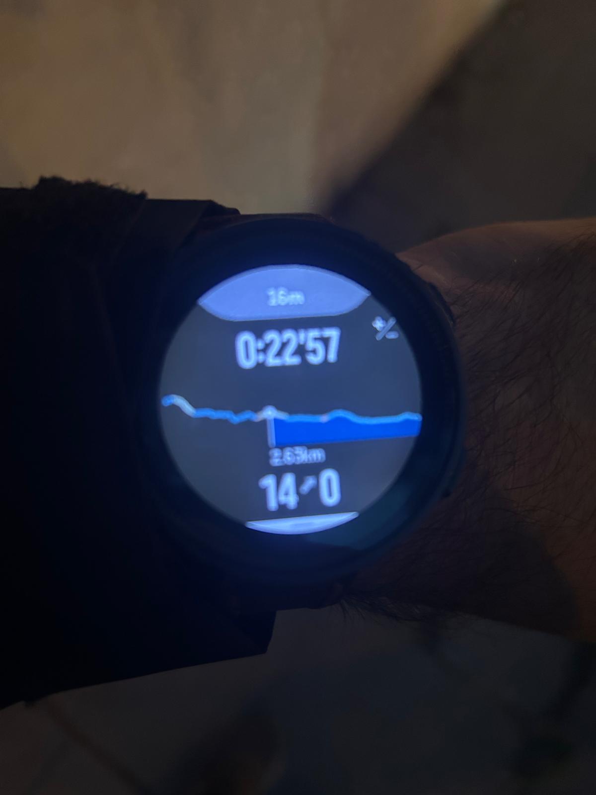

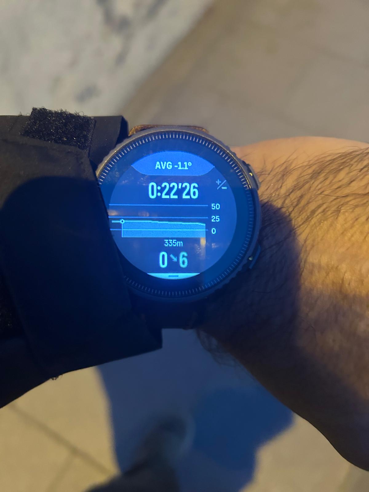

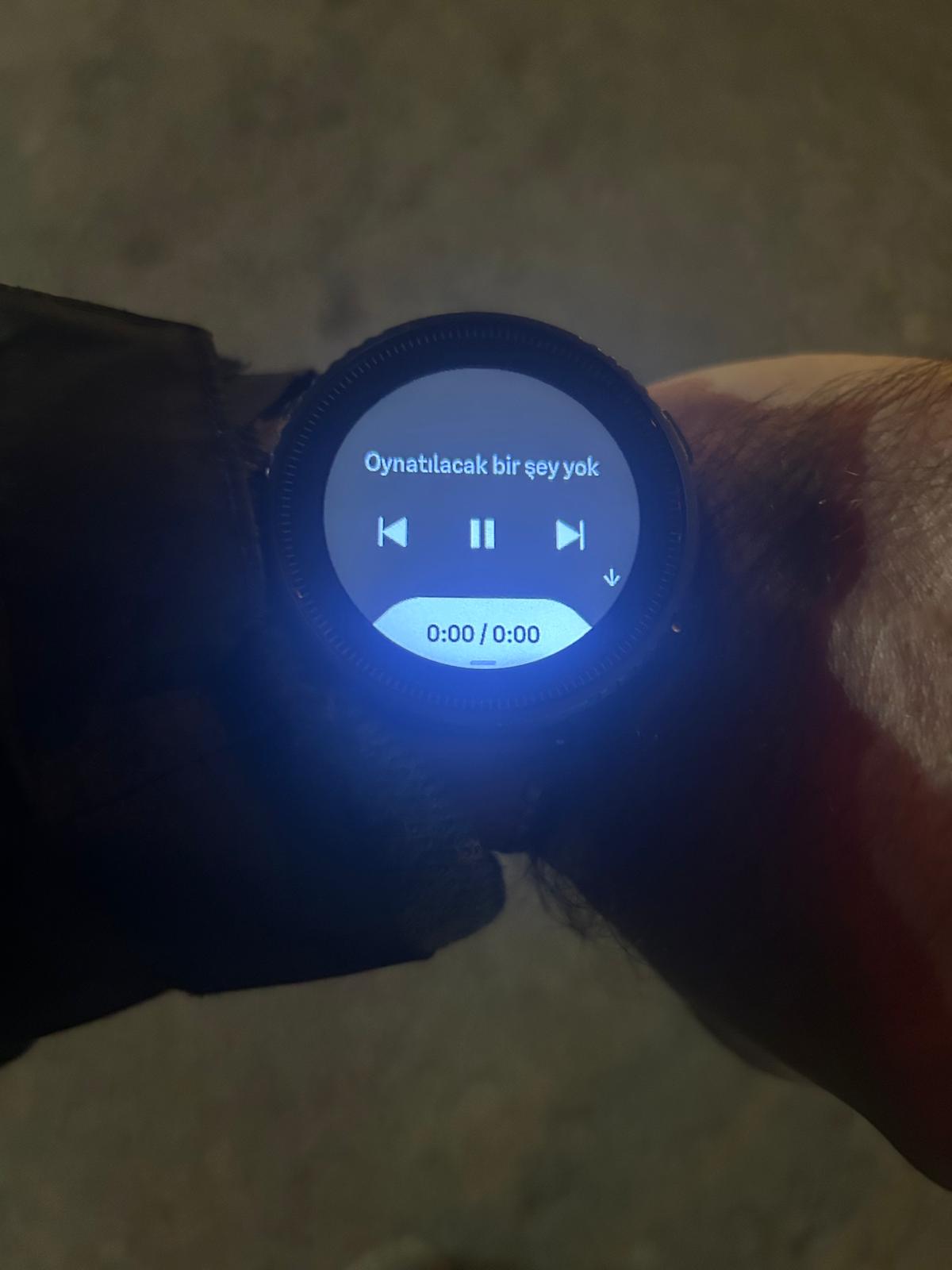

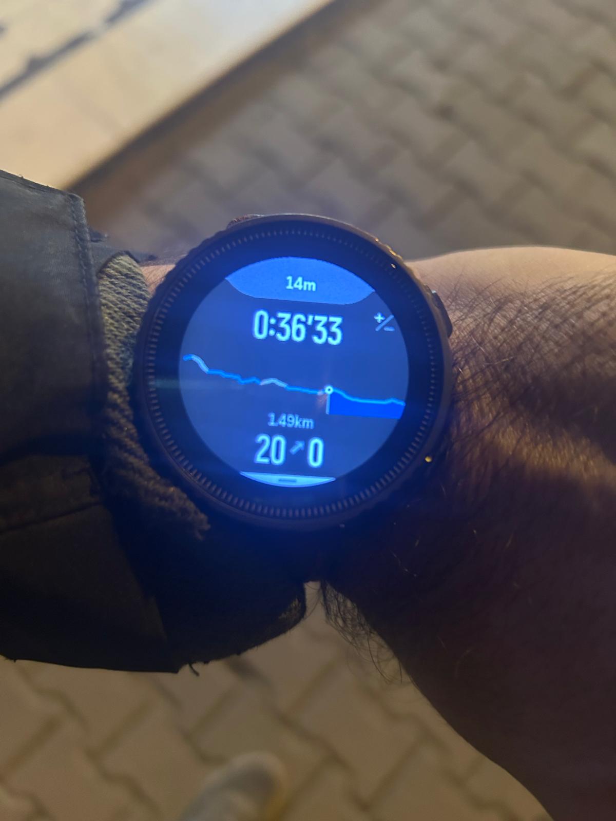

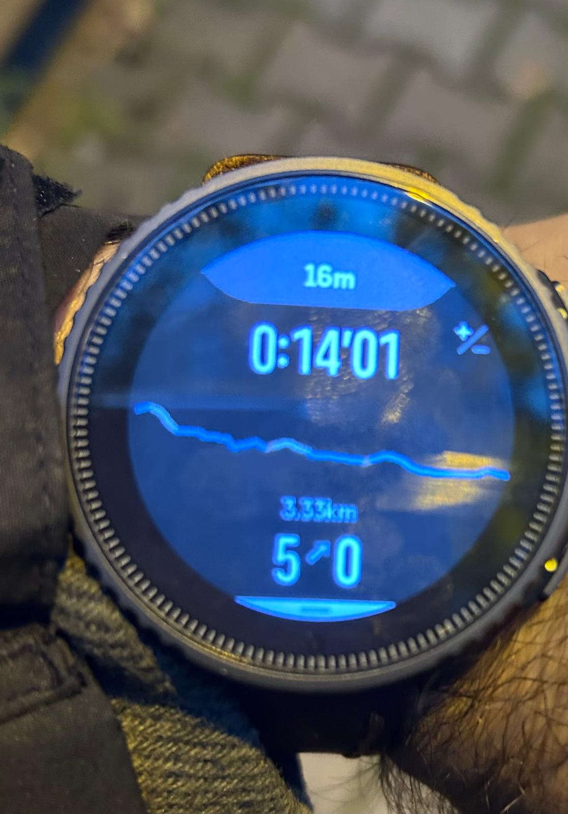

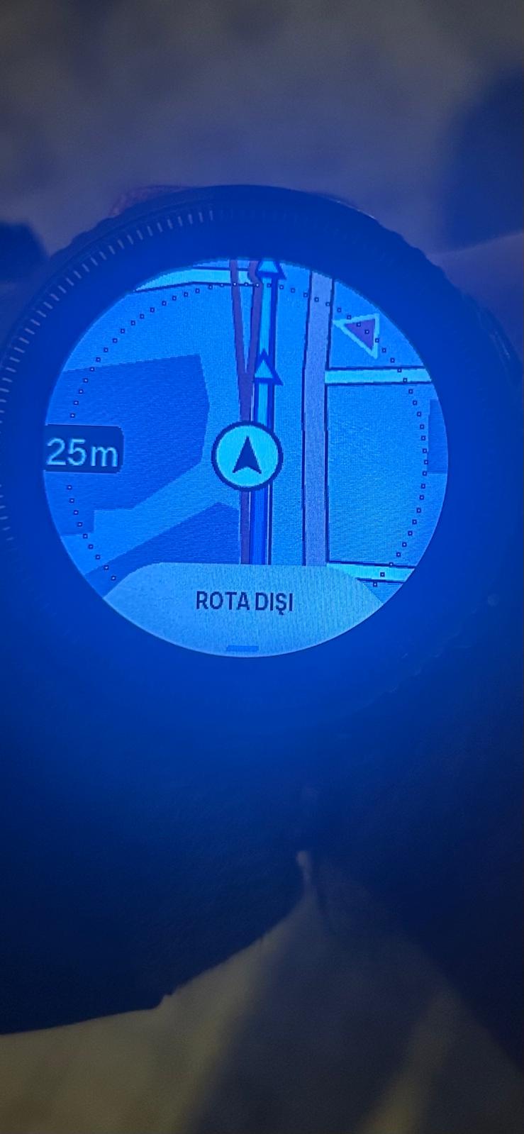

            1. Music control didn’t work with my phone.
            2. It gave me an off-route warning even though I was on route.
            3. I couldn’t figure out the logic behind values ​​like 0 up arrow 15 or 0 up arrow 0.

            • sky-runnerS Online
              sky-runner Platinum Member @safari
              @safari Yes, what you show in the screenshots is Climb Guidance v1. The numbers under the elevation profile are the remaining distances, the amount of vertical change (ascent or descent) in meters completed and the amount of vertical change remaining. The numbers might not make much sense because the terrain is so flat. On a flat terrain, Suunto elevation data is likely to be meaningless.
              I am not sure what is the number at the very top though. It is supposed to be the average slope grade as we can see in some screenshots. But in other case it shows meters. Perhaps that’s the absolute altitude in meters. I don’t recall seeing that on my watch.

              • safariS Offline
                safari @sky-runner
                @sky-runner
                Yes, these are the issues I’m having trouble with, too.
                It’s a track that starts with a descent, continues flat, and then continues with an ascent and descent.
                Sometimes it shows the ETA at the top. Sometimes it shows an angle value.
