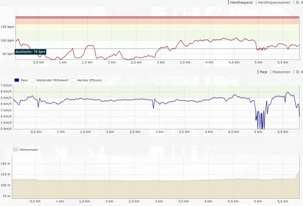

                          This is one of the first recordings, so different Race S than I currently have. Just a walk in the park, no real pace changes, just flat land. In fact the last couple of meters I walked up the stairs to the forth floor in our house. Not reflected in the HR graph…

                            @2b2bff ah, I see - not very steady (looks like Polar’s Webapp?) So it seems that it’s really You and the Race’ sensor being not matching somehow

                              @ChrisA it is Runalyze… yeah, possibly it’s a me problem 😉
