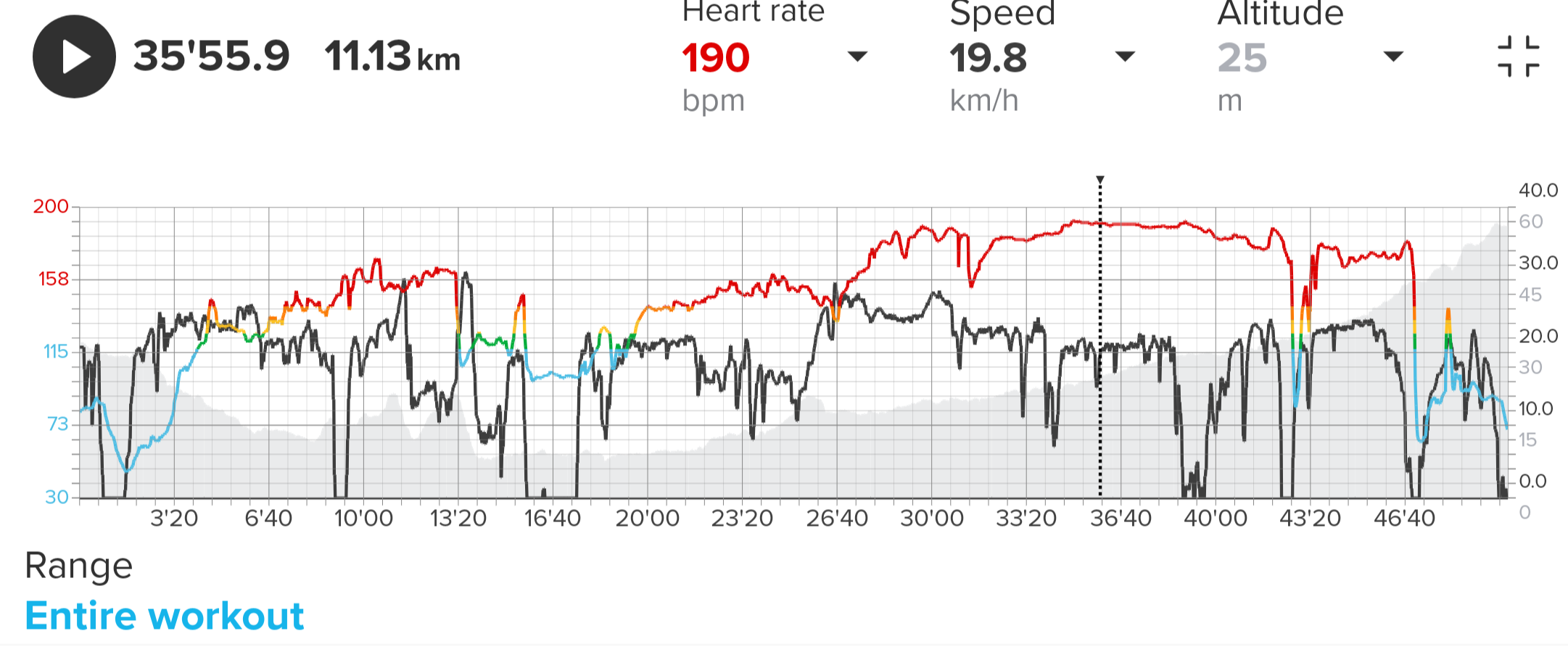

      My max HR is about 165. That didn’t bother my Vertical 2 titanium with nylon strap tight on my arm to register exactly double my HR during an entire low intensity bike ride.

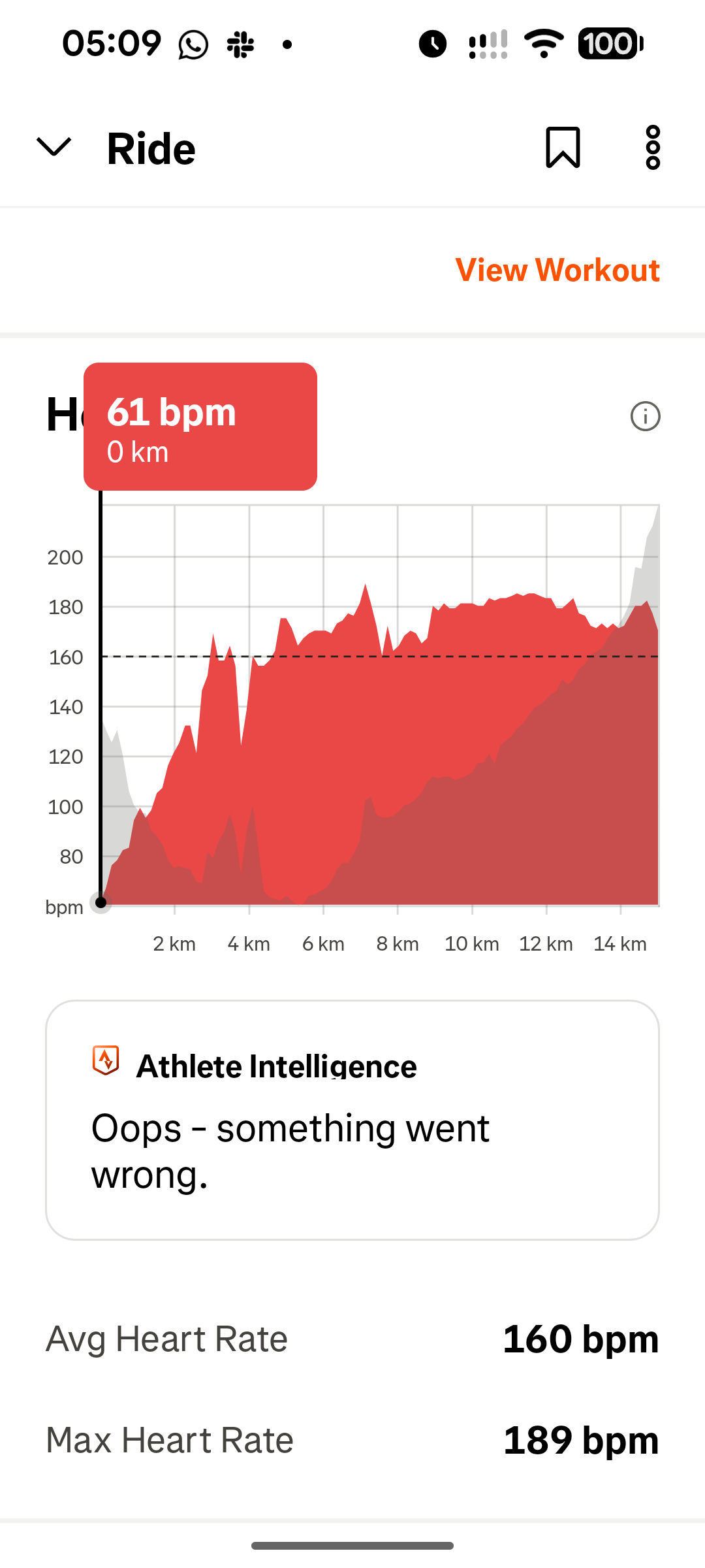

      On the app
      My normal HR is low. You can see it started at about 60 BPM which is correct. Strava AI noticed something was wrong 😄
      Strava AI comment

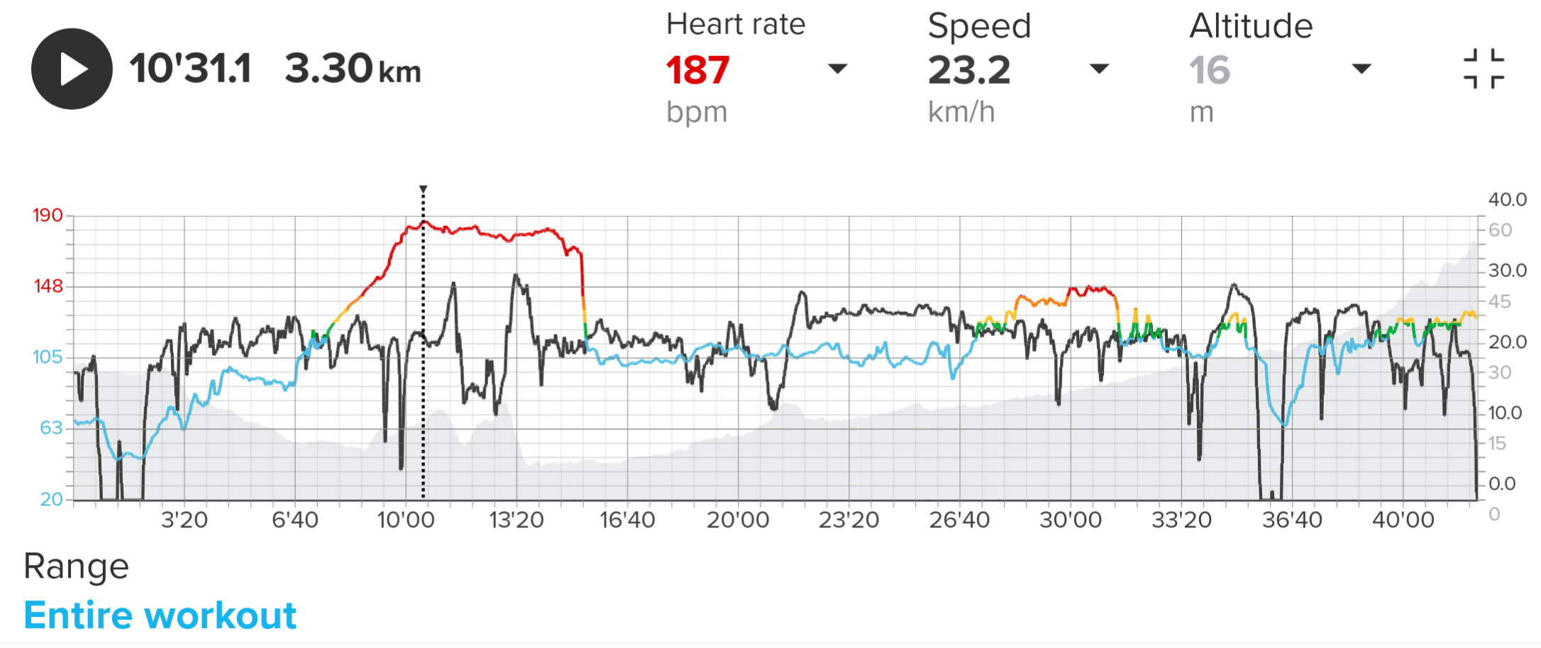

          It happened to me again, this time in the middle of a ride194 BPM should have been 97 BPM

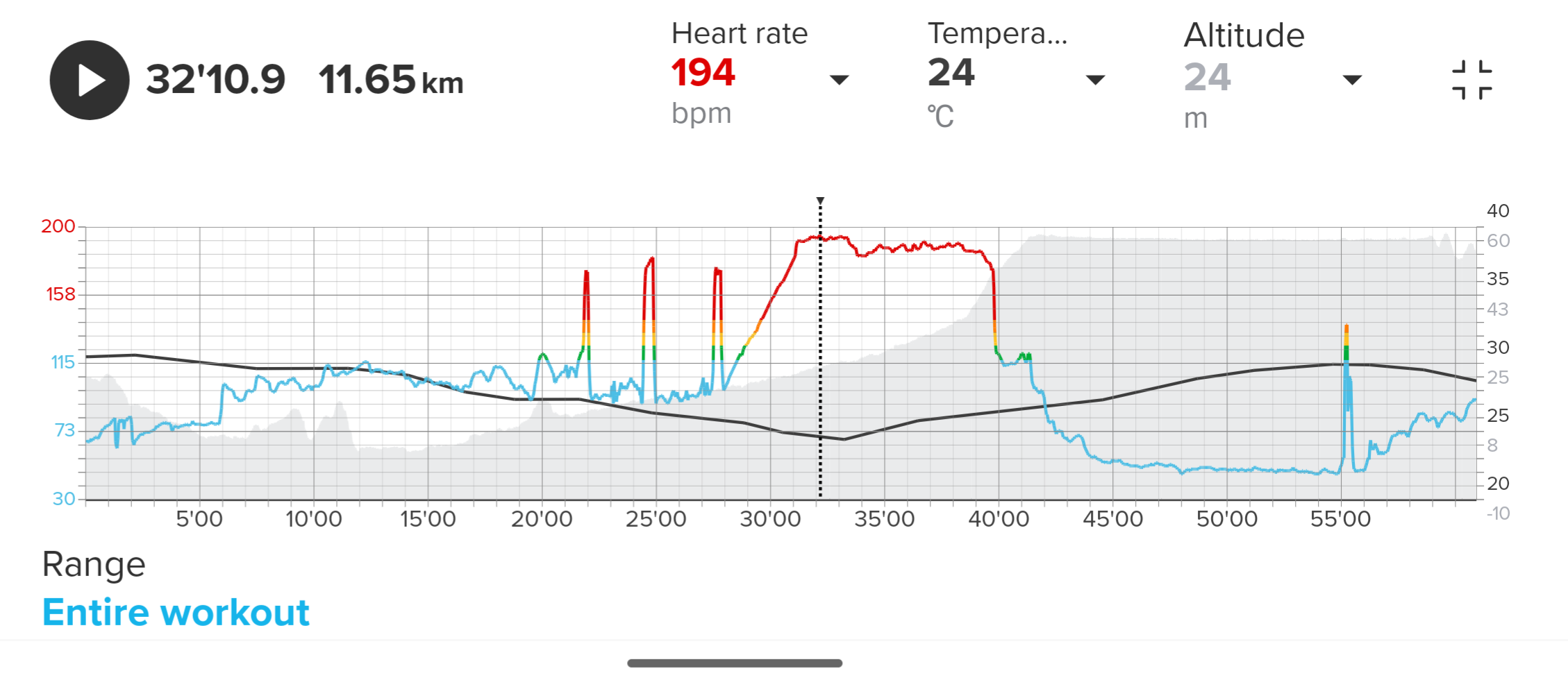

            @Gideon-Kaempfer 1000118231.png again, on the same route yesterday. Cycling with a well adjusted nylon strap. Low speed, nothing bumpy, very relaxed.
            Even during stops at traffic lights the HR remains totally off (double my HR). However, immediately after I finish the activity, the watch jumped back to my correct low HR. As if stopping the activity allowed the sensor to get back to its senses.
            I have had HR sensors on multiple watches for years but this is definitely the worst. Needs quick fixing. It’s not a mere few beats off. It totally distorts any metric based on HR. Makes a very significant part of the watch useless.

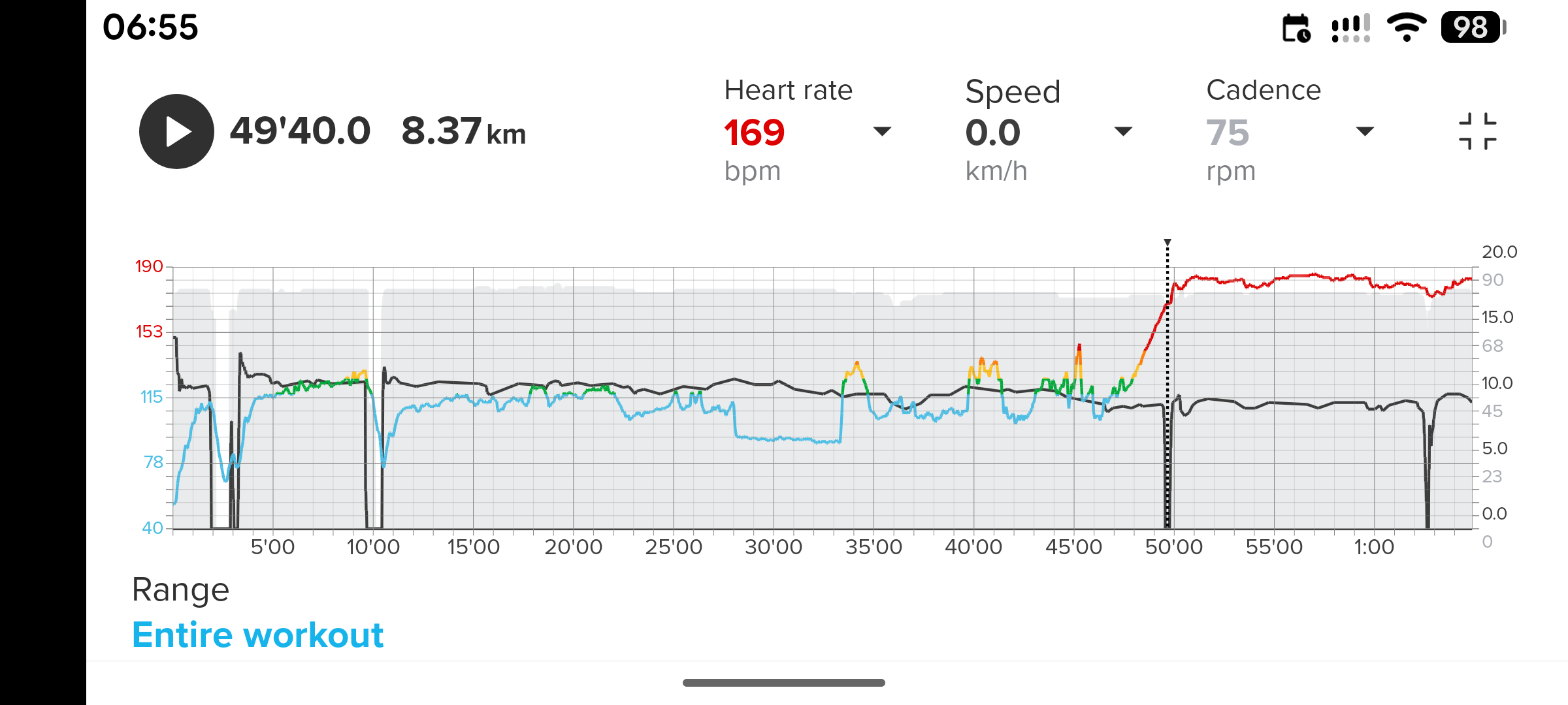

              No improvement after updating to firmware 2.48.16
              My max HR is 165. My real HR was about 100 BPM but it stayed at 180+ for several minutes according to the watch. Same biking commute…
              Very disappointing 😞

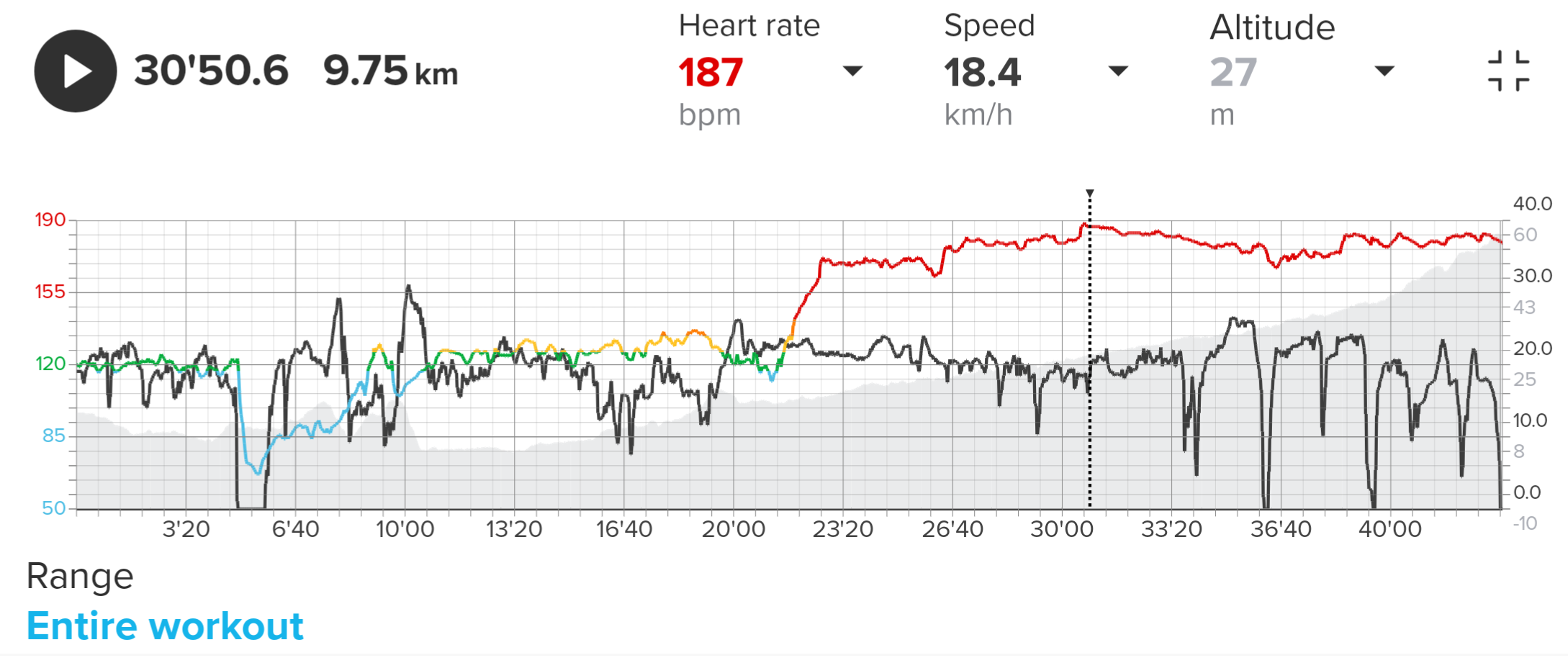

                I thought that I figured out how to adjust the strap for reliable HR during biking (super tight with nylon band) and then this happened (my max HR is 165 🤦):)
                I was riding very calmly, had to stop several times (rain, mud) my actual HR was about 100 BPM but the OHR was stuck high (until I stopped again near the end of the activity)
