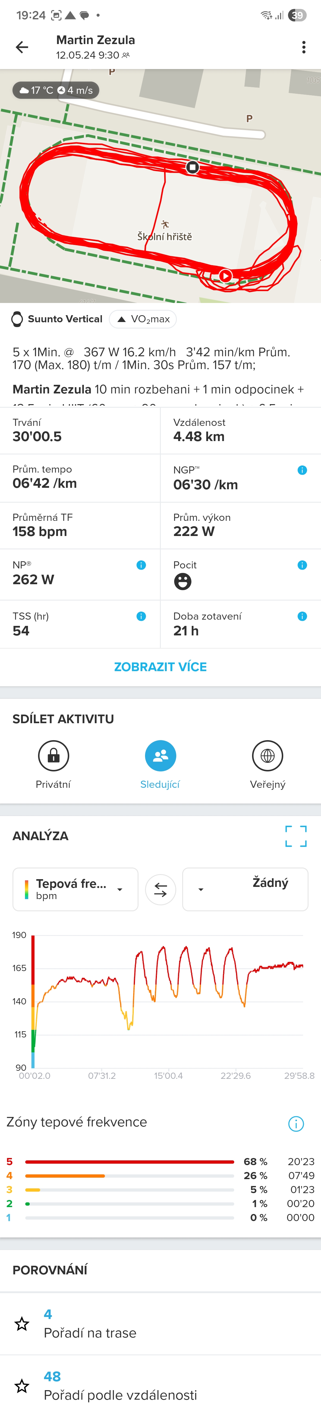

          @Tieutieu Thanks for the information. Yes, I always use the HR belt and how could be seen on the screenshot, measurement of both HR as well as distance (GPS data) during my typical interval training is really perfect - congrats, Suunto! However, when returning to VO2max estimates (I know, exact values must be measured in a lab), values given in a standard way by the watch itself are far from values produced by traditional VO2max approximations presented by various sources / methods, giving, however, similar results (e.g. by Cooper, based on 12 minut run or Balke, derived from 15 min run). Furthermore, when watch gives me a VO2max estimate just based on a slow walk with a pace of 11 minut per 1 kilometer, it seems to me really strange… Screenshot_20251103_192438_Suunto.jpg

                    @MartinZ I think that your numbers are incoherent. According to you Cooper test, your VMA should be around 12.5km/h but you are supposed to do long repetitions at 16.2km/h. And for those repetitions, you are not reaching your HR maximum which is 189 (did you really run at 16.2km/h?). 16.2km/h is 130% of your VMA! No way someone could make 5 repetitions of one minute run/one minute rest at this speed (130% VMA).
                    For example, Kipchoge VMA is 24.5 km/h. So 130% is 31.85km/h. And the world “record” of 500m is 1 minute and the speed 30km/h. Despite being one of the best runners of all time, I don’t think he would be able to beat the 500m world record 5 times in a row with just one minute rest in between.

                        @LGoSo Thank you very much for your info. All the underlying data for my complaint regarding the strange estimation of VO2Max are in the top of this page, on a screenshot with a result of Cooper test on the left side and a table converting distance run at 12 min to a respective VO2 max level on a right side. Screenshot below relates to another running activity (HIIT) and it is just showing that both the key inputs for the VO2 max estimation (i.e. heart rate and the distance achieved were measured with a very high accuracy, in case of heart rate using HR belt). The belt was of course used also in the case of realized Cooper test with data provided on the screenshot on the top of the page, furthermore, this Cooper test run was also made on a straight road and not on athletic stadium, just with an aim to maximaze accuracy of the distance measured. It means, the input data were highly accurate and the problem is just with a calculation / estimation of the VO2max within the Suunto Vertical watch. Cooper test (SuuntoPlus app) shows 44 (which correspond also to other VO2max estimates made by me manually using more different methods), whereas Suunto Vertical general estimator shows 46.1 for the same (!) activity (could be seen on the screenshot as well) and even higher values for almost all other activities I have made. Everything above 44 looks really strange in my case, out of my capabilities.

                          FYI: @LGoSo is completely right. 16,2 km/h or 3:42 is way to fast for you. According to your activity your fastest 1 min time was 4:33 min/km which is slower than 14 km/h
