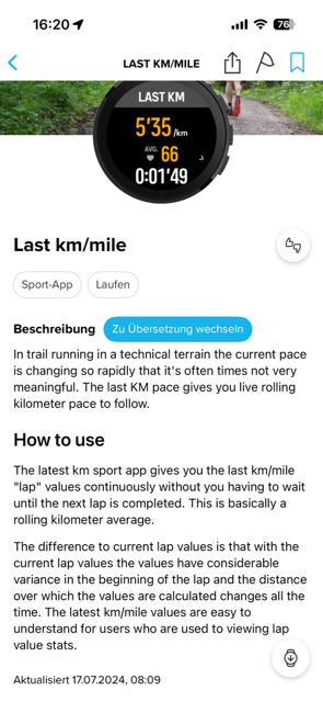

        @Julien-Llr have you checked the “Last km” S+ app?
        2 Julien LlrJ 2 Replies Last reply Reply Quote 2
          2b2bff @Egika
          @Egika this app is great and working even better than Garmin because it is the last km, not the pace of the last 1km auto-lap…
          • Julien LlrJ Offline
            Julien Llr @Egika
            @Egika Thanks for your quick reply. But this S+ app doesn’t take the lap button press into account, and therefore doesn’t show the duration of the last kilometer after pressing the lap button / starting an interval with a guide.
            I want something simple: to be able to press the lap button / start an interval, and then get a notification from the watch 1 km later telling me how long it took to run that kilometer!
            I love the watch, I really wanted to leave the Garmin ecosystem, but this missing feature (which is incomprehensible to me) is going to force me to go back.
