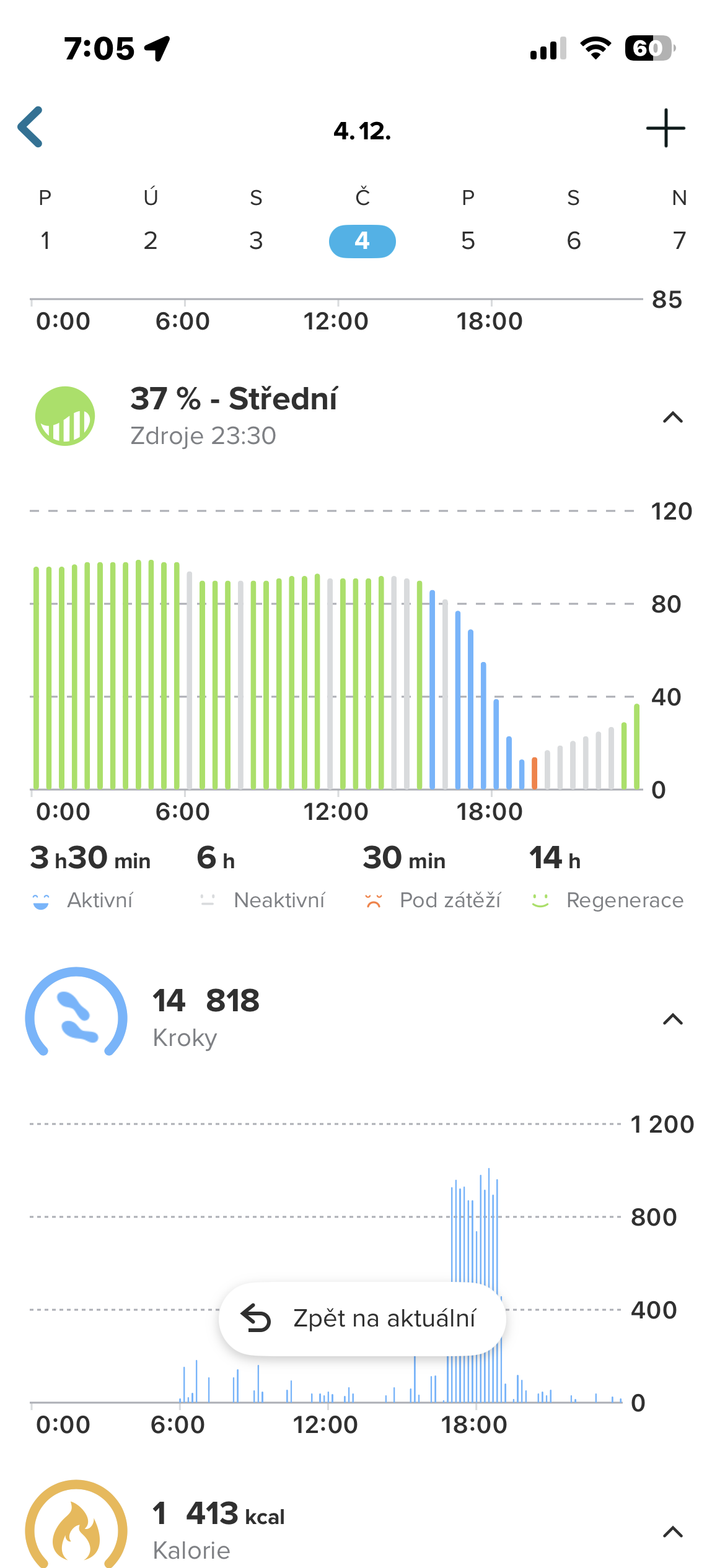

                      I went cross-country skiing for 2 hours. Average HR for 2 hours was 149bpm (H10 strap). Resources went down pretty quickly (finally 😀 ) but i don´t understand red stripe - under load, this was 45 minutes after activity and it is bigger than blue one before it, so resources are going up when I am under load?? Strange
                        jannis Bronze Member @PetrMisek
                        @PetrMisek But if you look, the graph perfectly shows the problem. One could think, not knowing, that you slept from midnight until 5 PM the next day. It is not helpful at all. Also, why does the axis show 120 percent? Is this another bug by Suunto? And then again, right after the activity, there is a rapid rise in the resources.
