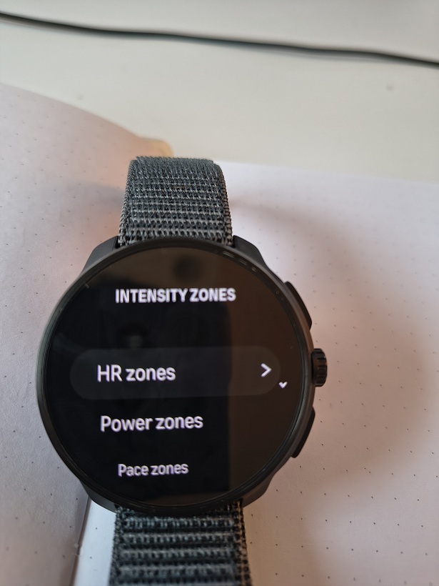

      I wanted to set my Pace Zone 2 as a target in the Intensity Zones Option of the Exercise Options of the “Runnung - Basic” Sport mode (this is happening in all running modes though), when I noticed there is no “Pace Zones” and only HR and Power zones:

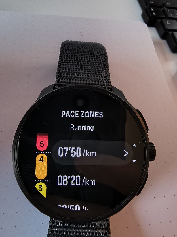

      I have set my Pace Zones in settings > training > etc… for running like this:
      I then did a soft restart (pressing upper button 10s). The Pace zones were reset to the watch default (which shouldnt happen btw!), but at least “Pace Zones” were back as an option:
      However, whe I readjusted the pace zones to my personal pace zones again, the option disappeared again in the sport mode “Excercise Options” > “Intensity Zones” settings! It is quite bad, this way you can’t easily train by pace zones, which really impacts the useability of the watch!
      Has anybody else noticed this? I would assume this is rather a software/firmware error than an error by my watch itself.
