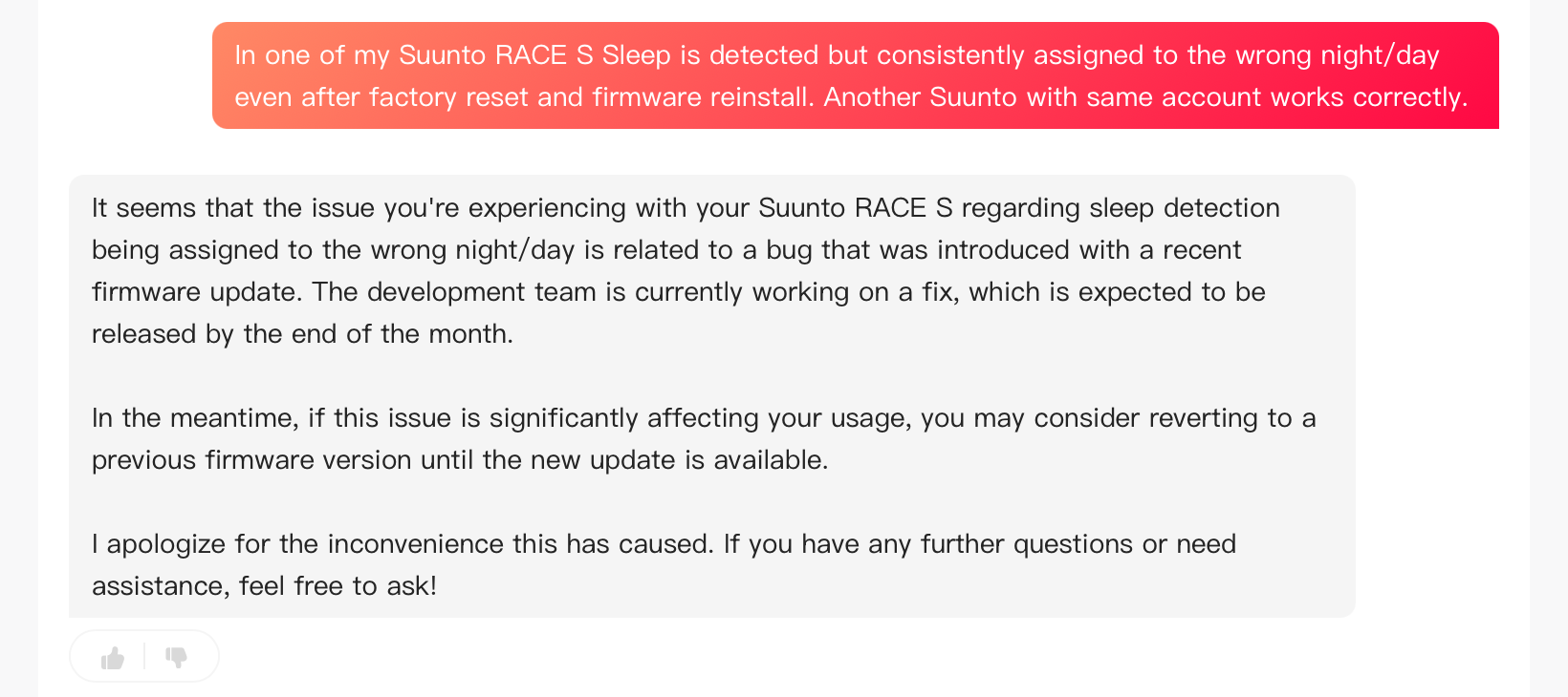

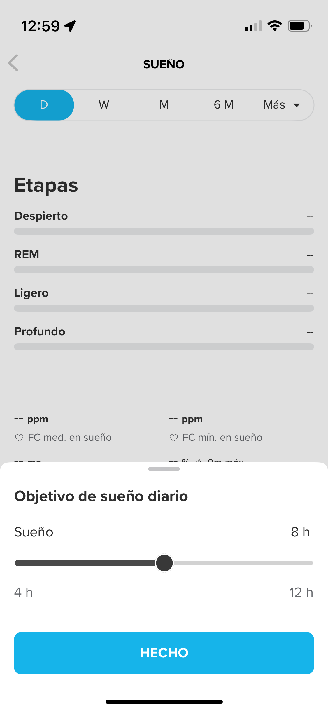

      It turns out that for the last nights, the sleep widget on my watch shows sleep data from two nights ago, not for the last one night. As a result, the morning report isn’t showing up.
      It’s strange because the sleep tracking seems to be working fine, as the data in the app (both iOS iphone and ipad) and is accurate and up-to-date.
      Any advice, tips, or suggestions? Thanks

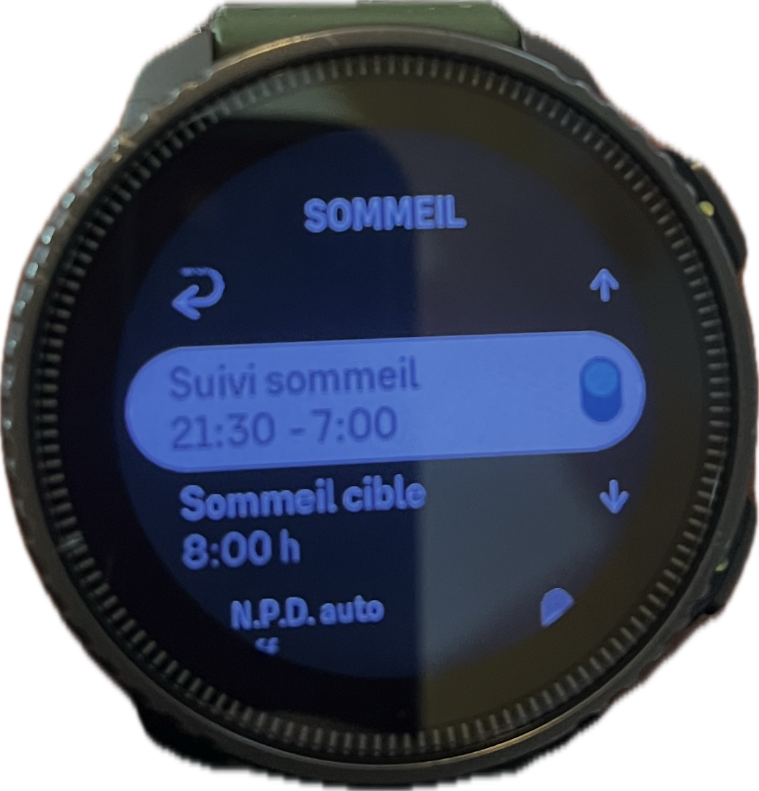

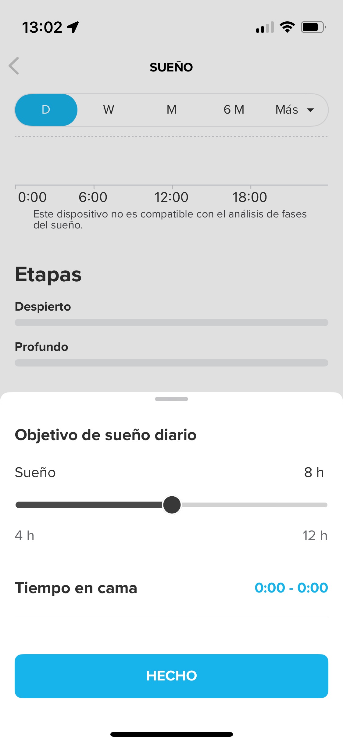

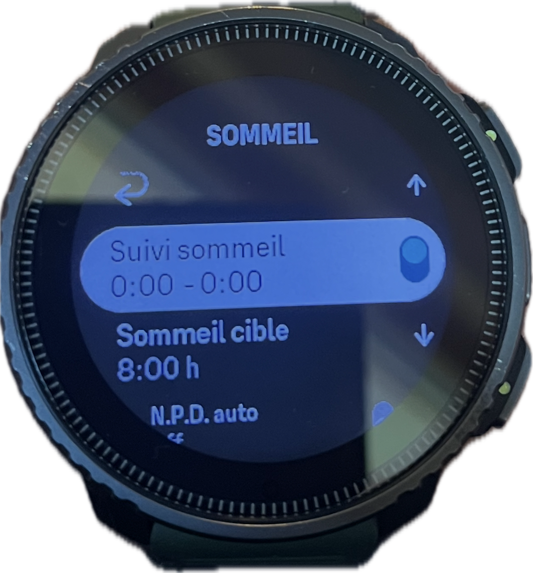

        Well, a soft reset didn’t work. Neither did disabling and reactivating sleep tracking. Not even leaving a “blank” night. Nothing. The watch is still recording sleep data as it did on the “gap” of two nights ago. This means there’s no morning report, and the watch indicates no sleep tracking. However, the app correctly records both sleep and HRV data. 🙄
        Today I reinstalled the OS as a further measure to see if it fixes the problem (with the consequent loss of some custom sport modes; ugh).
        Has anyone else experienced this?

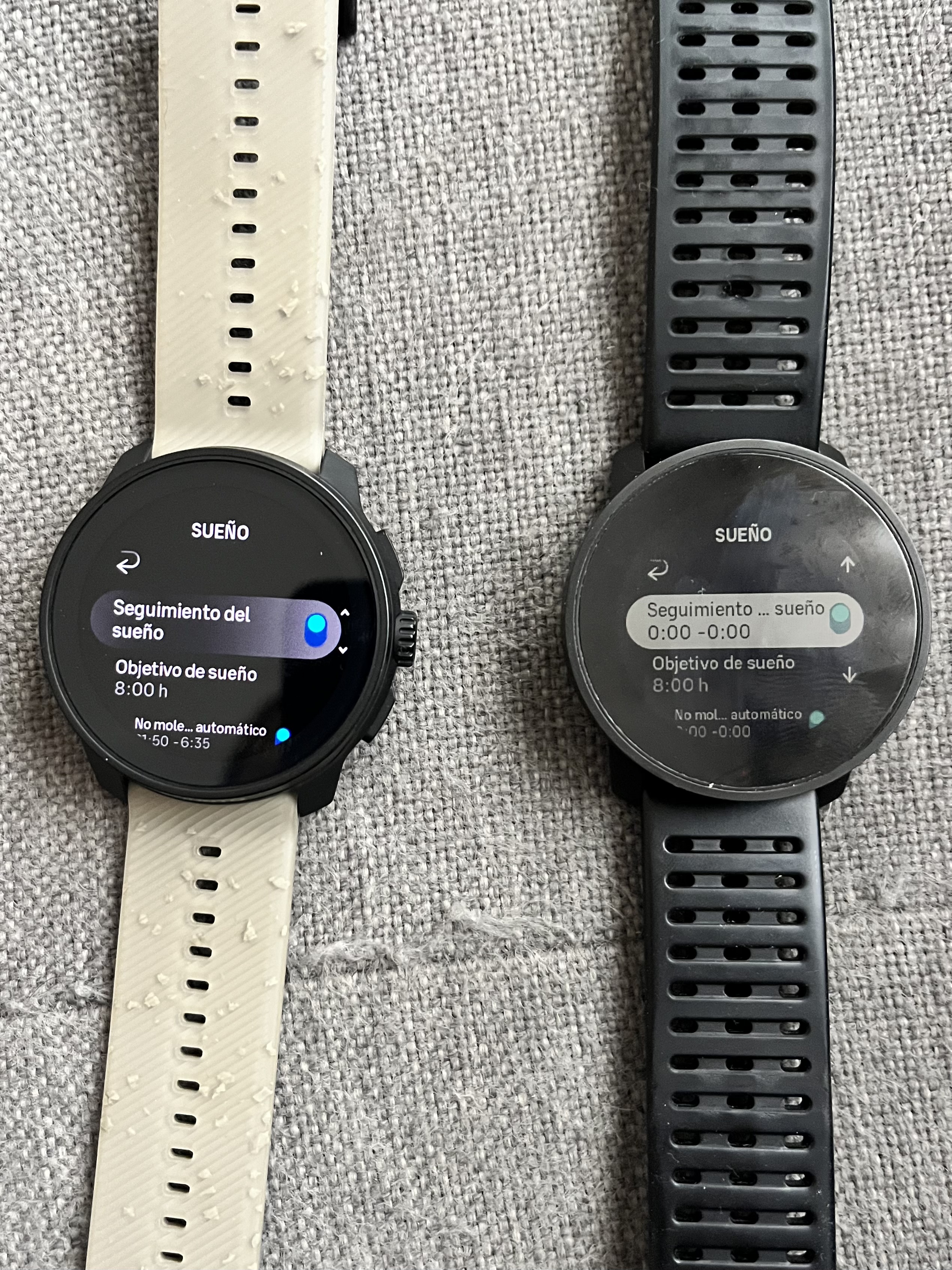

                  What a S**T! Yesterday I did a HARDWARE RESET as a last resort… and nothing was fixed: the watch must be recording sleep correctly because the app records it correctly, but the watch says “no sleep tracking” 😤
