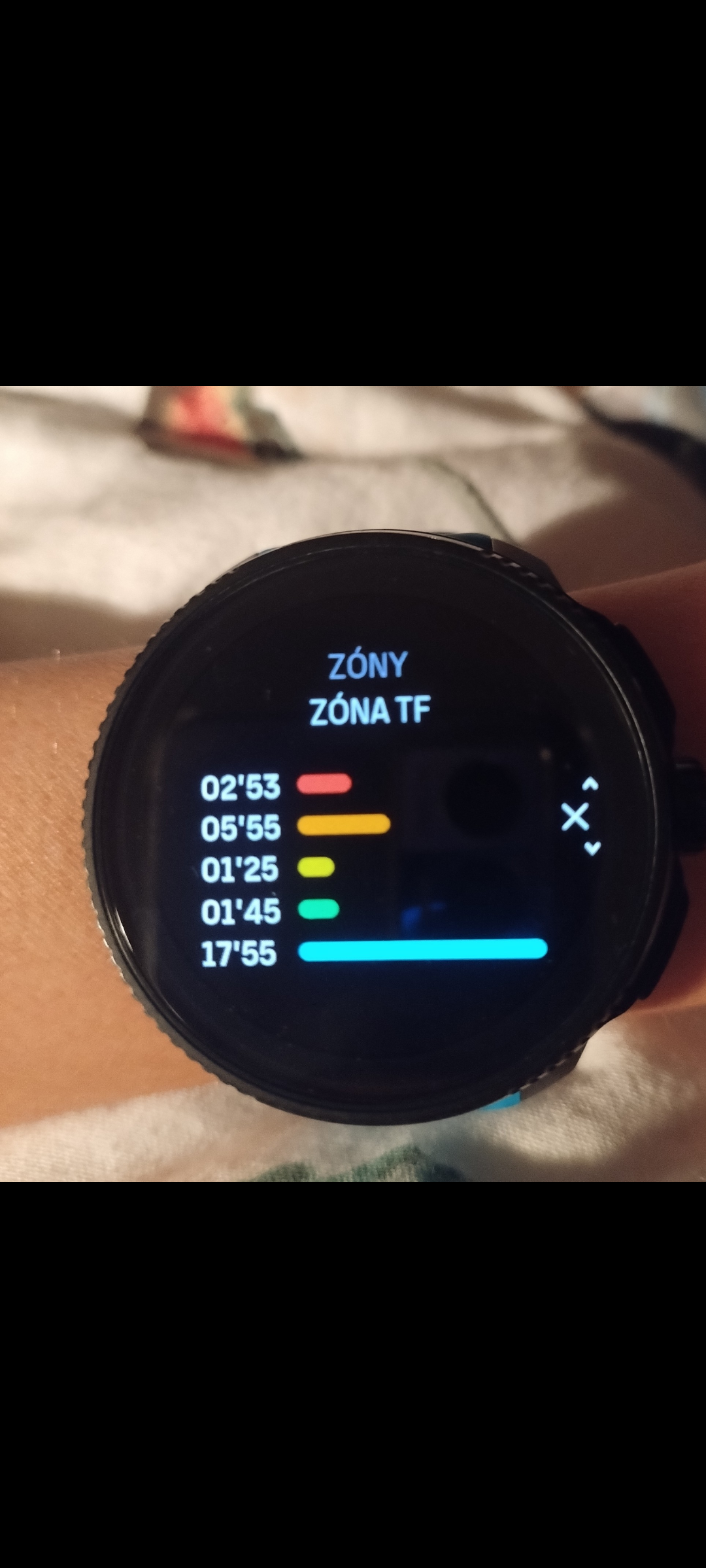

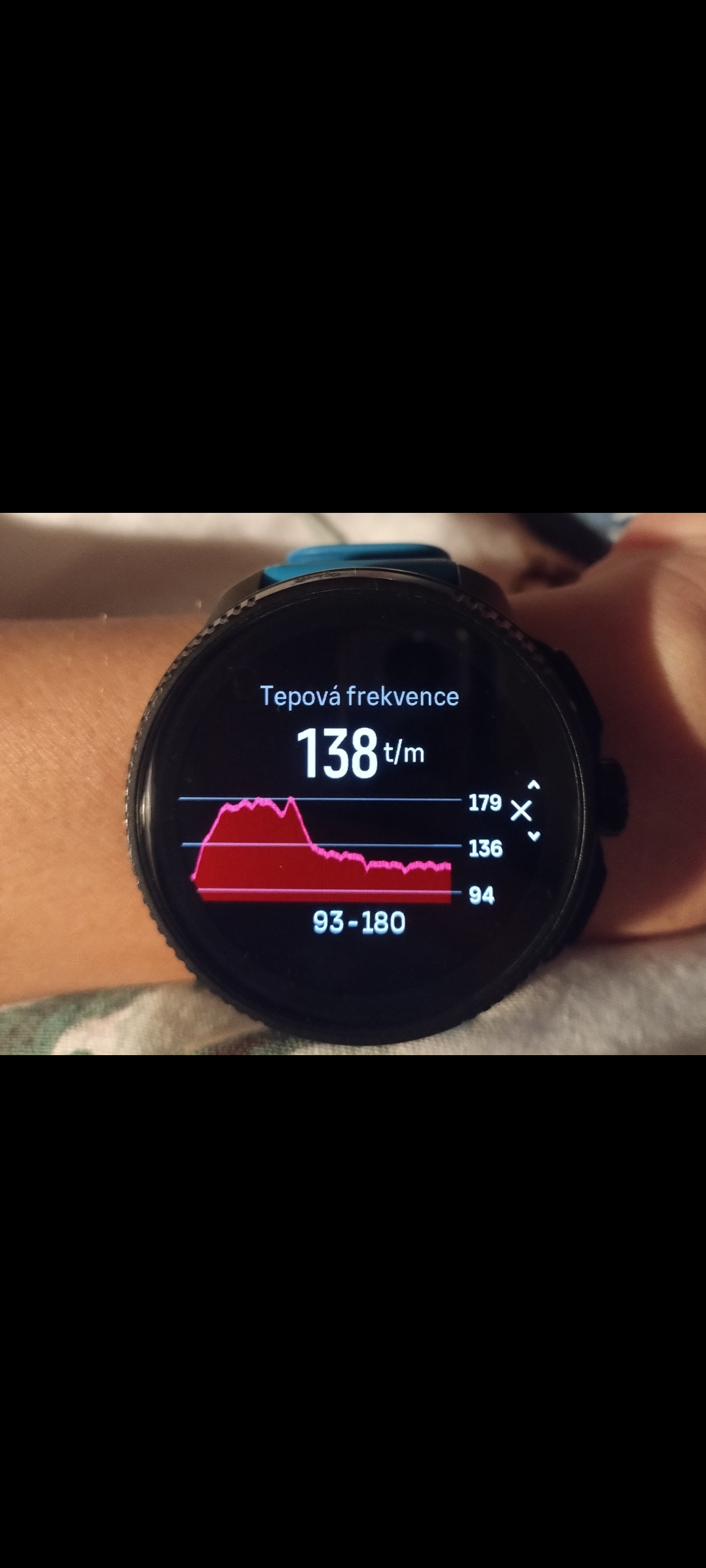

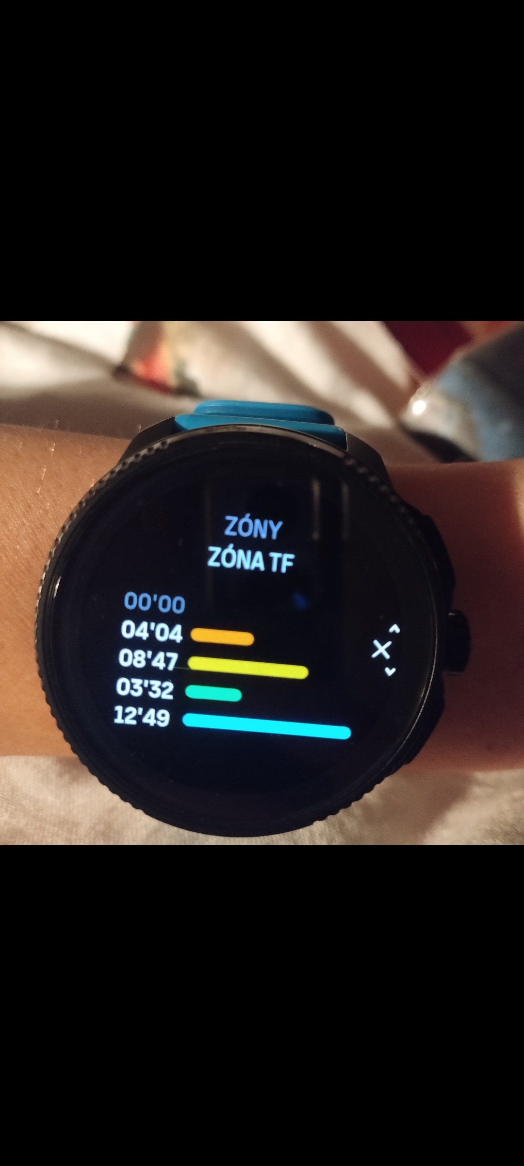

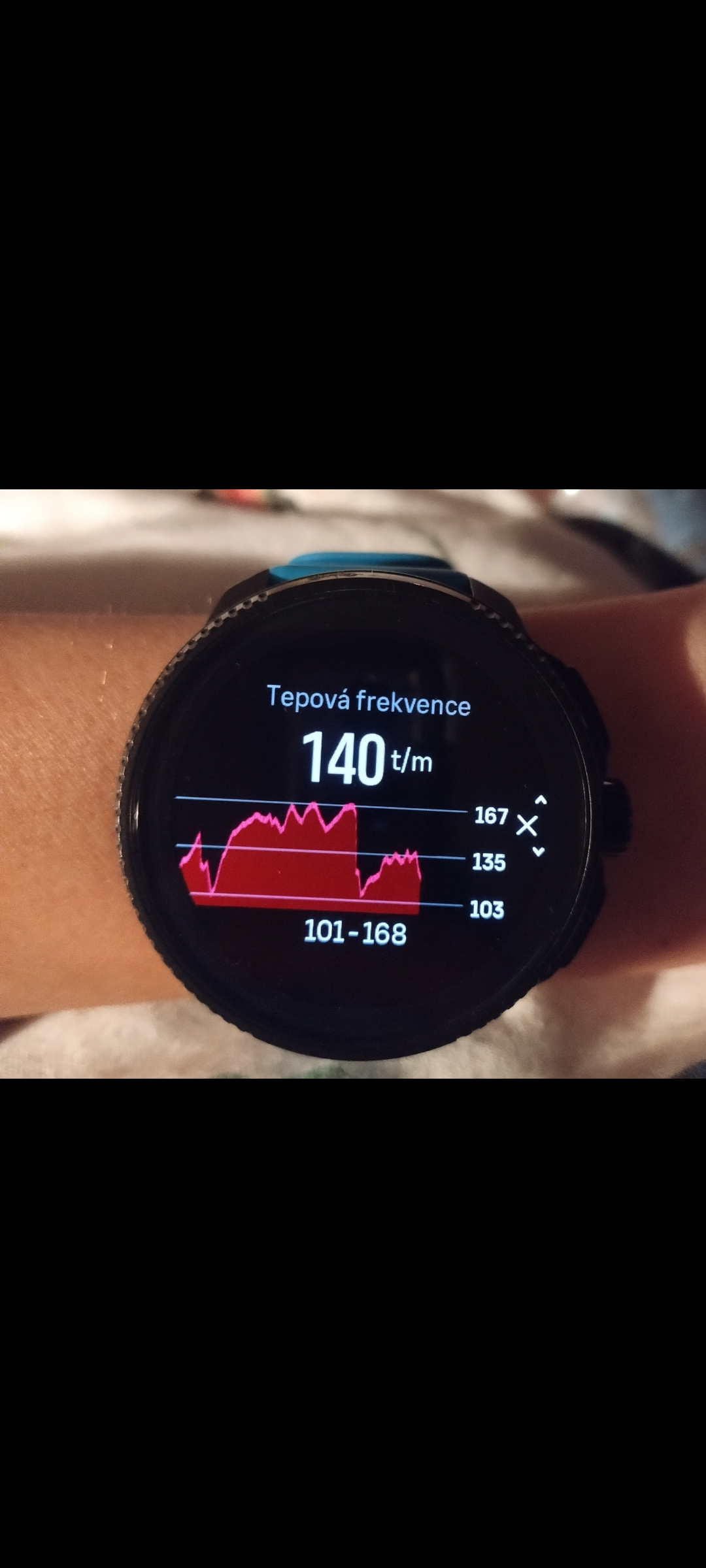

      corrected OHR on Race 1? I walked twice today. In the morning to work in the afternoon back home. I tested the improved OHR and I can say that it is a disaster… I attach photos. I have never had such fluctuations in heart rate while walking. Yes, it happened that it flew up here and there for about 2-5 minutes to a heart rate of 170 and then it dropped back down nicely, but after this update it is a complete tragedy. Does anyone have a similar experience?

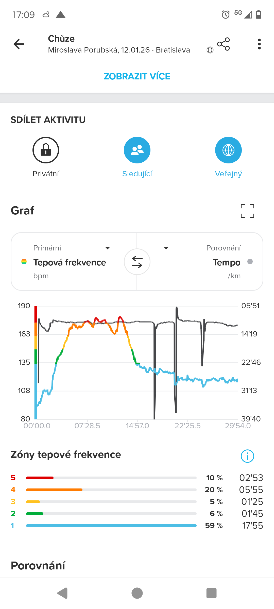

              @Egika here is screen1000021777.png from my app
