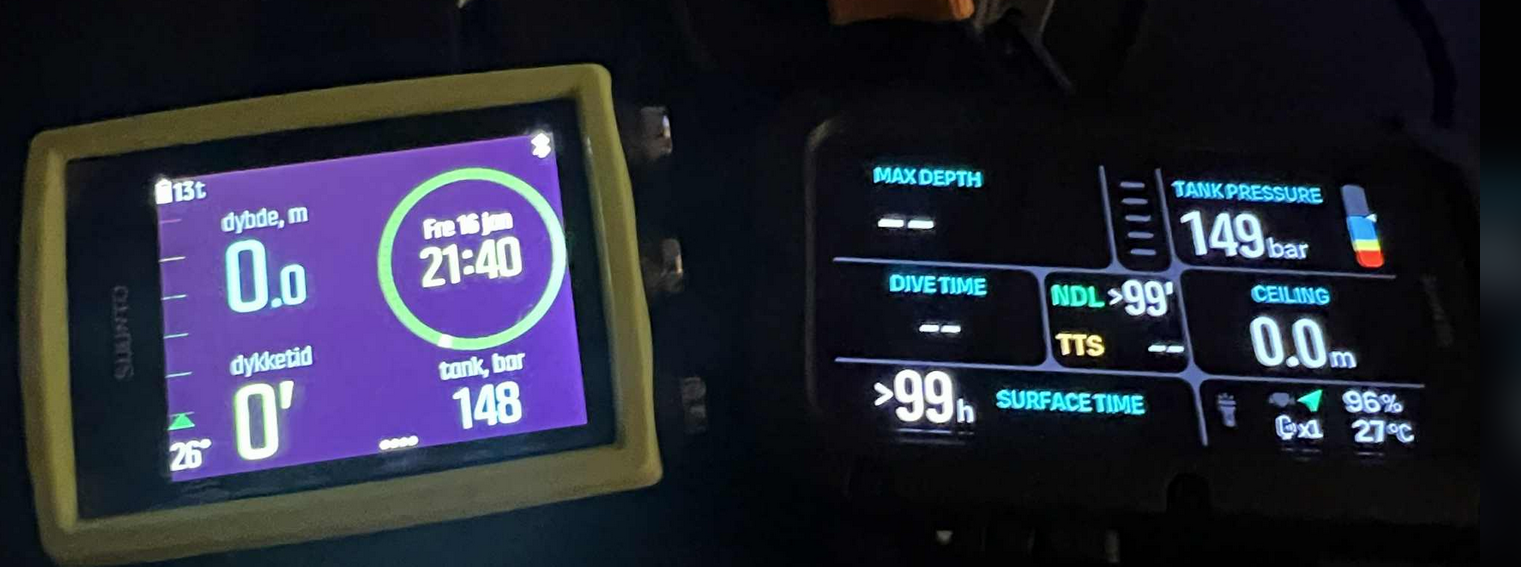

          I tried To make some tests yesterday…
          It seems that the EON “wins” i the POD is registered on both devices…
          The Nautic then updates very slow and ends op concluding that the power is low on the POD and stops reading the POD. EON just carries on but slow…
          This is a issue that the developers has to look at… and best fix it, so two computers can be connected simultaneous. Else the Nautic “loses the POD game” when an EON is turned on and knows the POD.
          First in the case where the POD is removed from the EON the Nautic starts to behave “normal”.
          Readings (and SAC): It seems that the Nautic consistently measures 1 bar less than the EON, from the same POD. This might be and issue for the developers.
          I guess that I have to make my own log converter from Suunto App to DM5 for the Nautic.Nautic Eon Bars.png

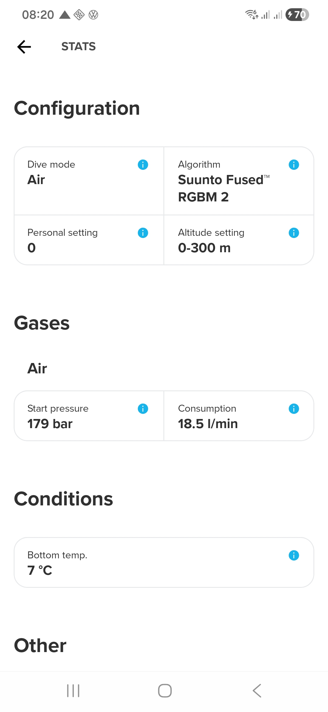

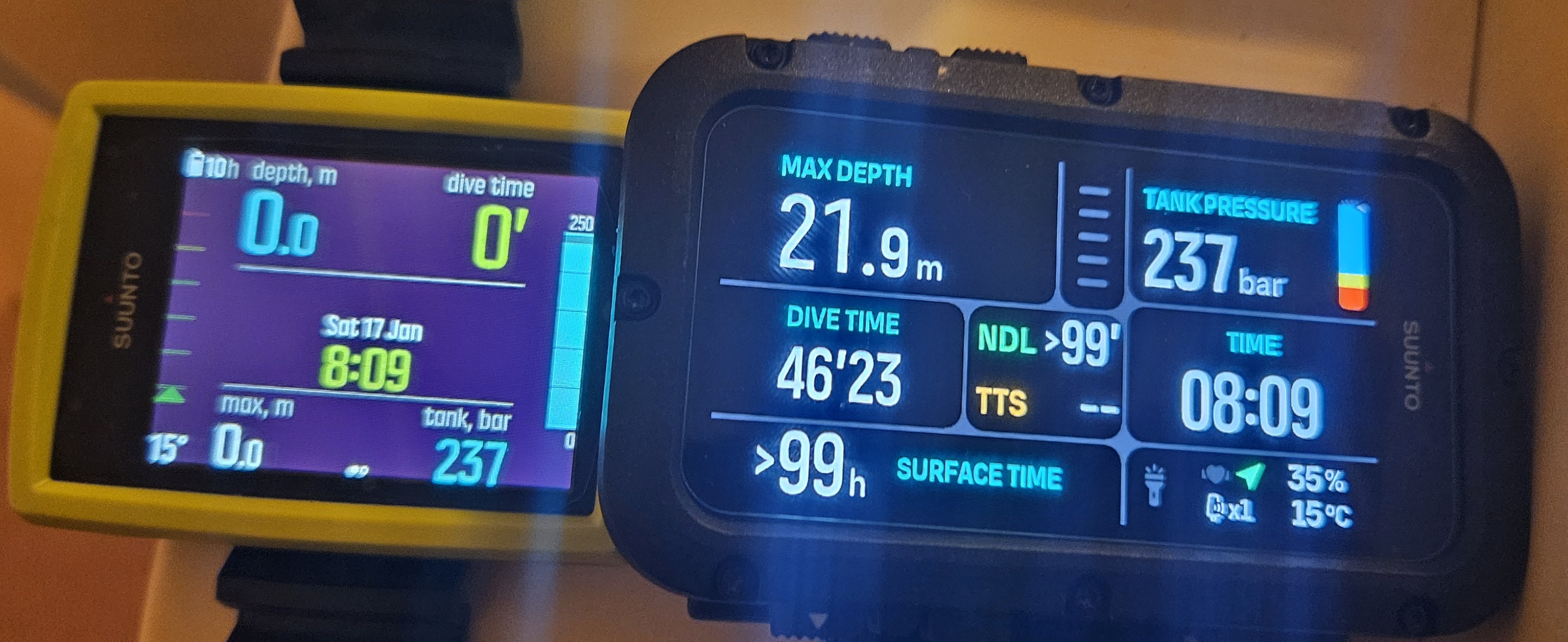

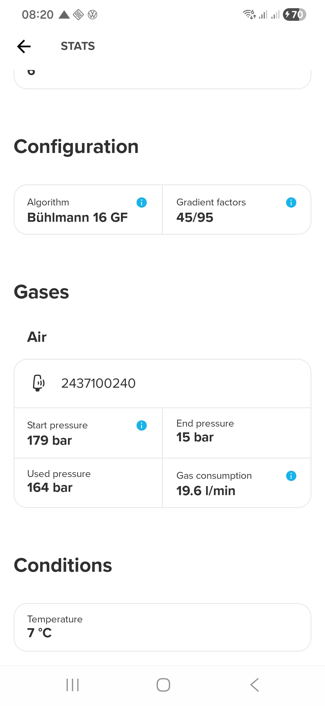

            Yes diving together with the Suunto EON Core and Nautic works fine. The Suunto App only allows one Dive Computer active. For Diving, the Pod simply transmits the signal and both dive computers have all the dive information available throughout the dive. I especially use them both to compare the Buhlmann vs Fused RGBM differences as buddies are diving with the EON. But differences in pressure is not what I see, the only thing is a difference in Bottom times that is related to the tables and conservatism settings and the SAC which is higher in the Nautic.20260117_081000.jpg Screenshot_20260117_082000_Suunto.jpg Screenshot_20260117_082016_Suunto.jpg
