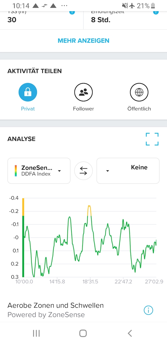

      tom_vertical
      Zone Sense shows wrong values in the “info menue”. The analysis looks relistic but the values on the left are a bit mysterious.
      2 herlasH V 3 Replies Last reply Reply Quote 0
        2b2bff Silver Members @tom_vertical
        @tom_vertical aren’t the values on the left the values that you set your HR zones to? But yeah, how could you have set them over your max HR in the first place?
        Usually ZoneSense adds the detected LT1 and LT2 values on the right side of this page, if there are any…

          @2b2bff this must be an error, as you said you cannot set HR above max HR.
            2b2bff Silver Members @OutdoorMan
            @OutdoorMan I think you can set max HR really high, adjust your zones and then set max HR correctly. The watch will ask wether you wanna reset your zones what you can decline. Judging from the rest of the software quality I doubt this procedure will be prevented.
            But why would you wanna do this? Just for fun and giggles?
            Garmin Epix Pro
              OutdoorMan Silver Members @2b2bff
              @2b2bff yeah but 240 is the max, not even close to 9k 🙂 I think zone sense went nuts.
              SportsfreundS 1 Reply Last reply Reply Quote 2

                  herlas Silver Members @tom_vertical
                  @tom_vertical gigantic numbers are not even ZoneSense data 😉 those are you current HR zones values, there’s a bug on the Suunto app that it needs some x mins sometimes to display your hr zones numbers but after that it displays fine 🙂

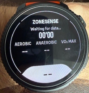

                      I’m having trouble with the ZoneSense app. I followed all the setup steps from the video (https://www.youtube.com/watch?v=r16TgEiGZTM&t=1s) and used an external HR sensor. However, even after an hour of running, I’m not getting any data. Could this be related to the sensor I’m using? I’m using a Polar Verity Sense (an optical forearm sensor) instead of a chest strap like the one shown in the video. Has anyone tried this specific setup, or is a chest strap mandatory for ZoneSense to work?
                      Garmin Vivoactive 5 | Garmin Epix | Garmin Fenix 8 | Suunto Race S | Suunto Race 2 | Suunto Vertical 2
                      SquirrelS Mff73M 2 Replies Last reply Reply Quote 0
                        Squirrel Silver Members @tuxbuster
                        @tuxbuster said in Zone Sense - wrong bpm values:
                        Yes, chest strap with R-R data is needed.
                        tuxbusterT 1 Reply Last reply Reply Quote 3
                        • Mff73M Offline
                          Mff73 @tuxbuster
                          @tuxbuster
                          And polar verity sense doesn’t provide R-R data.

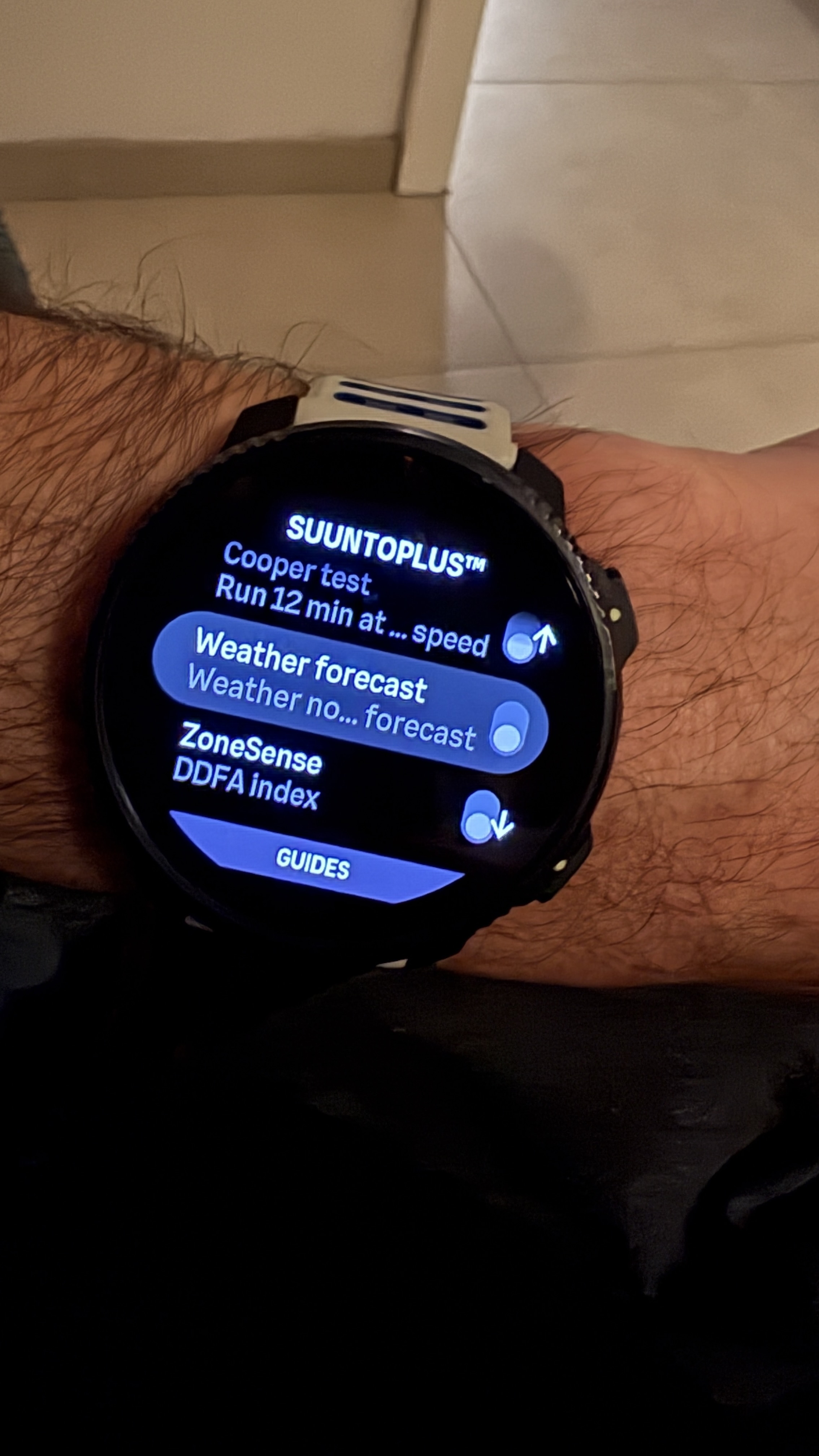

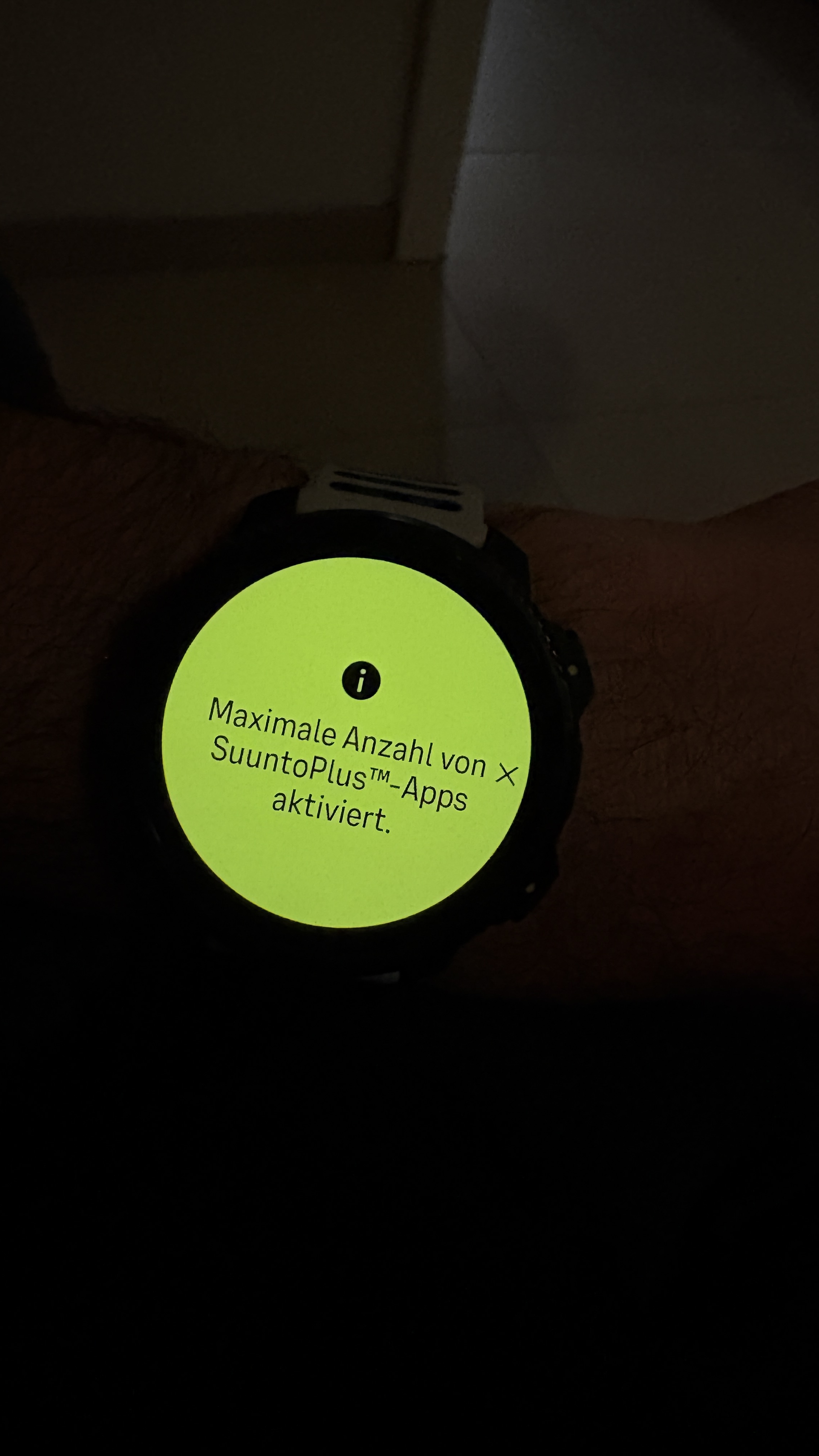

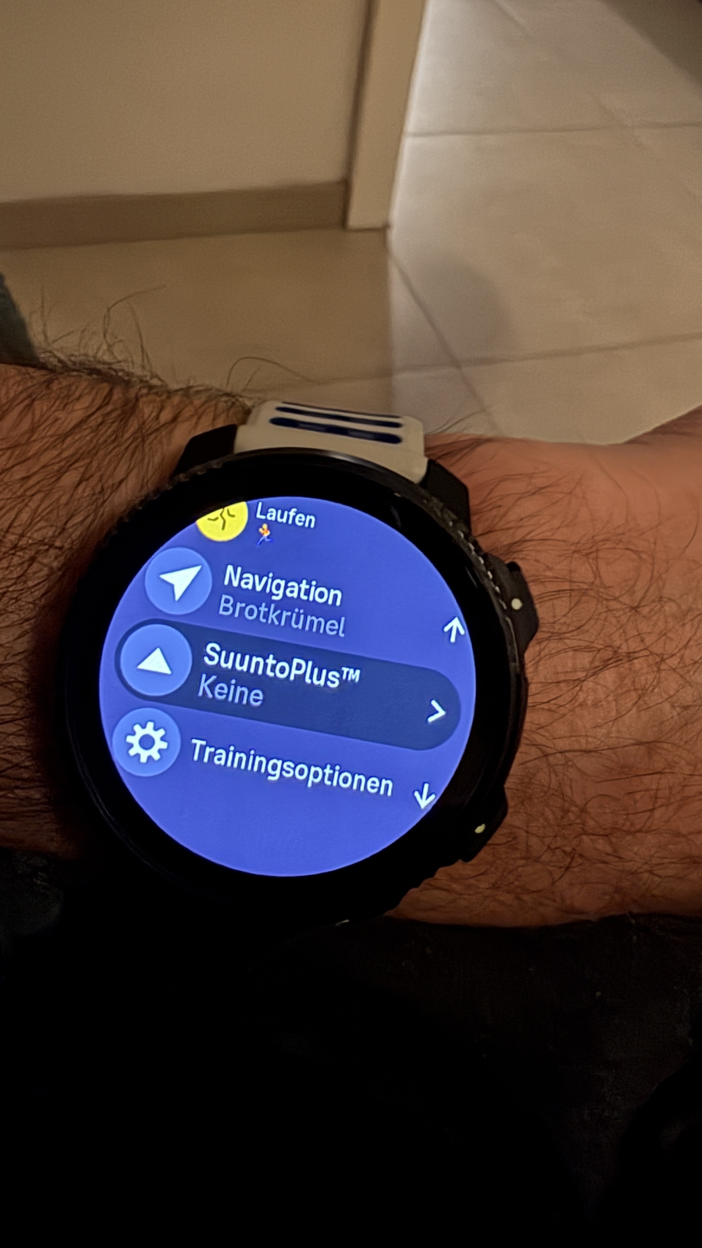

                                My Vertical 2 shows “no apps activated” in my activity log. When I try to activate Zone Sense, I get the message “maximum number of Suunto apps activated”. Are you experiencing this problem too?
                                • SportsfreundS Offline
                                  Sportsfreund Bronze Member @Sportsfreund
                                  690b6b9b-89a0-41d1-bc1c-336abb72c51e-image.jpeg f3b70231-57e0-428f-9cf0-d1a39b67ba59-image.jpeg b926cd48-ec2e-47b1-95d6-50978d89675f-image.jpeg
                                  SportsfreundS OutdoorManO 2 Replies Last reply Reply Quote 0
                                    I can not activate apps.
                                      OutdoorMan Silver Members @Sportsfreund
                                      Have you tried to restart the watch?
