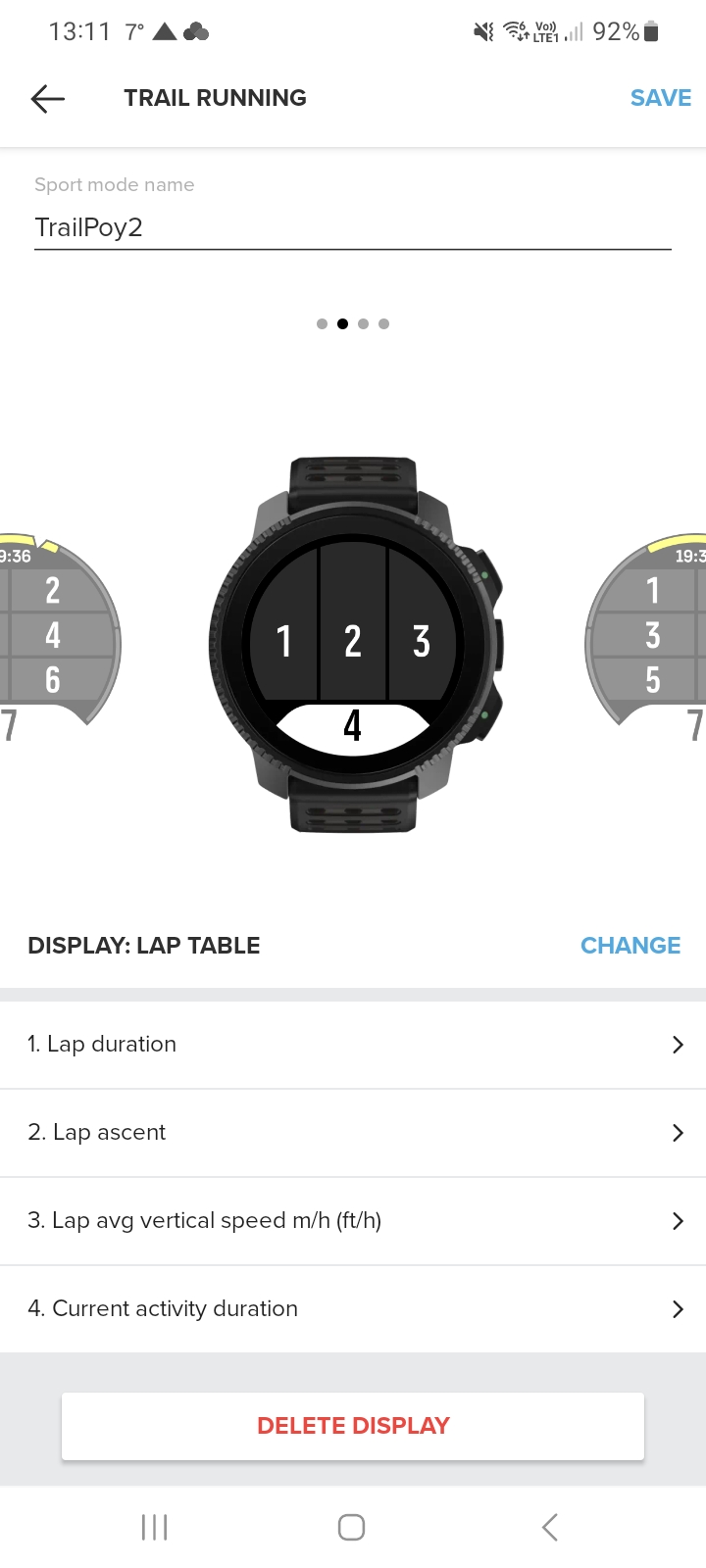

      Hi, i just got a Suunto and im trying to know if is possible to display the laps during the exercise, i use it in the gym among others and i need to se how much time passes since i press the button to control my rests i cant figure out how to do it. i get the notification of new lap, but no way to display the info in the screen in real tiem.
      I need to create a new lap, or loop or whatever. What i need is to register the excercise as normal, but whit a screen to display a crono or lap each time that i finnish a round and press the button, or something similar to this. Thanks

        You can create a customized sport mode and add a lap screen
        You will see 3 (or 4) last laps.
        It is not scrollable to see all laps history (you will see this history at the end of the activity)

          @J120R522 In case you didn’t know, there is Gym timer S+ app.

            Or create a custom sports mode and simply add Lap duration field.
