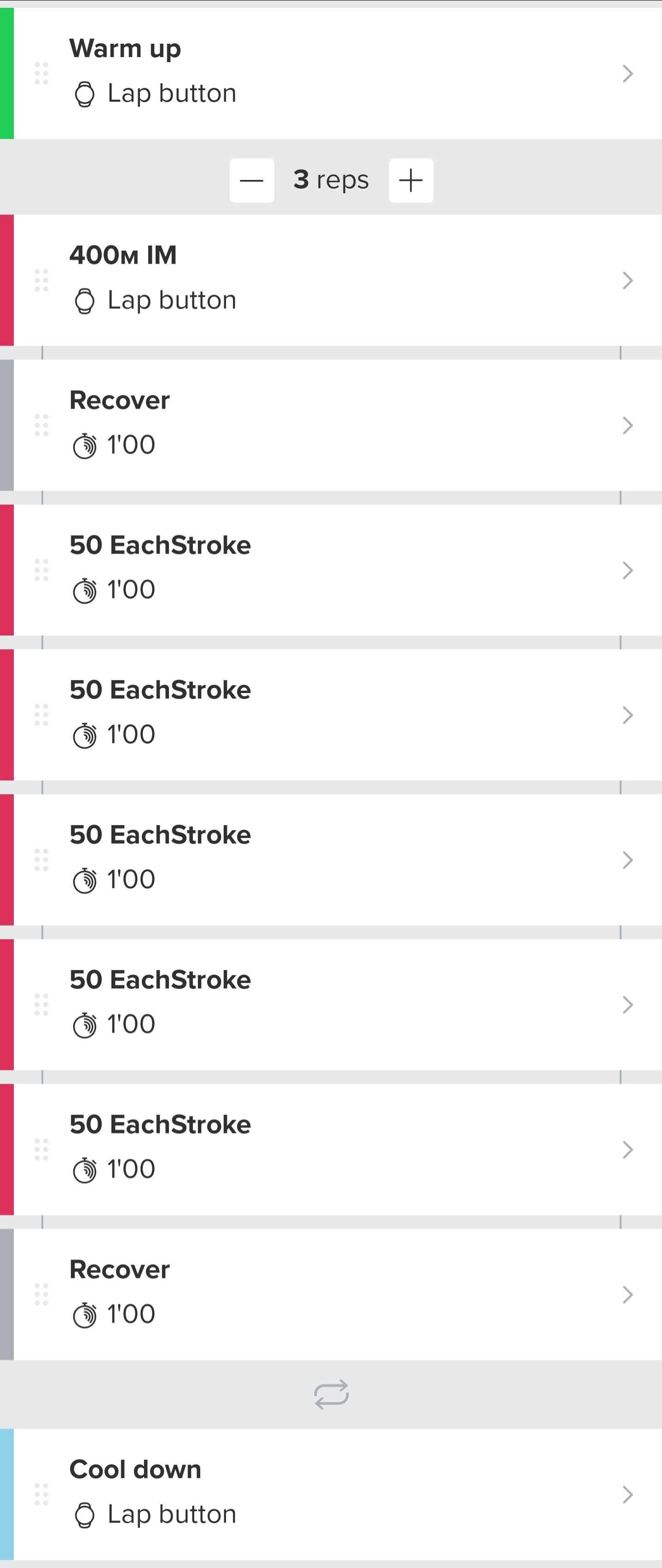

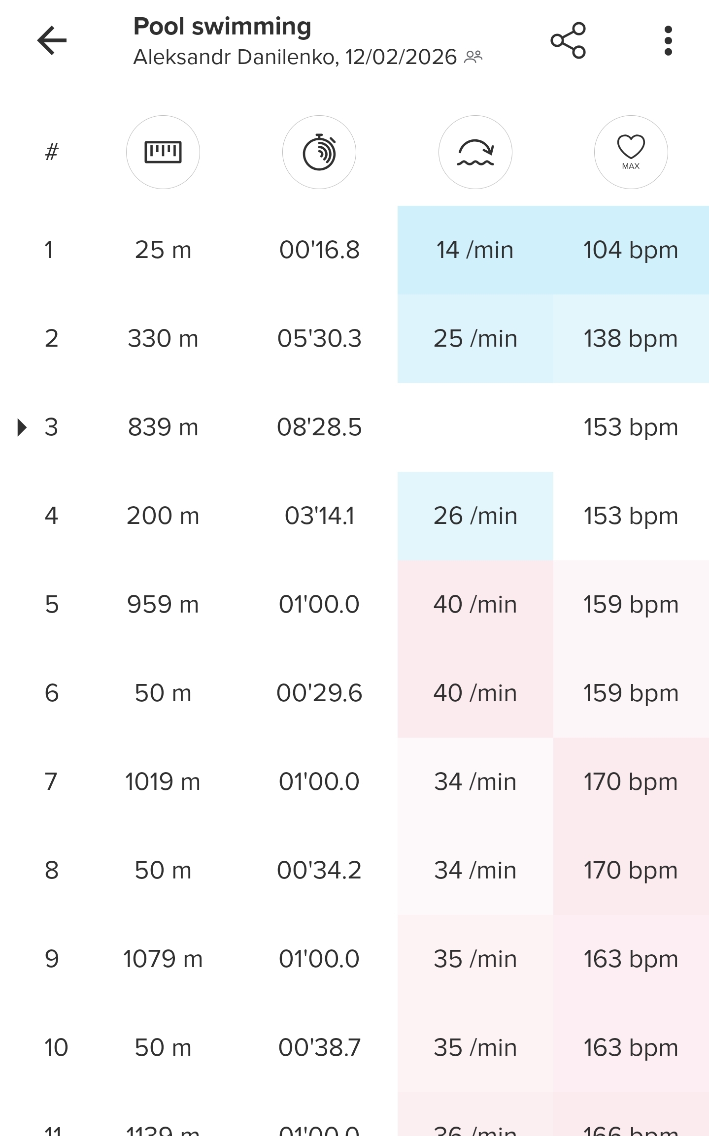

      @Manuel-Extreme I set it as “Any” sport, when creating workout plan.
      It used to work for 2 years in swimming Im using Suunto watch.

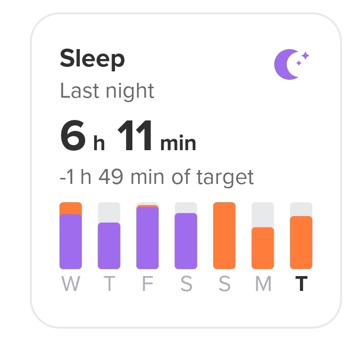

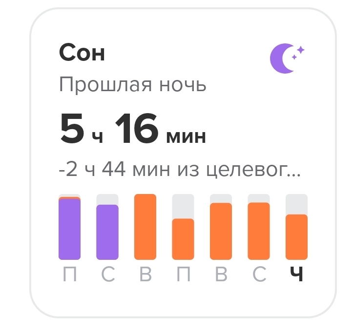

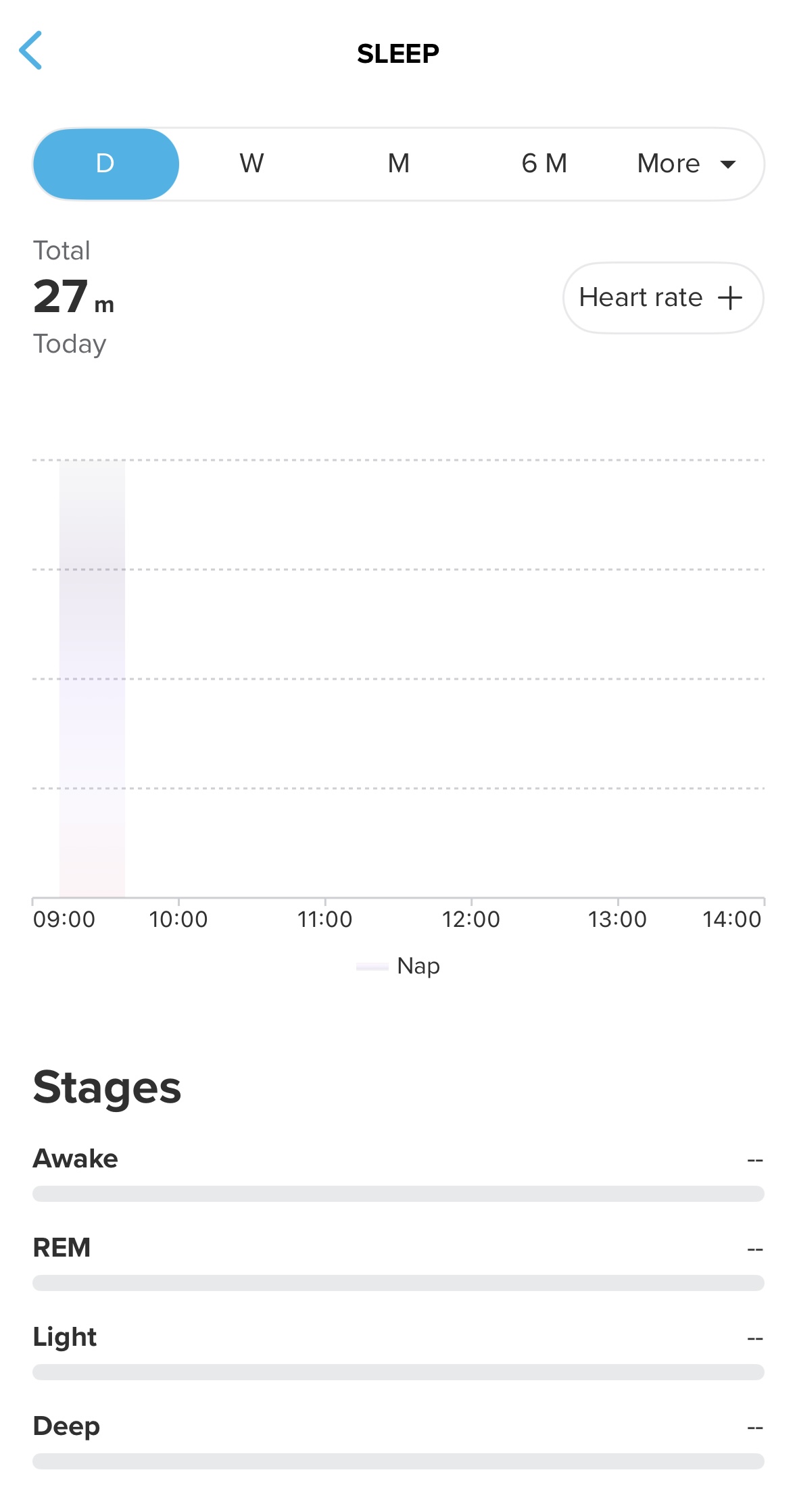

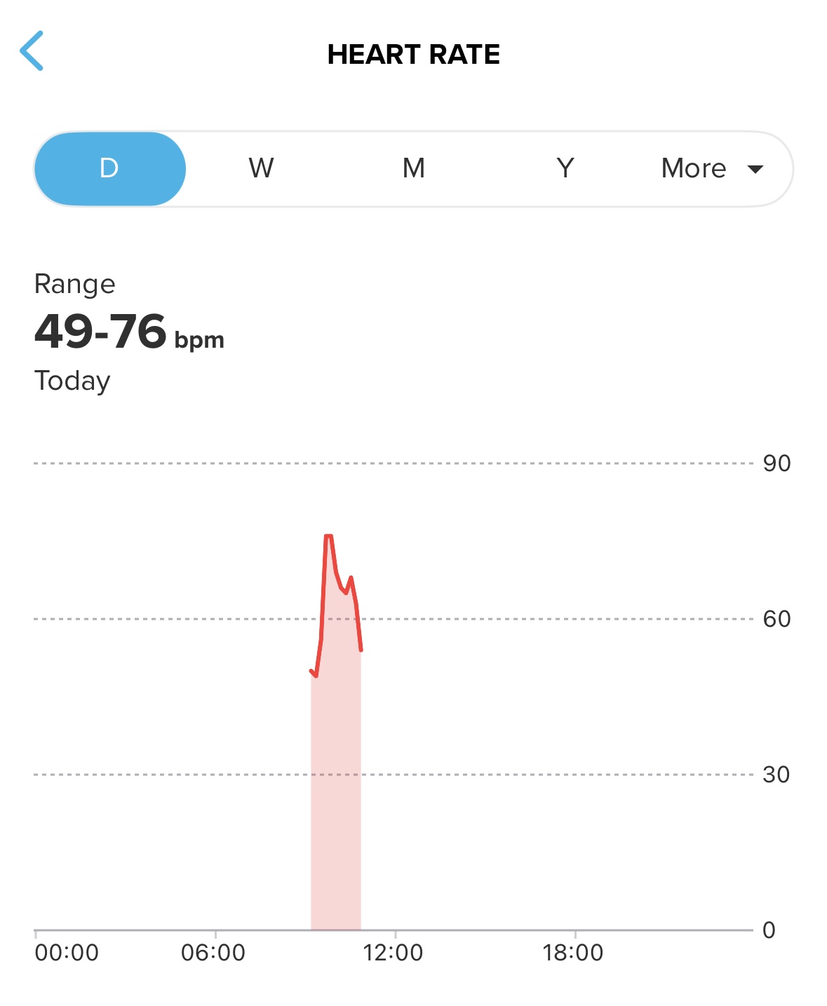

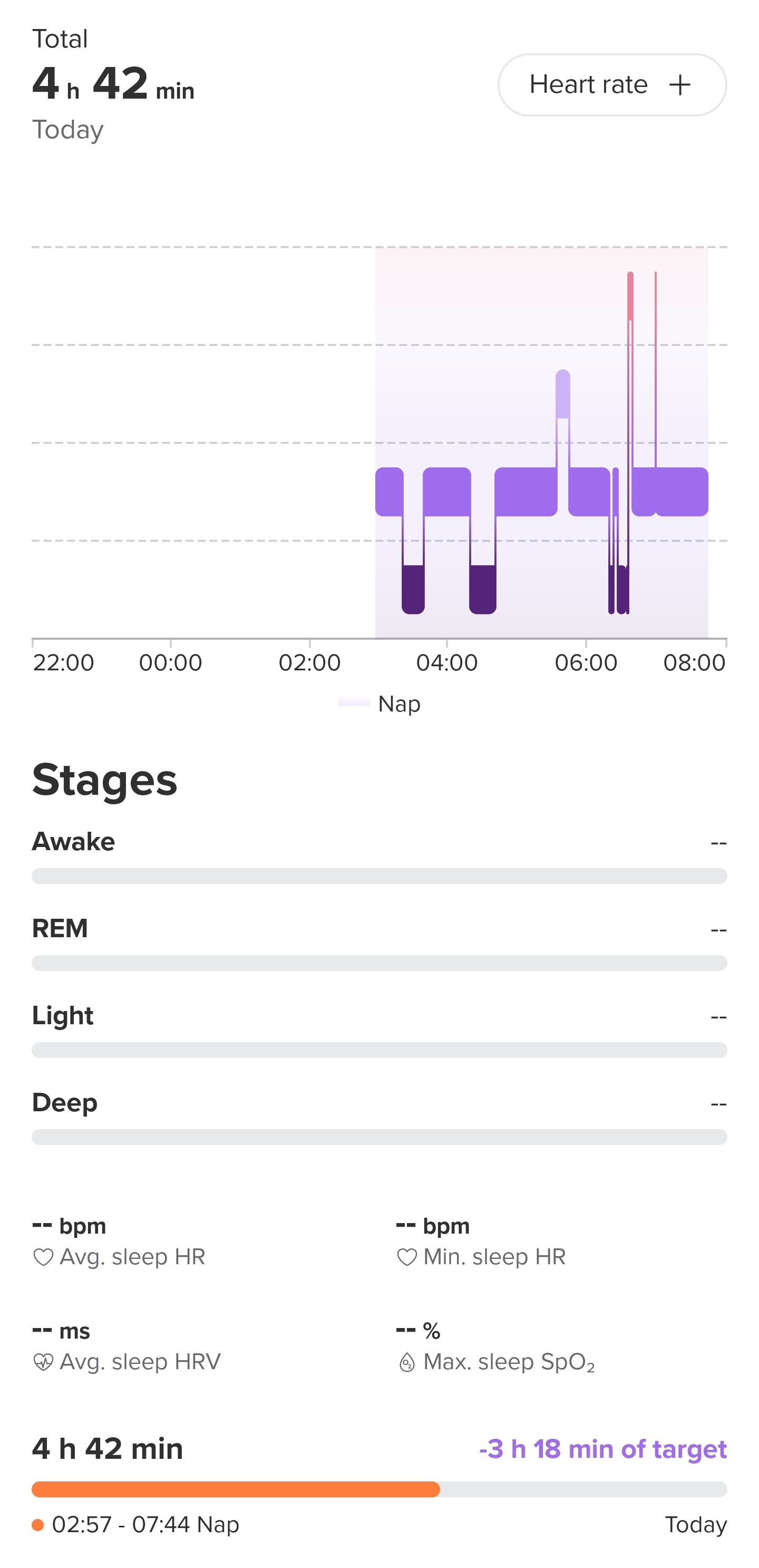

        Still detects my sleep as napping 😅
        Going to do hard reset. Soft reset didn’t help 🫤
        Update 1:
        Hard reset didn’t help:
        Update 2:
        Unlike hard reset, soft reset helped:

                                OutdoorMan Silver Members

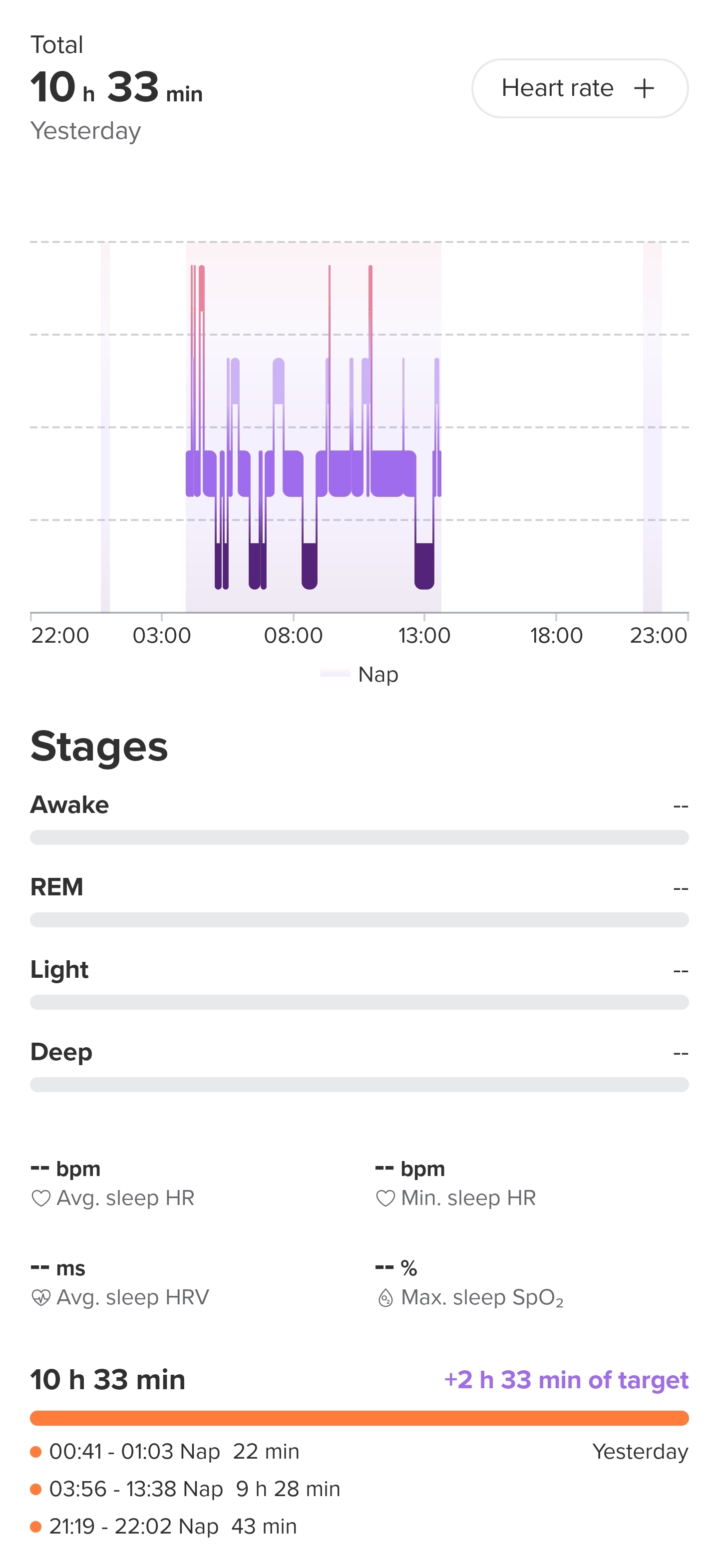

                                Race S, no issues until the latest hotfix. Now issues with sleep detection. There is also no data on the watch. Should I open a separate thread?
                                  2b2bff Silver Members @OutdoorMan
                                  @OutdoorMan no need to open a new thread. It is already known to Suunto, it seems… https://forum.suunto.com/post/185192
                                    OutdoorMan Silver Members @2b2bff
                                    @2b2bff I see, thanks. Let’s wait then…
