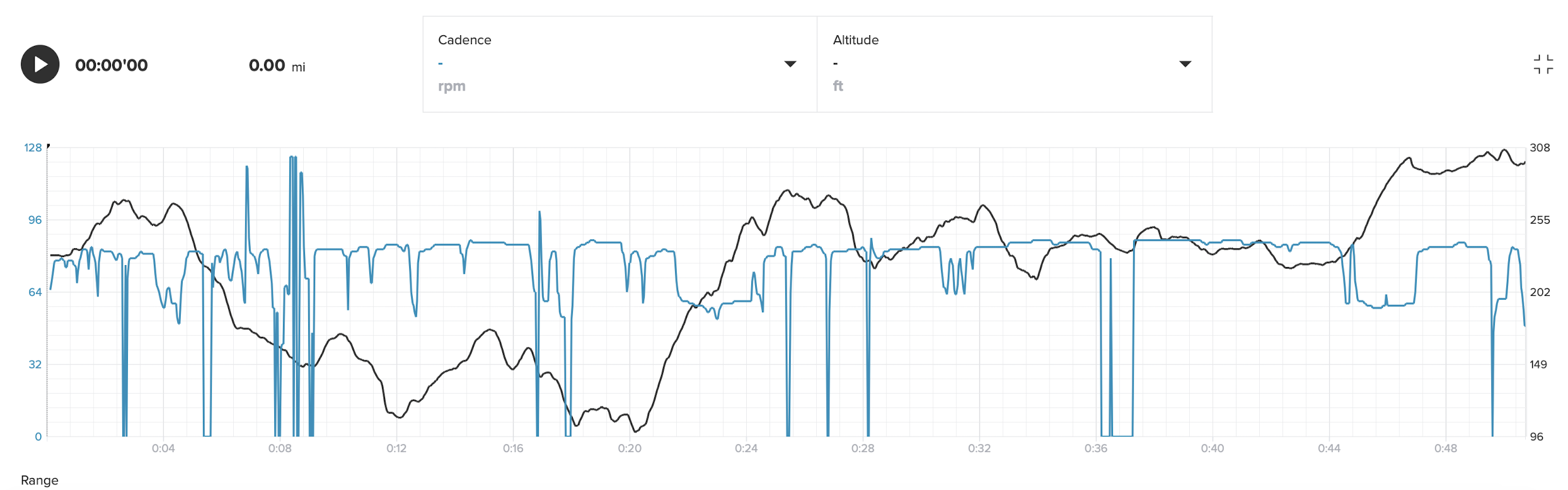

                Here is a bit more analysis related to my original post at the top.
                1. Here is the entire altitude profile overlayed with cadence to make it easier to identify points on the graph (this was a run with dog so a lot of stops)

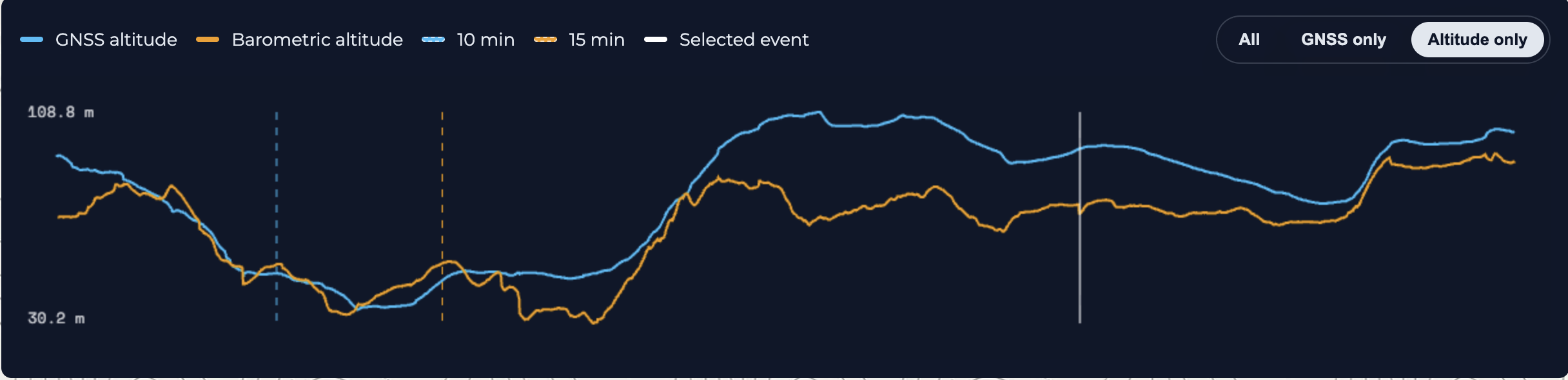

                2. GNSS altitude vs. barometric altitude from https://smlanal.szmigiel.design/ tool based on JSON data exported from Suunto App:

                A few things to notice. For the most part, these are paved suburban streets so there are no sharp changes in altitude. The Suunto altitude graph looks way too “noisy”. Strava corrected altitude looks much more realistic to me based on my knowledge of this area where I run almost every day. The GNSS altitude looks more realistic too.
                Looking at how noisy the barometric altitude is makes me realize that perhaps the barometer port got dirty and needs cleaning. I recall a having a similar issue once in the past and it got better after cleaning. Could that be the case? I’ll give that a try.

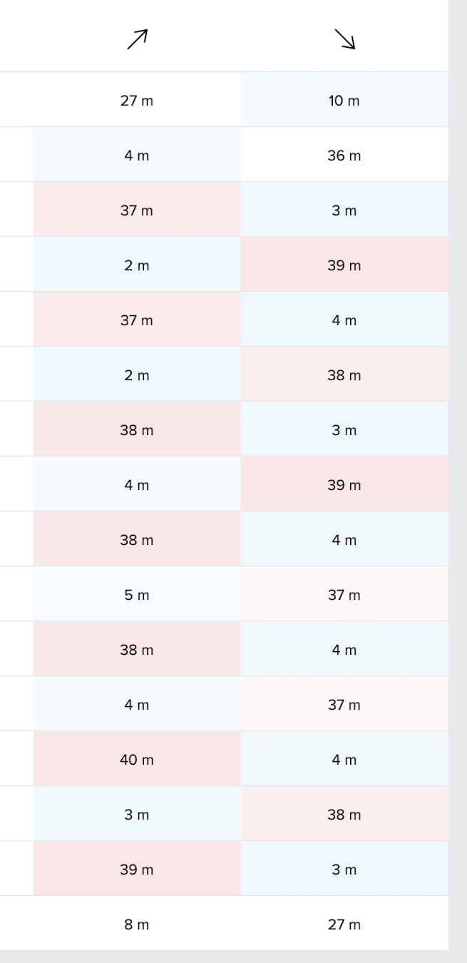

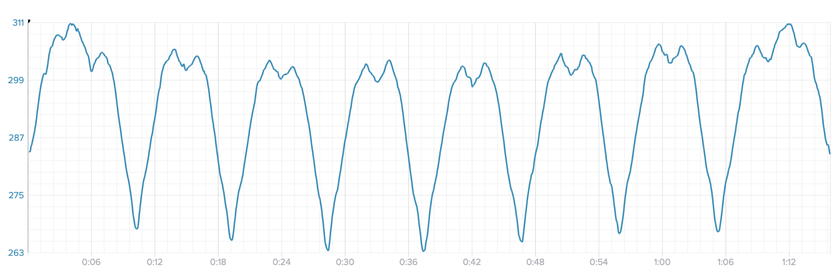

                      On a positive note, I have documented several instances where the decreased threshold has resulted in a more accurate addition of altitude gain/loss. A regular hill repeat route of mine has an interesting profile. The turnaround point is not at the apex of the hill, but another ~150m farther with a very slight downhill with 3-4m vertical loss. So the profile (pictured below) has a little dimple at the tops instead of looking like a clean up-and-down. Previous software would rarely register those little dips, but the new one correctly captures it as shown by the numbers highlighted in blue.
                      I’m glad they made the adjustment to the threshold since I recall we both complained about it in the past, but judging by yours and @jjpaz experiences on more flat terrain, it looks like it still needs a little work.
