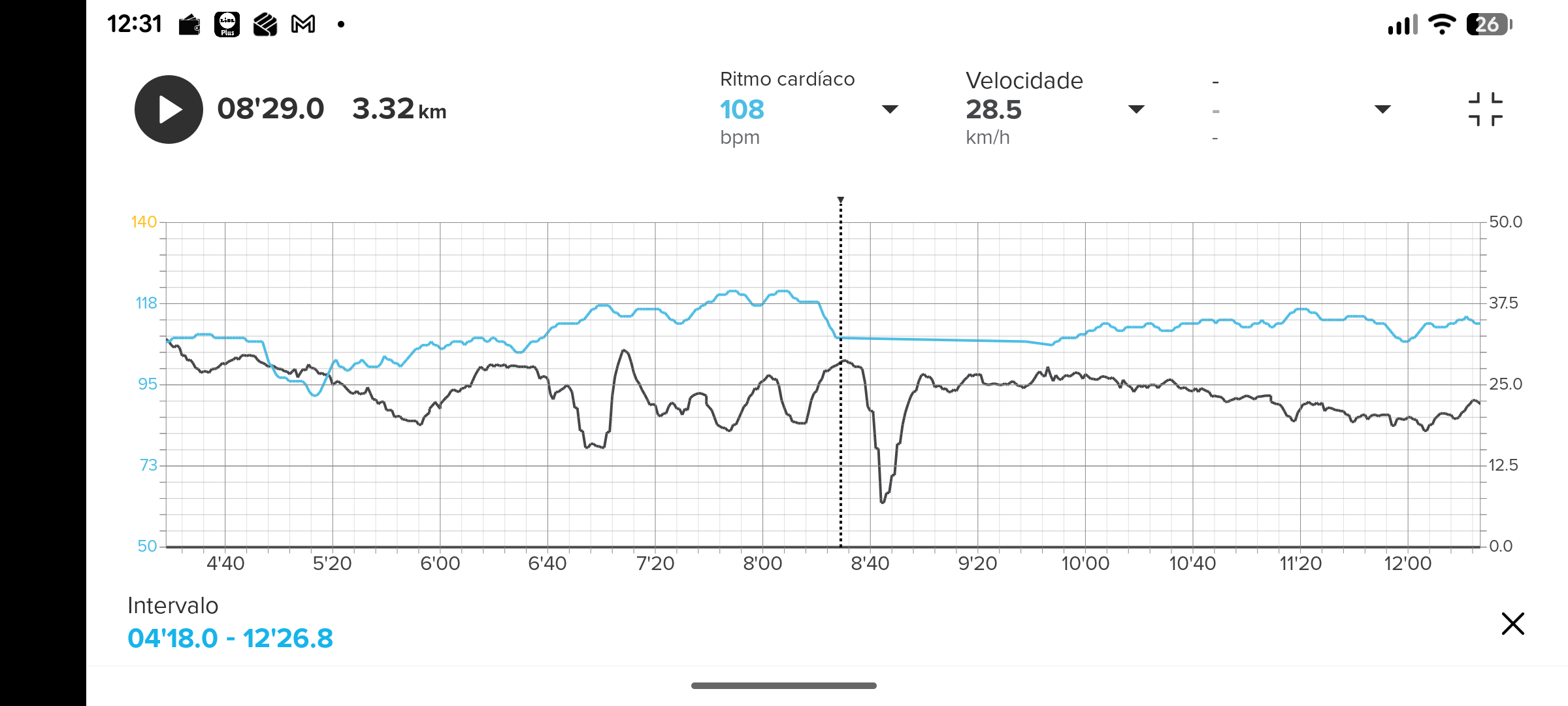

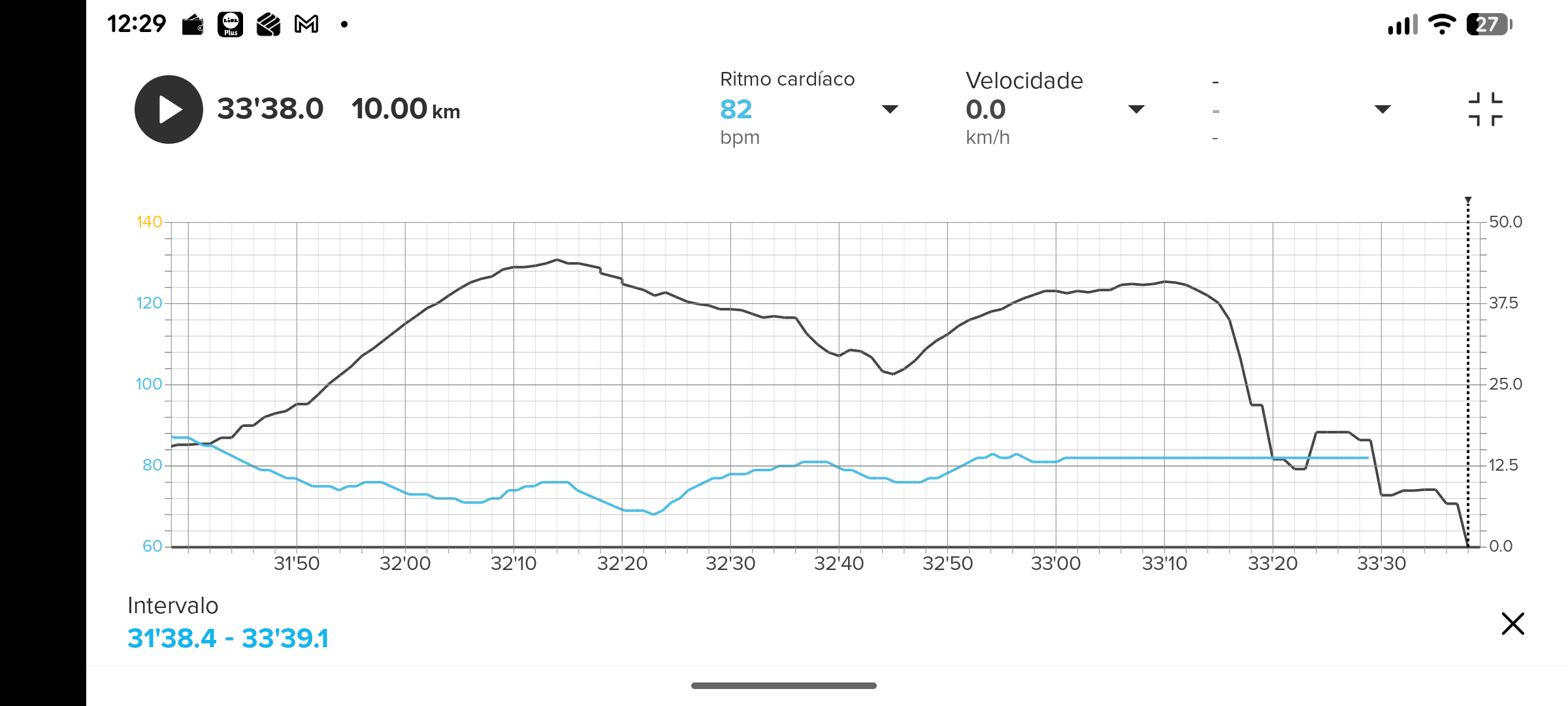

                  Update from my latest training. The Suunto Chest Strap looses connection and doesn’t sync afterwards event tough I wait 3 minutes for the rest HR. It happens mostly at the end of the training but can also happen in the middle.
                  Screenshot_20260302-122944.png Screenshot_20260302-123021.png Screenshot_20260302-123141.png

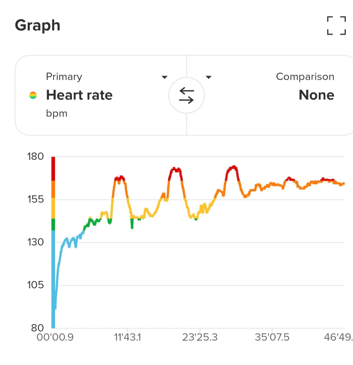

                      The HR graph normally looks absolutely fine as expected but i am usually given a different max heart rate in the run summary.
                      Screenshot_2026-02-22-18-21-23-970_com.stt.android.suunto.jpg Screenshot_2026-02-22-18-21-44-133_com.stt.android.suunto.jpg
                      This example is from a run where i chucked in three sprints and as the graph shows my heart rate doesn’t go above 180 which is inline with what i expect for the effort. With a chest strap the Heart rate summary seems to always be different to the graph.
                      What’s odd is when using a chest strap, which works perfectly with my other watches, i get this max heart rate discrepancy and the synced data in Strava will show a mix of the correct max heart rate which is reflected in the Suunto produced graph or it will show what i’m sure is the incorrect max heart figure as produced in the Suunto app summary.
                      There seems to be something going on here with the relationship between watch and external sensors and how the data is all displayed within the app.

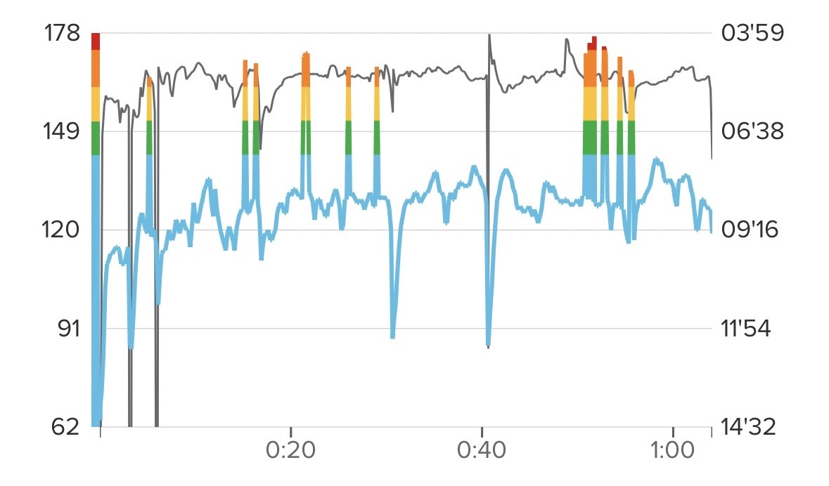

                          Regarding 2.: with the external sensor (never an issue with Apple Watch), random spikes here and there in any (literally) run. For example:

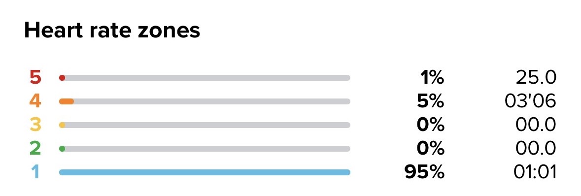

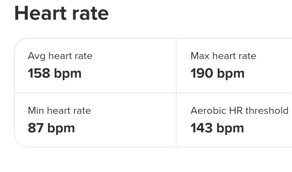

                          In addition, the very same run, with the following heart rate zone break down
                          …has been labeled as “VO2max”, and I did change my “HR and Intensity Zones” settings. Again, this mislabeling happened all the times. This is not acceptable.
                          Without the external monitor, the data are simply unreliable and from time to time, the hr simply jumps at 180bpm at stays there for minutes although the effort is low without any doubt.

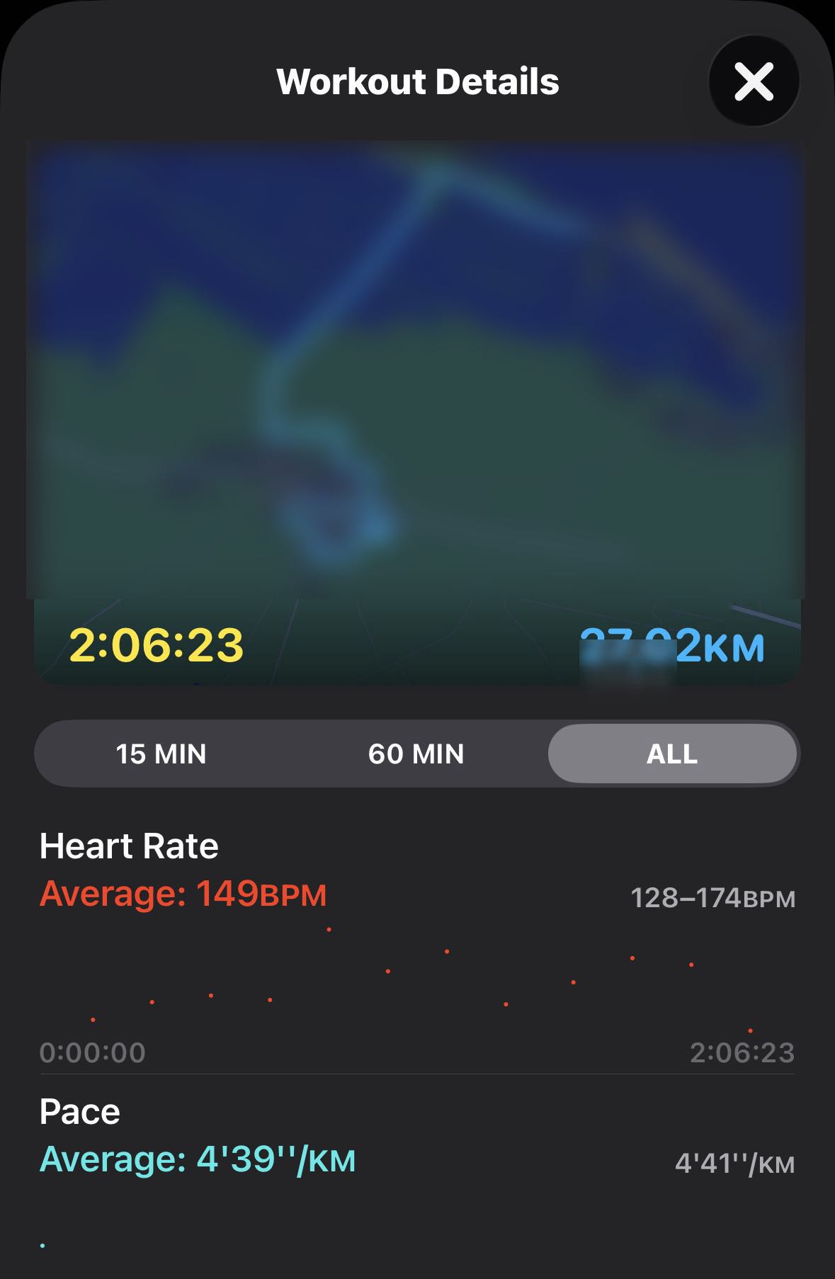

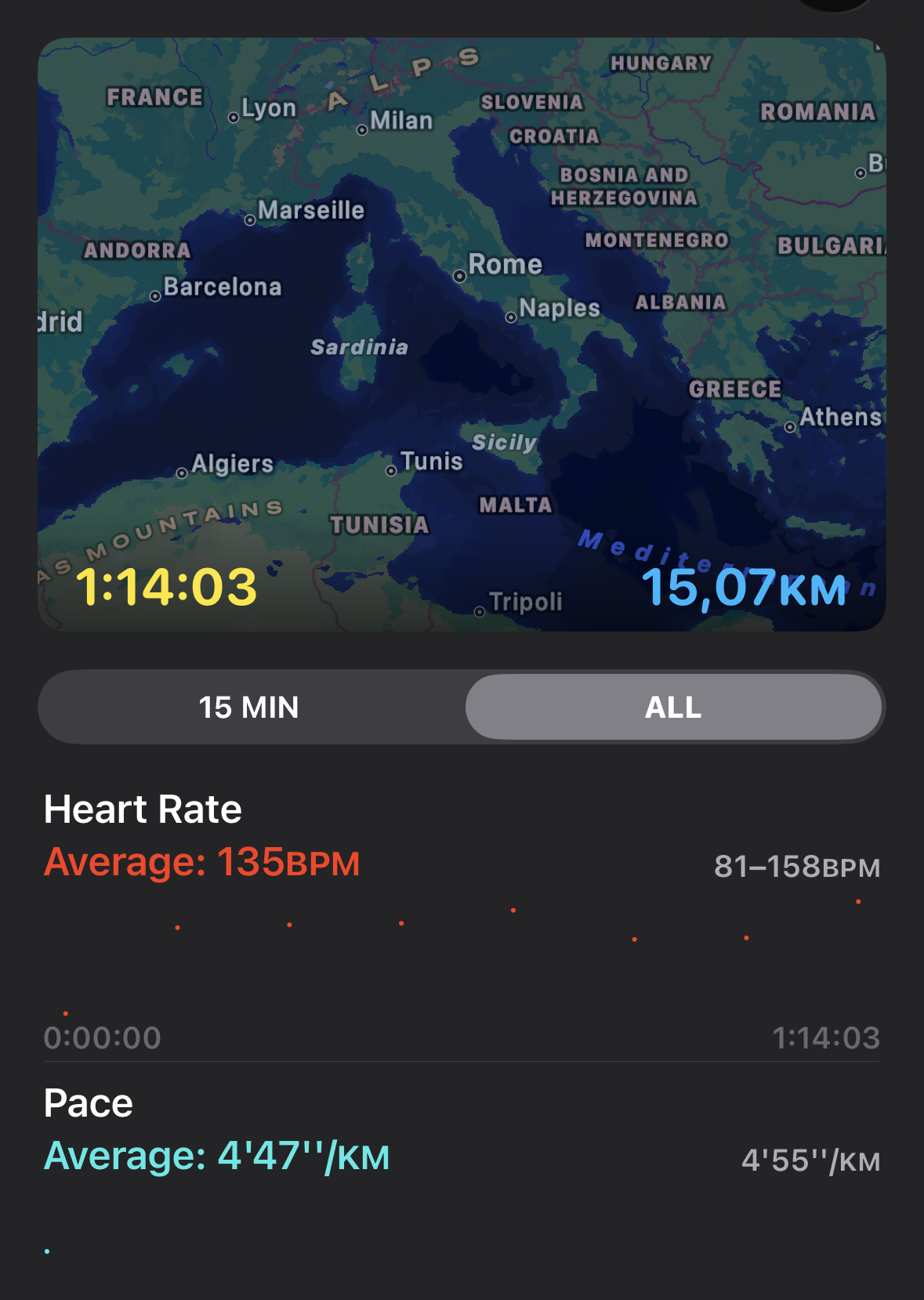

                          GPS data? Fine on Strava, no way to sync it entirely and correctly on iPhone Fitness app.
                          HR data? Fine on Strava again, and again no way to sync it on iPhone Fitness app. Below an example of what I see…always…
                          To fix this, I also contacted Suunto’s assistance and, besides the uninstall-reinstall the app, no real solution or even idea of what’s going on.

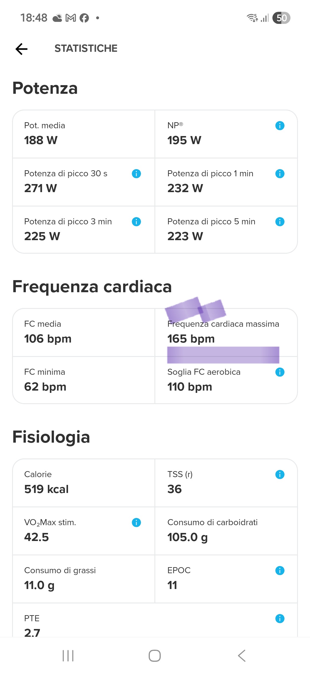

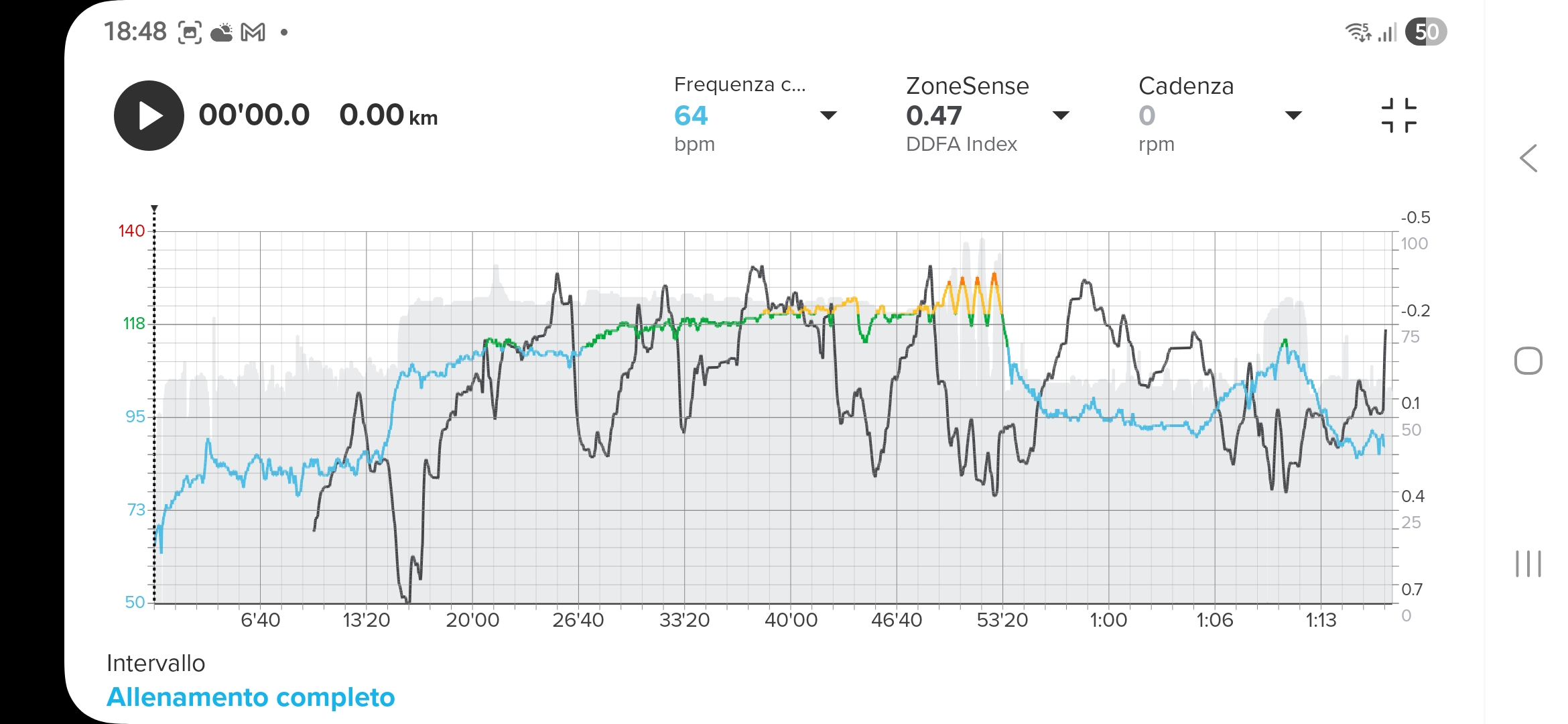

                          • G Online
                            Giorgio60
                            Anche io con il Suunto Run e fascia cardio Polar H10 (ma anche senza) ho avuto un simile scherzo per quanto riguarda la misurazione HR.Screenshot_20260320_184855_Suunto.jpg Screenshot_20260320_184824_Suunto.jpg
                            In pratica mi segnava un HR Max di 165 BPM mentre sul grafico non si menziona minimamente. Spero in un veloce aggiornamento.
