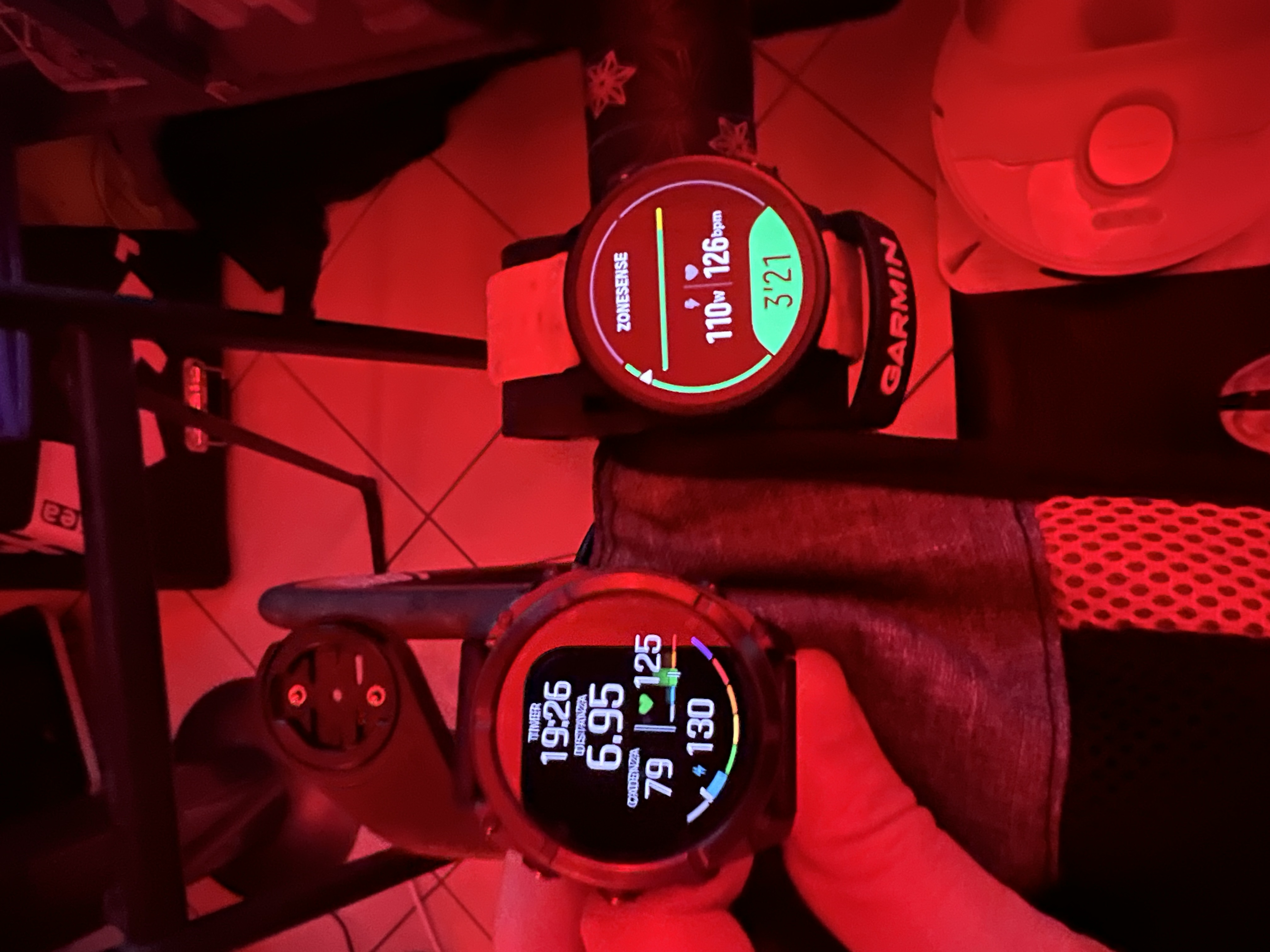

              I use the Suunto Vertical 2 like this: I monitor ZoneSense, while the Garmin handles the rest.
