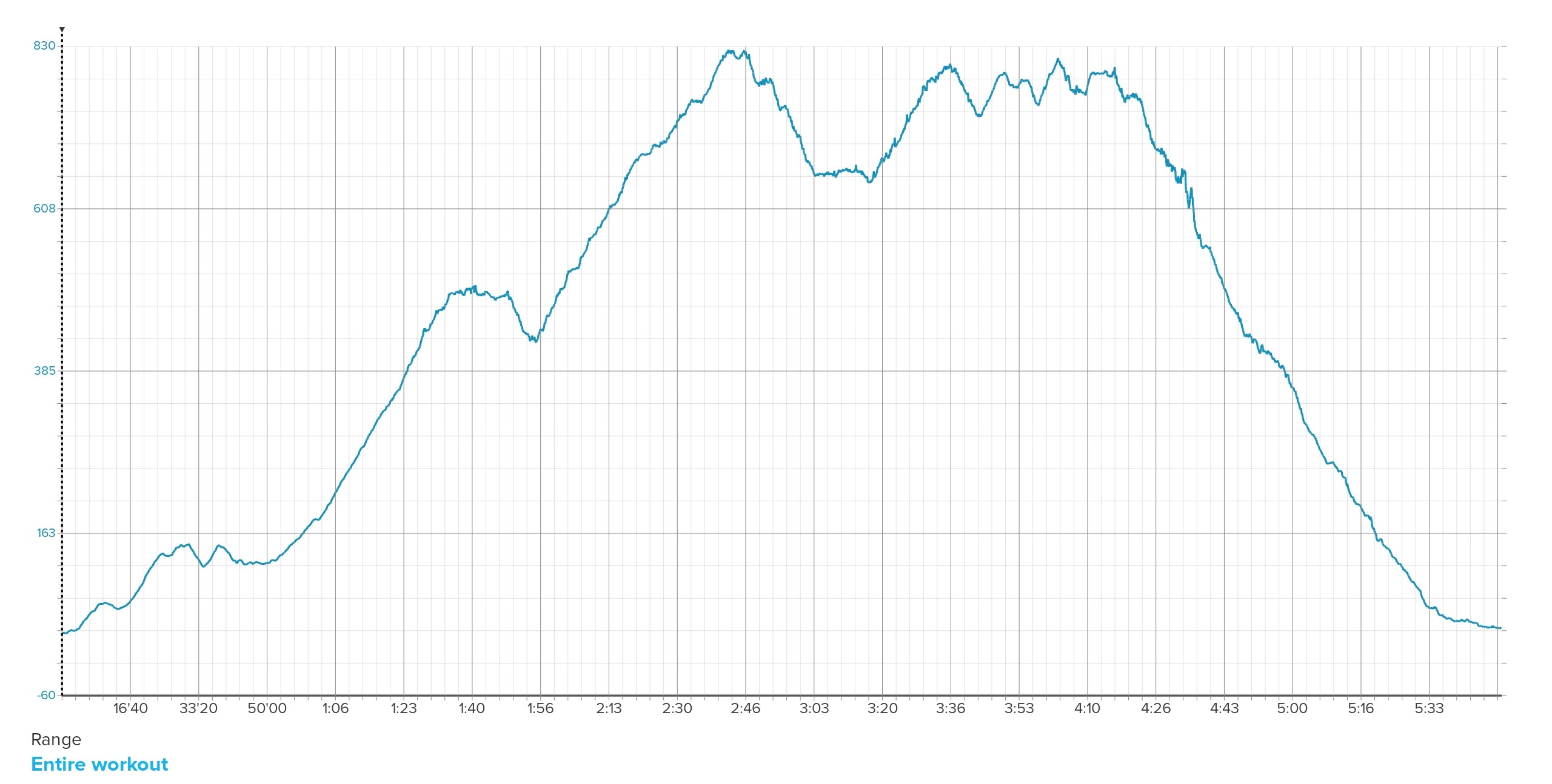

      From software update announcement:
      • Initial threshold reduced to 2 m (previously 3 m)
      • Meter-by-meter measurement after the initial threshold
      • New air/water filtering (wind, rain, humidity, friction)
      • Elimination of false ascent and descent spikes
      • Improved altimeter accuracy and stability
      In very strong winds, the problem still persists, but the error is much smaller. In this case, it was about 250m too high. According to the Suunto Vertical, 1185m – it should be around 900-950m.
      I’m generally satisfied; previously, my ascent totals were often over 1000m higher than the actual total. But there’s still room for improvement.
      It can be clearly visible at the upper part of the mountain, where the wind was definitely the strongest, that the graph is very jagged and hence the inflated results.

          Today I had the opportunity to test it more thoroughly in strong winds. The problem persists, and its scale is still significant. Suunto reports 2,118 meters of ascent, instead of the actual about 1,500 meters.
          I’m not convinced by the constant responses that it’s impossible to calculate accurately in windy conditions, because the Garmin Fenix ​​8, in identical conditions, indicated 1,600 meters, which is already acceptable accuracy.

                @wakarimasen This has nothing to do with measuring altitude itself — that’s never been a problem with Suunto.
                Look at the top part of the altitude graph, and you’ll see a jagged line with multiple little, sharp peaks (caused by strong wind) that add up, giving absurd ascent and descent totals.
                It’s a bit better since the last update, but the results are still absurd and essentially useless for any analysis.
