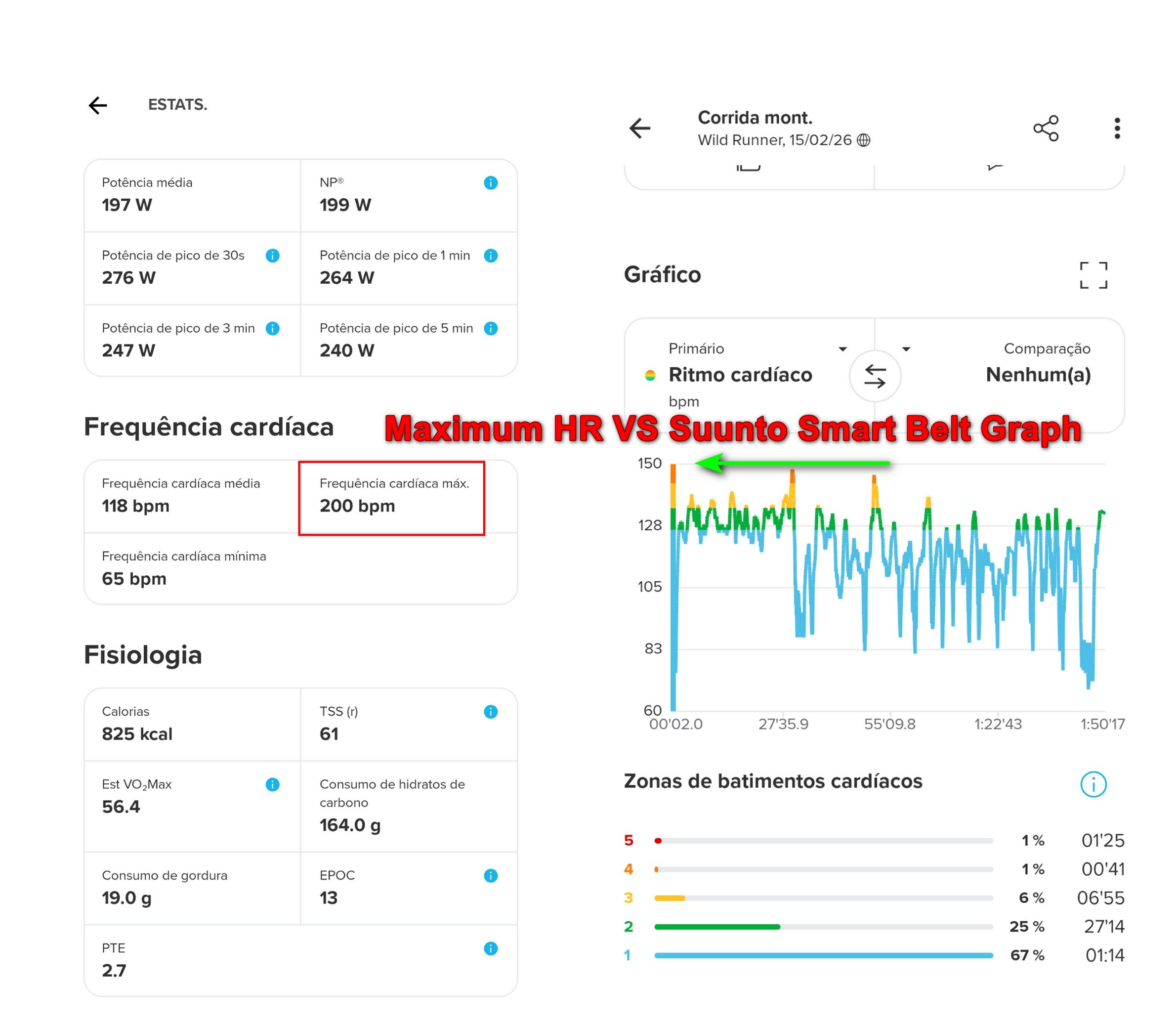

      HR Spikes: The sensor still gives excessively high readings during the first 10–15 minutes of activity.
      Data Mismatch: The app shows a maximum HR peak (likely from the OHR) that is not reflected in the graph (which should be using Suunto Belt data).

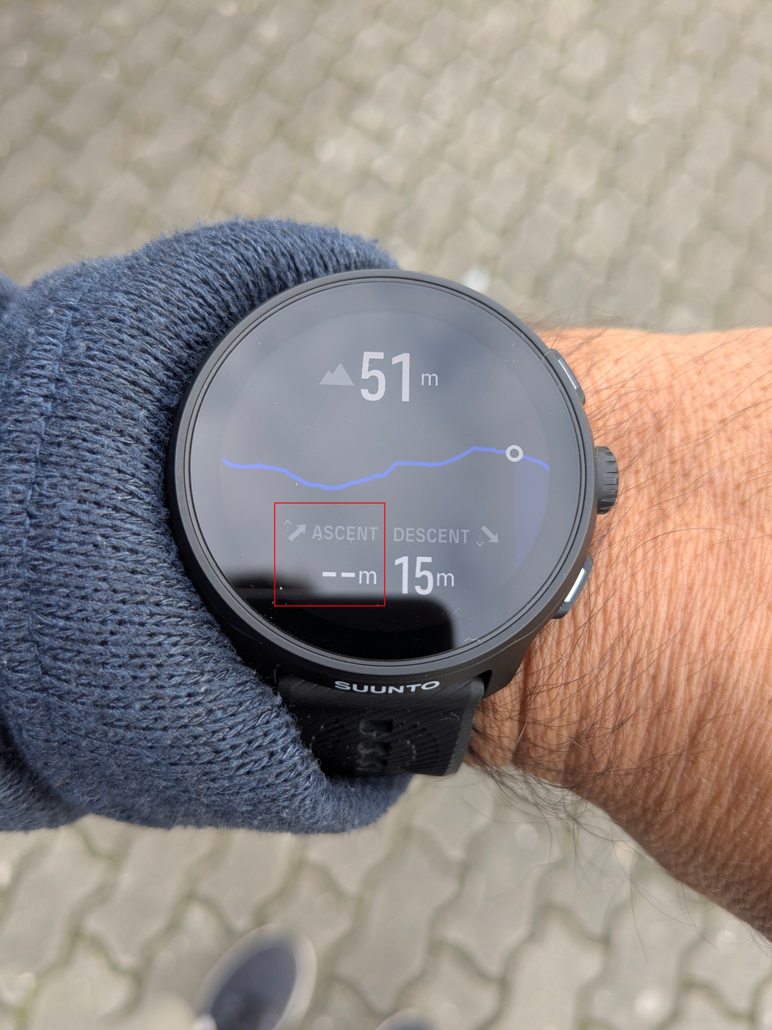

      Remaining Ascent: This field remains blank when following a course planned via the Suunto App, regardless of the sport mode used.

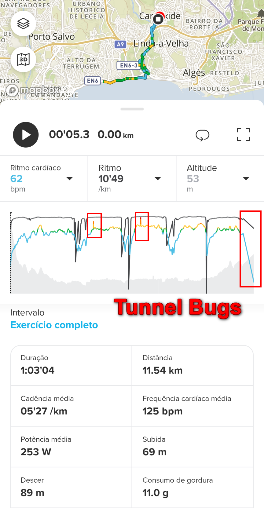

      System Crashes: I experienced three crashes when losing GPS signal in tunnels. On one occasion, the watch restarted and stopped recording; on the other two, it ignored the HRM belt and recorded inaccurate HR data (approx. 200 bpm) from the OHR.
