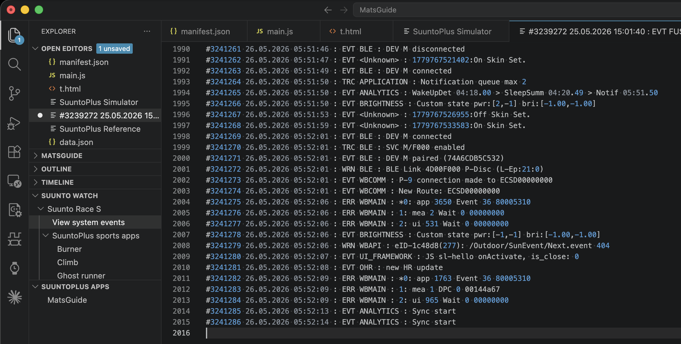

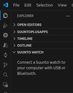

                  • surfboomerangS Online
                    surfboomerang @matram
                    @matram This sounds way too familiar. I went through the same while developing my apps.
                    Frustratiing at some point. Especially because it takes a lot of steps to test it on the watch every time.
                    If the watch is connected to your pc, there is an option to look at the logs in the SuuntoPlus extension in VS Code. You can find it in “Explorer -> Suunto Watch”
                    OnePlus Nord 4
