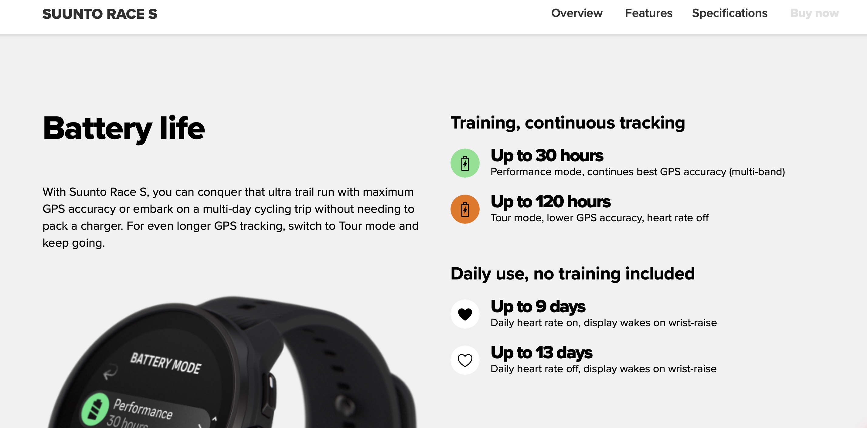

      How much battery life do you get? This is what is claimed on the website.
      I have a setup such as “Daily heart rate off, display wakes on wrist-raise”, yet I get 7 days, hardly forget even 10 days.
        during activity:
        ~3.2%/h, multi-band, bt enabled for chest strap H10, rise to wake, 1 S+
        ~5.2%/h, multi-band, bt enabled for chest strap H10, rise to wake, using only map view with bottom field enabled
        watch mode:
        ~8/9%/day, sleep enabled, 24/7 HR, HRV enabled, SPO2 disabled, notifications disabled, display always off, wifi & discovery disabled.
        ymmv

          @snow 5, just as a watch, it hasn’t been working for 7 days; generally, 5-6 days max. This all started after the firmware upgrade. Otherwise, it used to give 10+ days on a charge as a watch, and with 10+ hours of GPS-only (no heart rate), it used to give me 7 days of battery easily. (Don’t have Bluetooth on for any notifications)
          I have noticed that 2 to 3 hours of GPS use drains 6-8% of the battery.
          I have already lost hope with Suunto on this matter.
